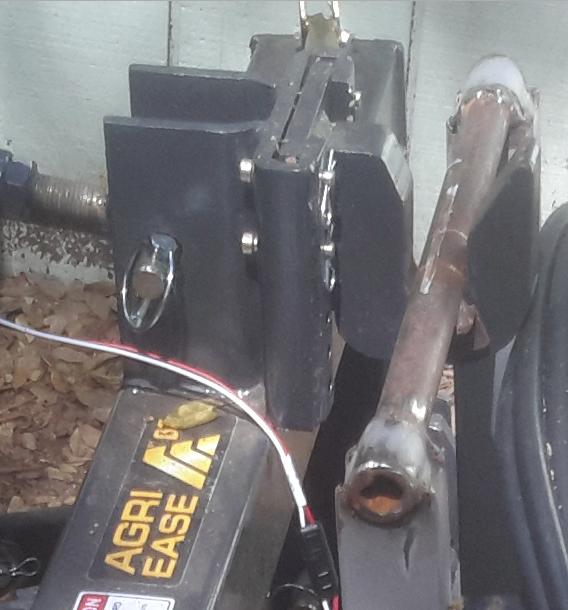

I think somewhere along the way here except in a few extreme cases, we have lost concept of how QH operates..... Answer me this scenario, you have standard CAT-X Quick Hitch and it has a welded permanent top hook that can not be moved/removed, how do you make your implement work with such a quick hitch, and in almost all cases you have to use hook.....
This scenario is brought forth because my QH hook mount system is wider than any of the "Y" shaped adapters....

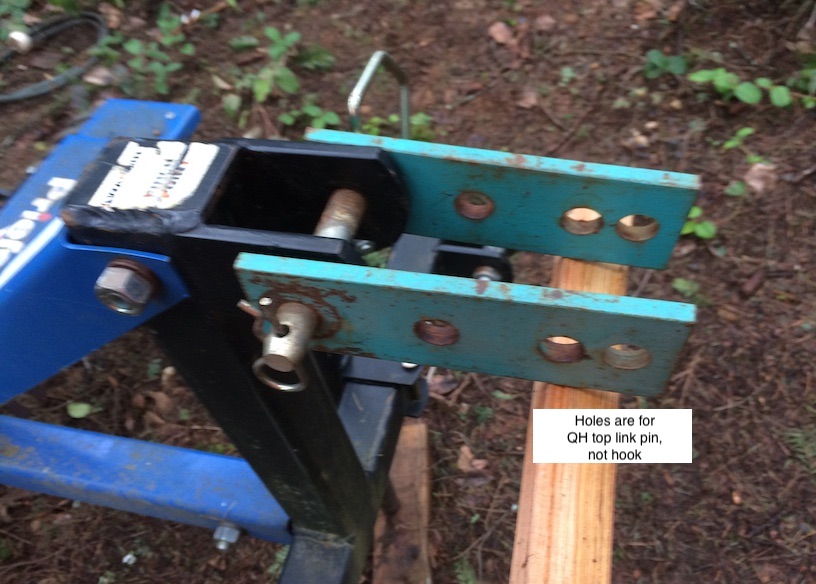

With your hook, you could remove it, turn it over, and install it up-side-down over a top link attachment point.
With a welded hook, you could make a side plate adapter like I did.

Scenario is one has to use hook... Using removable pin each implement change is not option.......

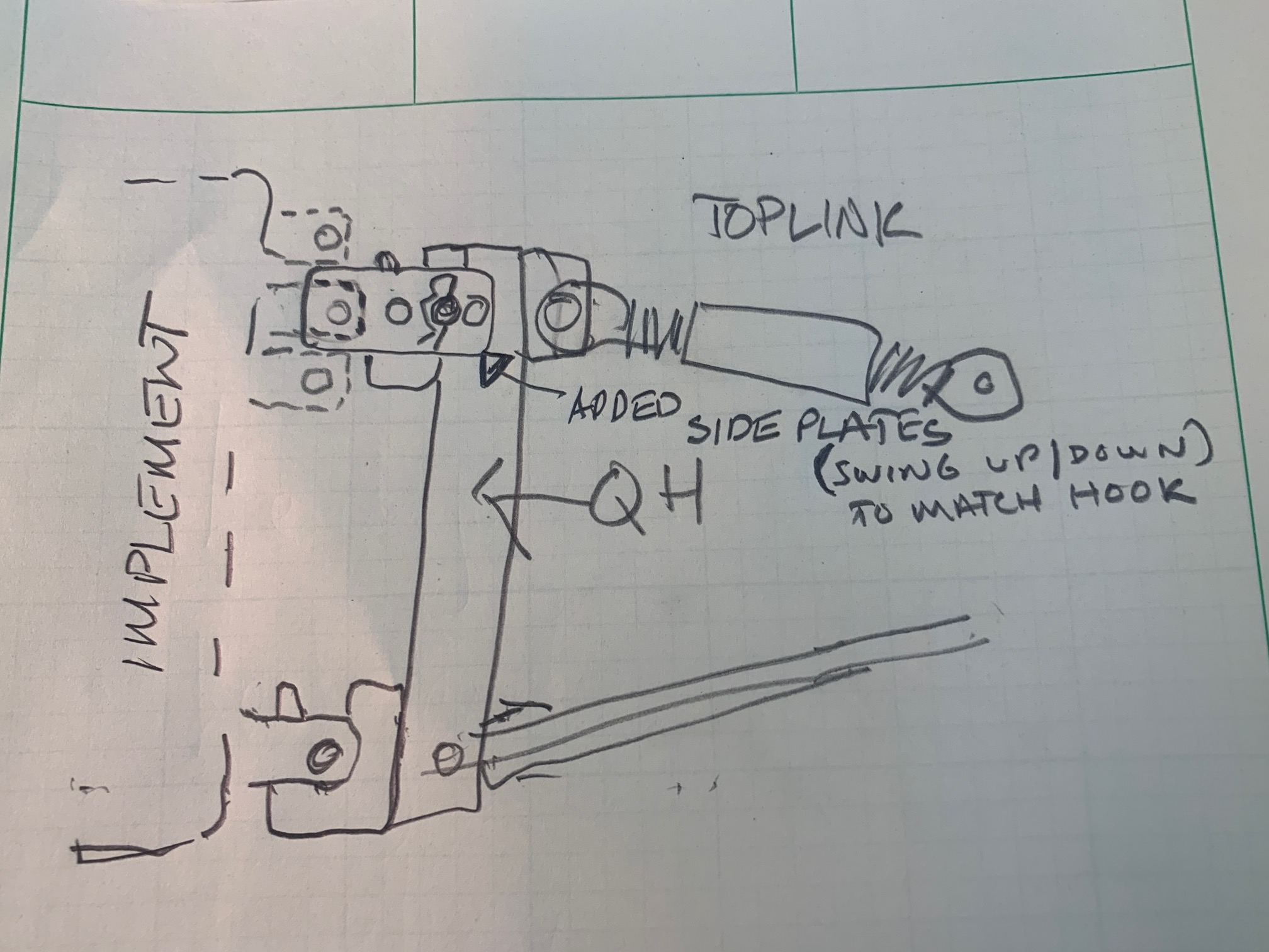

Make a 'side plate adapter' on the implement like Bruce has in post #25, except with a solid bushing at the forward end that the hook can engage.

Is this what he's talking about?
Yes except the 'added side plates' in your diagram are shown pinned to the holes where the hook is bolted/pinned in. I wouldn't pin it like that.
I'm thinking an adapter fabricated to be a semi-permanent addition to the implement, with a bushing at the front of the adapter that stays rigidly at a consistent height so the hook can find it.
