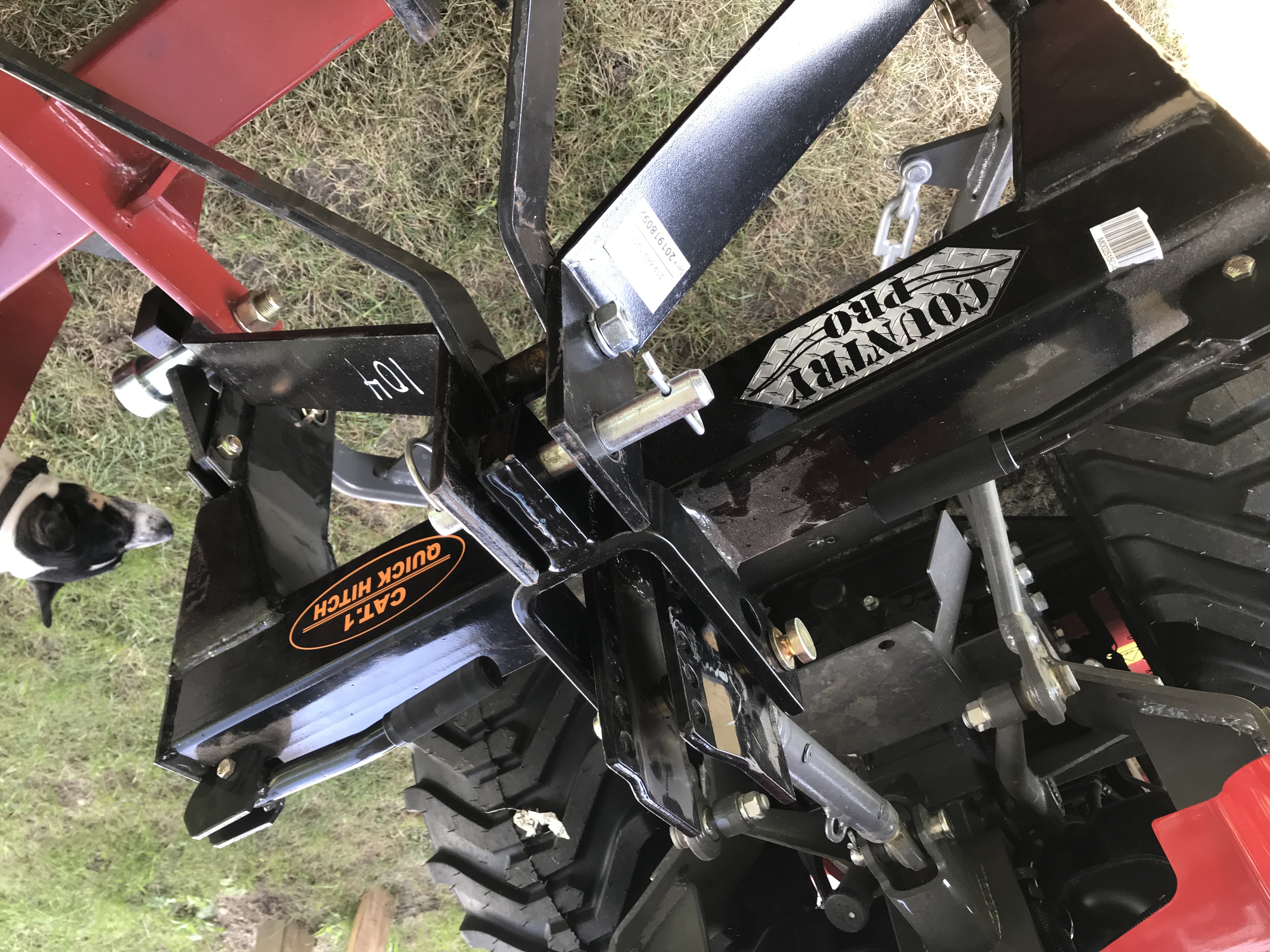

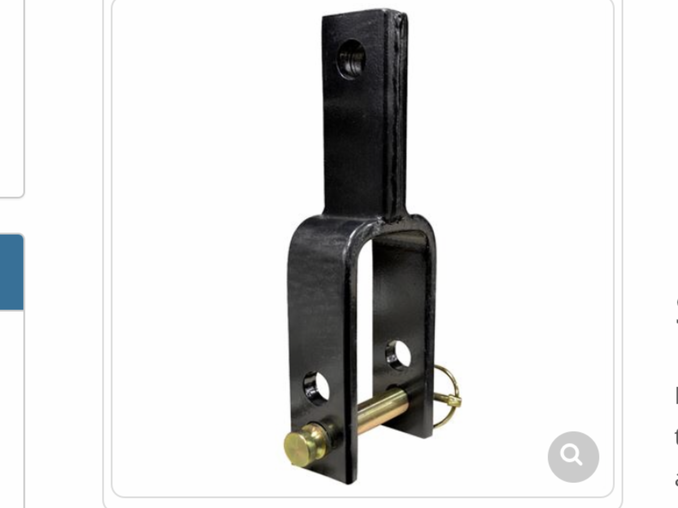

I have had to use this adapter on my Walco cat 1 box blade and back blade with the Country quick hitch from Mills Fleet Farm.

Here is how I had to set mine up for the box and back blade.
Jim.
   / Uhh....Category 1.5 three point hitch implements?
#14
Jim.
I've seen those on line. Never understood how/where they go. It looks like you still need to slide a pin in the top link of the implement, so that effectively makes it like Pats lower link quick hitch things.
So far, this seems like too much work to get right. I've found that by building 8x8 pads for my implements, and making sure they're level, it's not that big a deal. Perhaps not quite as quick as a QH, but close.

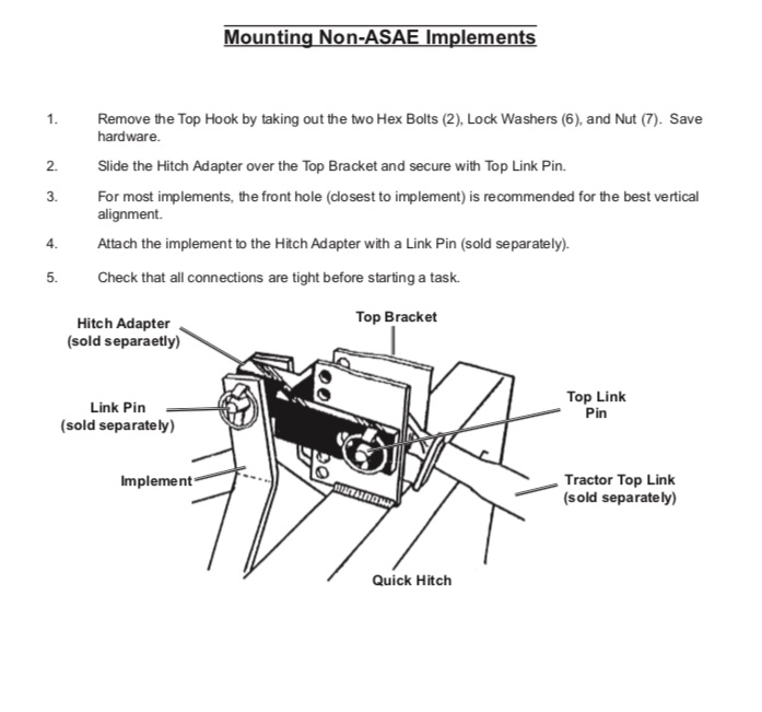

I don't think its being used correctly... MY interpretation is the wide area of adapter is for the 3PH "hook" and it was designed so that the adapter allowed the hook to clear cross bolt under the "top pin" of implement...... Would seem to me that any time you have to start pulling and pushing pins (specifically) it defeats the concept of 3PH....
This is how its used correctly...
Dale

This is the correct way to install the adapter.
Dale
This is not only the incorrect way to install it you shouldn't need the adapter for a box blade. They are most commonly used for mowers.
On my Agri Supply quick hitch I am able to leave the adapter pinned to the top link and I just pivot it forward when not in use.

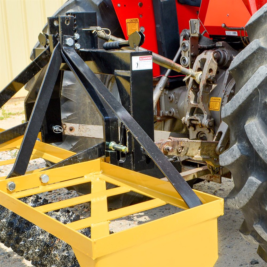

Dale
Remove the adapter, and lower the hook in the adjusting holes so it hooks to the bolt, you may need to remove the bolt and add a bushing to fit the hook opening. In the first pic you can see a bushing mounted over the bolt.IMG_1131.JPGIMG_1130.JPG
