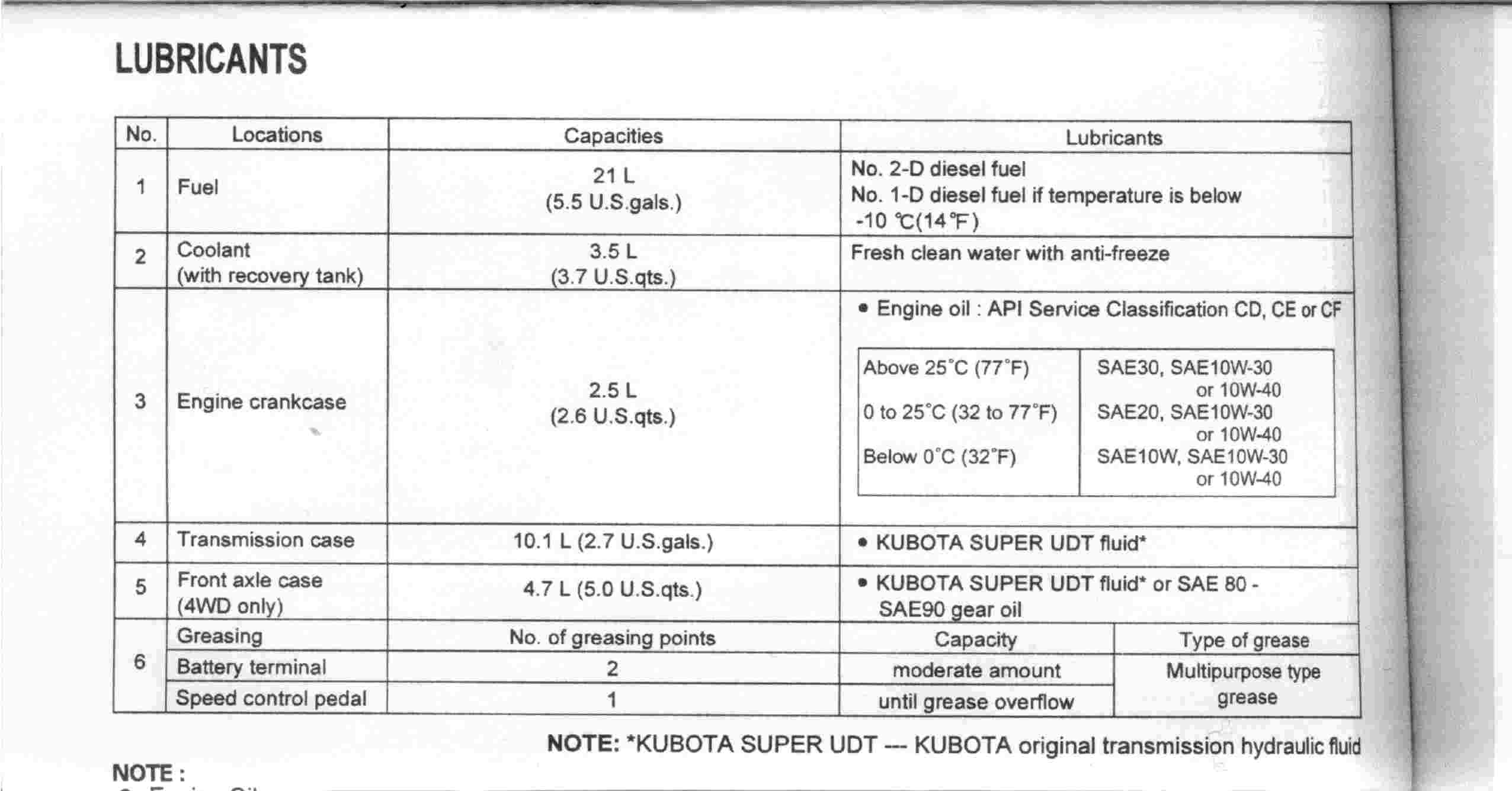

Our L3130 manual isn't clear on Super UDT or UDT; it states I can use either. My dealership said Super UDT and not UDT. Another dealership said something entirely different.
I called Kubota and the man said to use Super to keep the warranty good.
I'll probably use the Super because I don't want to void the warranty even if a compatible oil was made; which I'm told there is not (this is a Kubota exclusive).

I agree about the warranty issue. If the lube says SUDT equiv. I can't see how they could deny Warranty. But if you use a UDT equiv. when SUDT is spec then it may be muddy. I'm sure a good dealer would cover it.
I have not heard of not using SUDT causing any Warranty Issues. I have heard of customers complaining of performance issues under warranty, and not using a SUDT equiv. Now it gets real muddy.
Bottom line Fluid choice is up to the individual. The only risk of going this route is if a performance issue arises from using an off brand fluid, I would be prepared to forego the cost of a change back to SUDT to prove the performance issue.
It was easy for me I looked in the manual and purchased what was speced. If something goes wrong It isn't going to be MY problem.

You should check with Chevron as they indeed have a product that is equivalent to Super udt ,Someone is yanking Your chain. /forums/images/graemlins/grin.gif

Chevron's product is orange for better visibility.
Member Rat uses it.

Manual calls for SUDT and thats what comes as the OEM fill. I would think the UDT would be alright but personally I'd take it back and get the SUDT.
Theres been past posts w/folks noticing a difference in their tractors performance w/SUDT over UDT.
The primary reason for changing out the fluids at 50 hrs is to hopefully have all the breakin metal/aluminum/composit shavings and other solid matter drain out w/the fluid. During this 1st 50 hrs of operation, theres all kinds of wear & tear going on as moving parts seat & seal w/one another and a bad by-product of this breakin process is the solid hard deposits of the various surfaces that have worn away. If it weren't for these particles the fluid would be good for at least 100 hrs or so....
