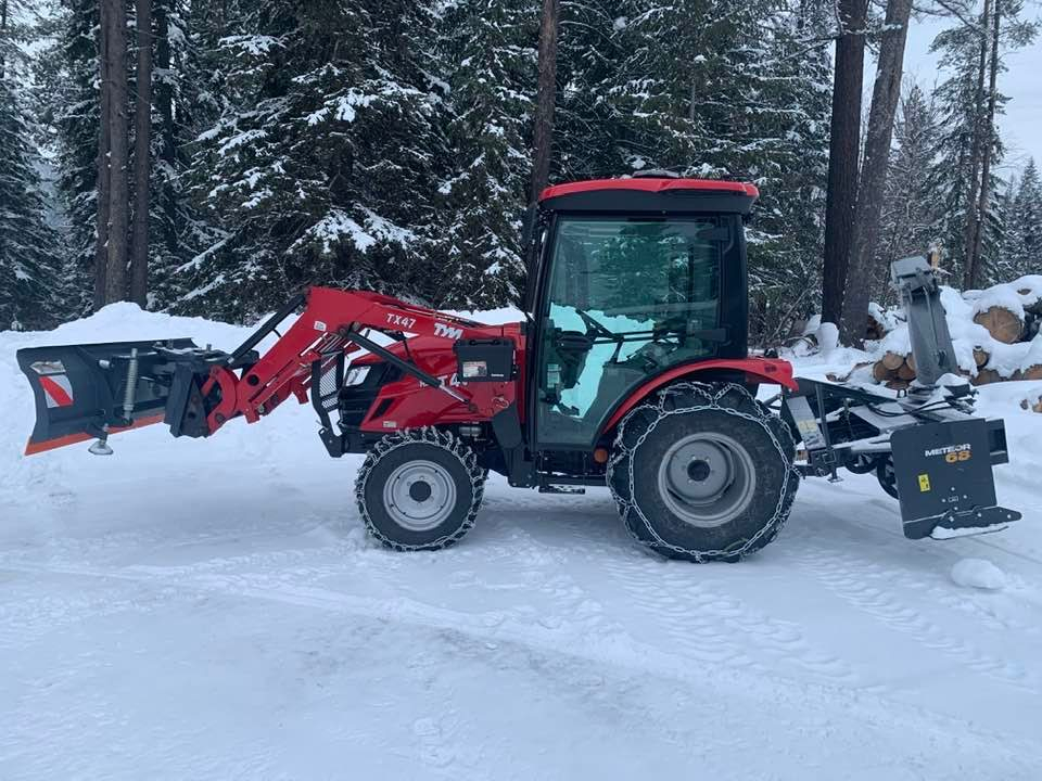

Well as an owner of a Cab T474HST, I'm totally satisfied with my purchase since July 1 2020. I have almost 190h on mine now, and I use it for heavy snow removal. I service it myself, I haven't needed much for OEM parts just yet! Just serviced fluids and filters after the manual, it is up to you what you value JD's resale value/dealer representation or 17k more in your pocket. it all depends on your localities and your own skills mechanically. The thing the T474 has going for it, it is probably IF not the only one in it's chassis size that uses a mechanical injection IDI for a Tier 4 engine? I have yet had a regen done. But I run it at 2k rpm and up to PTO speed at 2400 when working it.

Well as an owner of a Cab T474HST, I'm totally satisfied with my purchase since July 1 2020. I have almost 190h on mine now, and I use it for heavy snow removal. I service it myself, I haven't needed much for OEM parts just yet! Just serviced fluids and filters after the manual, it is up to you what you value JD's resale value/dealer representation or 17k more in your pocket. it all depends on your localities and your own skills mechanically. The thing the T474 has going for it, it is probably IF not the only one in it's chassis size that uses a mechanical injection IDI for a Tier 4 engine? I have yet had a regen done. But I run it at 2k rpm and up to PTO speed at 2400 when working it.View attachment 728245
I see you added those chains on for winter. easy to do? Hard to tell, but do you have the Industrial or Ag tires under those chains? Also, do you suggest getting ad-on implements from the dealer or did you find them elsewhere. I'm looking to add mower, planter/cultivator, and snow blower.

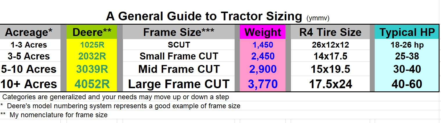

Am I the only one thinking that's a lot of tractor (size) for 10 acres and what sounds like typical homeowner type tasks?
It's kind of right on the bubble. Each time you go up weight, frame, and wheel size, performance improves significantly.

I was also thinking that sounds like a large tractor for homeowner use. It all depends on your uses, how much you want to lift. I own a JD so that’s what I like but that’s a big difference. If the TYM dealer seems well established and has been there a while I wouldn’t rule them out.
No you are not the only one thinking overkill.
