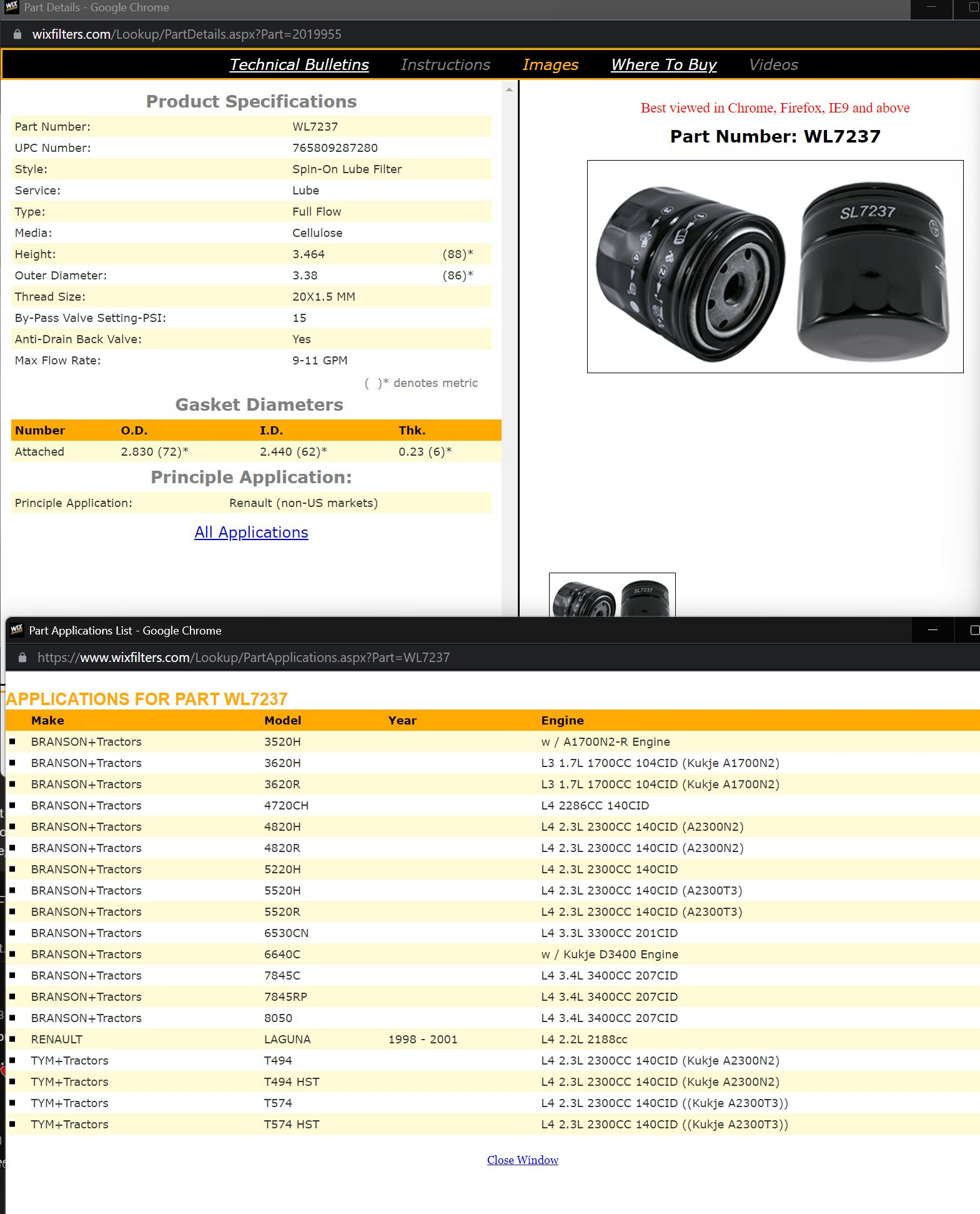

/ TYM T474 oil and filter change. #7
I realize this is an older post, but thought I would add a note regarding the oil filter. The engine in our 474 & 494's is a Kukje A2300N2 which is also used in a few Bransons. Wix is showing their "WL7237" for Branson tractors with the Kukje A2300N2 engine. (TYM t474's wasn't bringing up anything on Wix's website). But when you click on the "all appplications", it shows both Branson & TYM tractors with the A2300 engine. I ordered a couple WIX WL7237 oil filters and hope to change the oil in the next few days. Will update w/ findings.

/ TYM T474 oil and filter change. #9
I'm using a CNH 87289613 filter on my A1700 engine that my dealer (also Case dealer) sold me that should also work on the A2000 and A2300 engines. However this filter is smaller in diameter and length than the OEM one, so for that reason I don't really recommend it.
On the next change, I'll most likely use the Mann Filter W 815/5 which is the correct replacement.
The NAPA 1334/Wix 51334 that was most referenced before I found the more correct sized filter was also much smaller that the original TYM filter that was made by Mann/Hummel.

/ TYM T474 oil and filter change. #16
The A2300N2 is used on the T474, T494, 4815 and 4820. The Turbo version, A2300T3, is on the T574 and 5520. I suppose they could all use the same filter assuming nothing in the rest of the tractor design requires a different form-factor.
