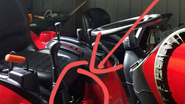

My T234 has a small pull out metal tab that will lock the up/down function. It is located in front, bottom of the lever. It's confused me for a sec....just had to push it back in. Must have caught on my pants....I usually don't get off on the joystick side tho.
Also mine has a float function that's not so friendly to get out of. My float is full forward past the down position and is very difficult to pull it out of the float position.

Up/down lock. 20181011_133014.jpeg

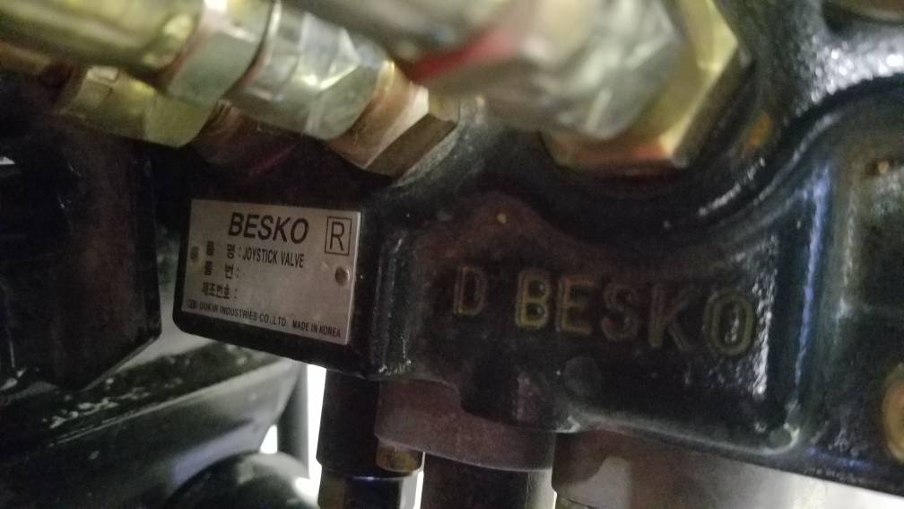

I've checked the lock, it is clear. I tried to pull back on the joy stick (float) no luck. I switched the lines and the dipper lifts the loader so the cylinders are ok. I assume either the cable is broke or stuck or the valve plunger is stuck. I need to disconnect the cable and pull the plunger. That is why I want a diagram so I know what to expect.

Take the end cap off. Water gets in there and causes rust.
/ TYM 273 loader valve
The end cap did reveal the issue, the retainer was corroded and 2 of the 4 ball bearings are missing. That binds the shaft so it won't cycle. The valve is a NIMCO 11087-2S, K2, M07A0002. I looked online, no replacements or parts easily located. Anyone know a guy? (it's a RI thing)
