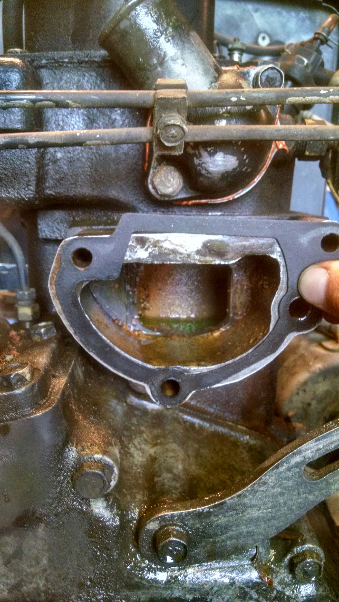

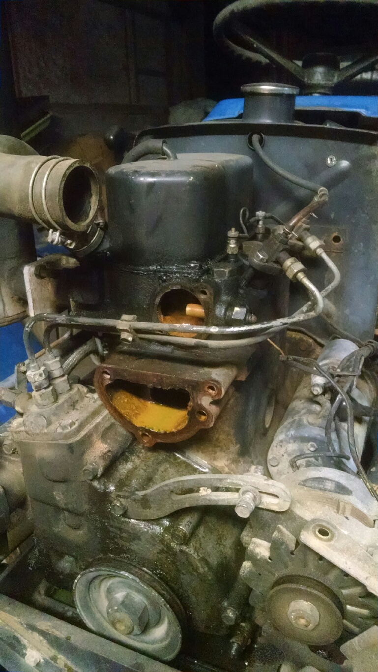

I removed the water pump and upper coolant pipe today. I was surprised as to how easy it was. My machine does not have a thermostat in it so I can rule that out as the problem. The water pump does not appear to be bad, but I am not positive. I ordered one today on ebay for $50, might as well just replace it while I have things apart. I did notice that the belt was in pretty rough shape so that will also need to be replaced. Maybe it was slipping and the fan was not spinning fast enough? Looking down the radiator I can see some scale deposits next to the inner tubes, but nothing bad. I will see about cleaning that out somehow, maybe with some vinegar or CLR. Other than that I do not see any obvious reasons why the machine should have overheated. When I get it all back together I will give it another workout and see how it performs.

I probably did not need to but I decided to put a new water pump on the tractor. After I put installed it and put everything back together water was pouring out from behind the water pump. Took it all apart and I noticed the gasket that came with the water pump was off by just a little bit. If you are going to replace your water pump make sure you check the gasket!!IMG_20191020_102628126_HDR.jpg

No, the water pump is a perfect fit. It looks like when they stamped out the gasket it must have shifted just a bit. I didn't have any gasket material so I just tried some gasket maker by permatex. I filled it up yesterday and let it run until the engine got hot. No leaks. I also added some radiator flush and put a new fan belt on. If this little tractor over heats now I am at a loss. I hope to use it a little bit this weekend and see if I can get it good and hot. I can't see any reason why the other water pump would be bad, it seems to be in perfect shape. The fan belt was in pretty rough shape and possibly the radiator was plugged just a bit.
