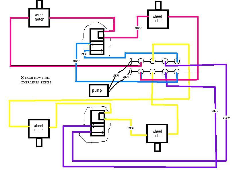

Solenoid valves would position themselves thus when the PT would be in the regular mode as it comes from the factory.

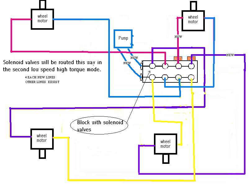

One more. The way PT is set up now. simpler and less hoses. Keeps a person from wanting to change?????

This is everything needed to swap over to the parallel mode and test its efficiency. Most every thing I do is on level or slightly sloped ground so I don't really need to pursue this but I thought it would be interesting. I think we have lost interest in this anyway. Maybe I could ship it to someone more willing to try it.
/ Two speed modification for PT 422/425 #24
Stray, don't give up now. Everyone is dying to see if this works. It actually looks simplier when you show the parts. One of my biggest complaints has been the wheel torque. Keep going!!
