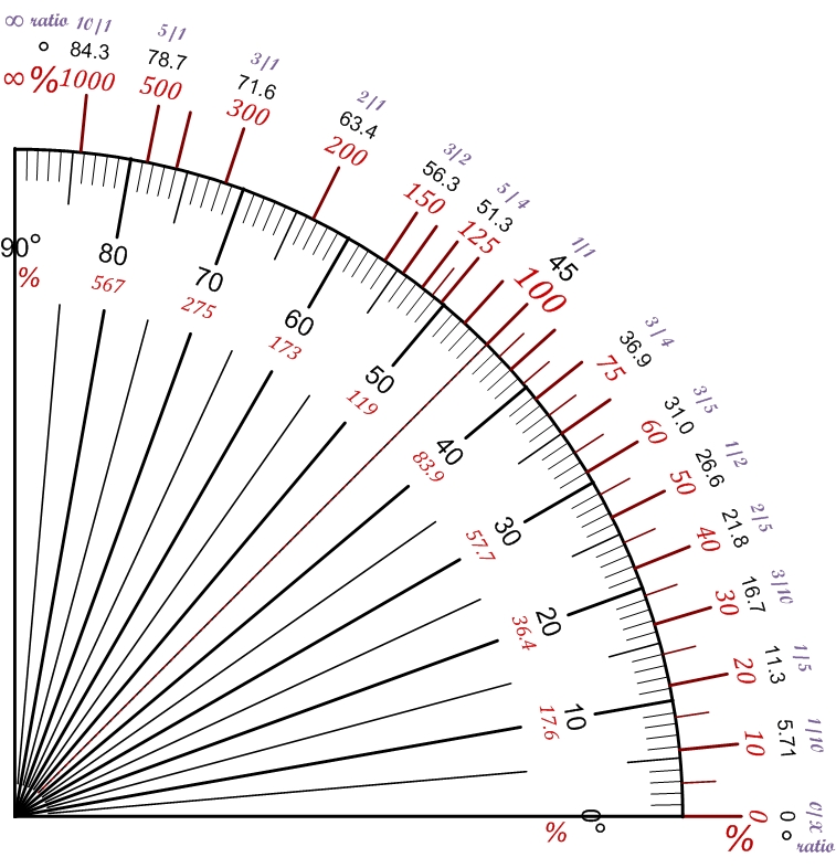

Free opinion: buy the mid-mount mower. Shop around too as $2700 sounds high (I'm not in the market though.) You probably won't have to take it on and off very often and even when you do it is fairly easy. About your wet terrain: zero turns are fine on the golf course and very maneuverable but they have notoriously poor traction on adverse surfaces, plus steep ground is NOT good for them.
I suppose this is nit picking but you are not taking any tractor over a 45 degree slope other than to slide down it once if you are lucky. A 45 % slope, sure, but NOT 45 degree. A 45% slope is roughly 24 degrees. A 40% slope is "healthy steep" for a good low profile 4WD tractor and 50% is a sensible upper limit. A 45 degree slope is a 100% slope. See chart below.
Thanks for the chart-I think its more like a 25 degree slope based on the chart attached.
