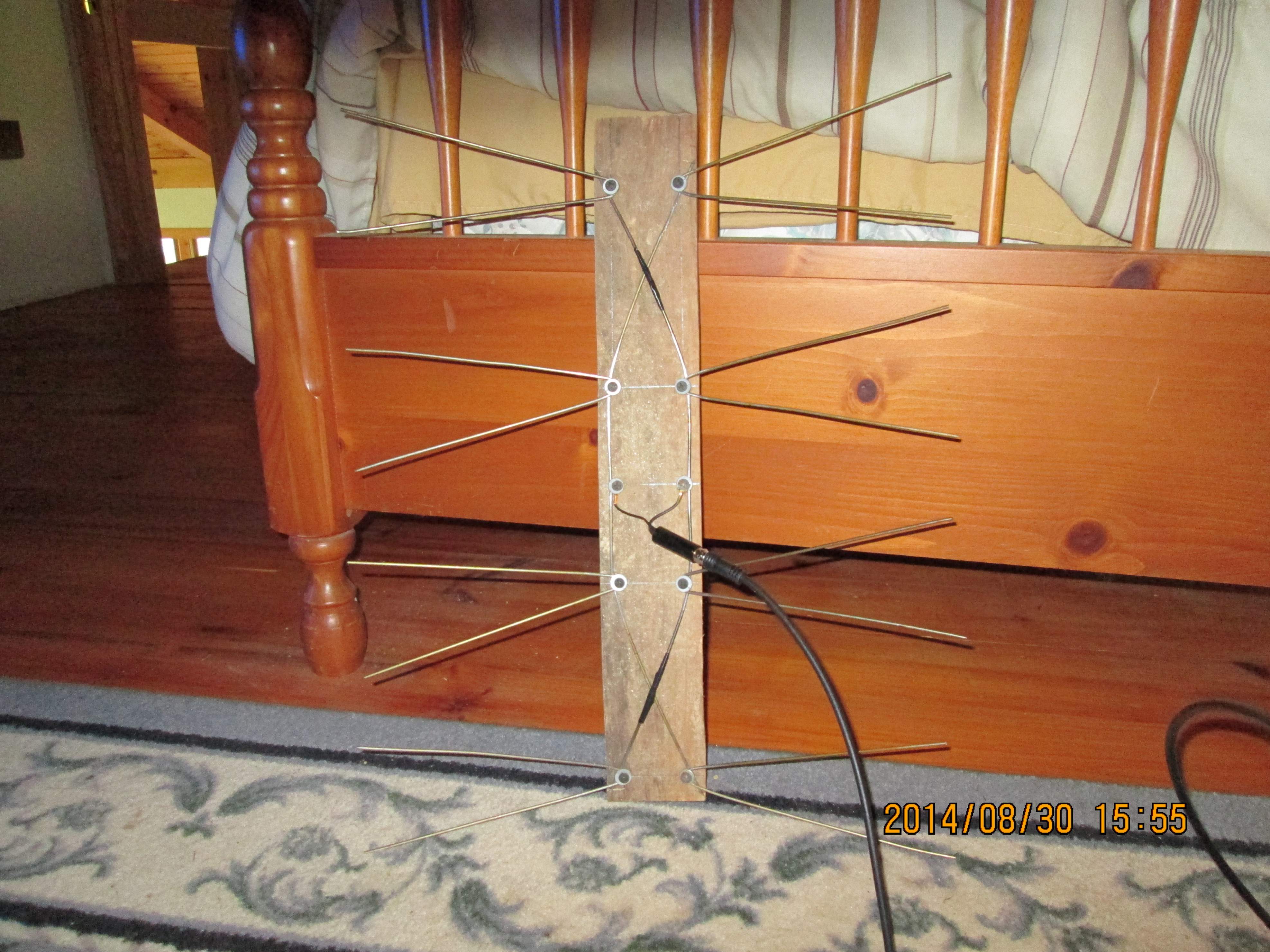

nice setup :) !
the soft "ear plugs" works as nice protective ends of the wires.
add 2 to 3 feet of board to one of the ends to raise it off ground. makes for placing it easier. without getting poked as well

made myself one as well. and refuse to go back to any store bought antennas. this DIY antenna outshines all other antennas for range / reception / signal strength. well i take that back higher above / roof mounted antenna is going to be only thing that beats this.

in the house beside the main tv, i either prop it up against the wall, or set it up on a cabinet. the extra length on bottom lets me place it behind other objects on cabinet and not get hung up on crud. or set it behind a floor speaker.
with aluminum siding, and tv stations spread out far enough apart, and living out in middle of no were. i do have to move the antenna. for some stations more so bad weather. and trying to get them stations clear away from me, that i would not normally get with some store bought antenna.
i also have a piece of plywood with aluminum foil (kitchen foil ya use for cooking) on one side. ((need to make sure wrinkle free)) that i can place behind it. to focus everything better. with the 2x6 lumber that the hangers are attach to. it holds the wires off just enough from the foil. and seems to work pretty good. but i have for most part abandoned the aluminum foil on plywood. due to only extra channels i pick up. are exact same "copy" channels per say but from another large city. (different news, but same shows doing), to also note it, the aluminum foil on plywood can cause interference on certain stations, it causes to much single bouncing around in home.
it would be nice to place this homemade antenna up in the attic or up on the roof. but i would still want to be able to rotate it some.
the home made antenna and foil on plywood, i have tried at my mom's house, and at a cabin back on the farm. both in basement, main level, and roof. and the home made antenna has won, vs all other antennas i have tried. with exception like noted before. a roof mounted antenna. that can rotate more likely to win out vs anything out there.

I made one of these and I can't get it to work. Any trouble shooting tips?

the little converter (2 wires to coxial cable) is the key ingredient. i don't remember exactly what ya need, i just remember there are different type of converters out there more so "specifications" they may all look the same, until ya look at the model number / spec's of it.
i had some other converters over the years from other stuff and tried and no go, radio shack was right there one day and picked correct converter up for a couple bucks. and it was golden then on. one of the older converters i had i think was just plain old / rusted / corroded / broken inside. it worked but give it a little bounce (walking to hard beside it) and would stop working. another one i had was at a different frequency setting and didn't work all that great if at all if memory serves. i had a couple others but copies, and non that i needed.
your wire spacing (screw to screw / nail to nail) in how ya fastening, along with length of V shaped wires, also plays a roll in what you pickup for signals, it just not a guess and go thing. most instructions on internet give you a length, and how much to bend the V into. and the spacing between each V. so not really hard to mess up there, or less ya got a kid around, bending the V's here and there vs moving the entire antenna.
the Criss cross wires...from V to V. they are not bare wires, they are insulated as they cross each other. if ya look at randy41 picture, it looks like electrical tape (black bulge) were the wires cross each other.
i have old spare RG9 cable from a satellite install. little bit thicker wire and better insulation/shielding, than cheap RG6 coaxial cable. the RG9 seems to hold a better signal for a longer length of cable.
make sure you "re-scan your channels" not a generic quick scan, but a full re-programming scan on your tv and/or tv box.
i was skeptical at first when making it. so i ran the stupid antenna outside and ductaped it to a ladder setting out in the yard. picked up the singles big time, began moving it different places around house, and there are some ugly spots in the house. were my signal strength dropped for some really far off stations (normally should not be getting any way). but was still able to get local tv stations within 20 to 40 miles of me. other words you should be able to get some sort of signal for your best tv station in area with a rabbit ears with this thing. or less ya messed something up.

I'm getting nothing at all...thanks for the reply I'll try a new connector.

Actually a good quality (not the radio shack stuff) RG-6/U will be better than the RG-9. They both have about the same attenuation but the RG-6/U is 75 ohm while the RG-9 is 50 ohm. Also the RG-6/U will usually have a 100% aluminum shield plus braid, foam insulation, a smaller diameter and be easier to work with as connectors are easier to get. Some of the newer CATV RG-6/U cables will beat the RG-9 by a significant margin. The RG-6/U will also normally be a better match for the tv and, with the 4:1 transformer, a closer match to the antenna. RG-9 is good for handling much larger power levels such as in transmitters. I would use the RG-6 for a TV receiver.
And if you didn't know it, your tuner on your TV is meant for 75 ohm cable. Using 50 ohm will work for a while, but eventually it could take out your tuning circuits due to the impedance mismatch.
