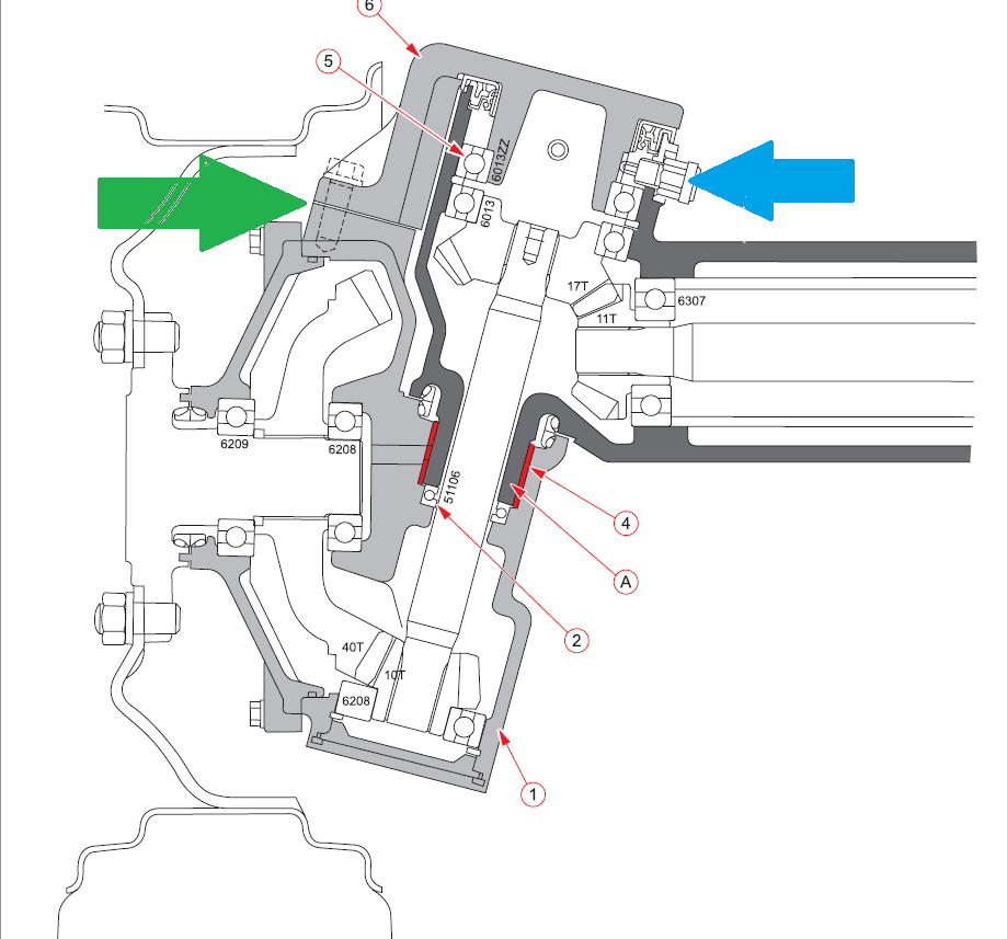

My Tractor is the smaller CK30 and at the 50hour service I changed the front axle lube to Amsoil 75W110 Severe Gear. I think that the 80/90 is too light if one uses the FEL for heavy work, like I do.
Dutchy
   / Turned 1000 hours - then crunch... #18
Were you greasing that zerk on the upper shaft support? (blue arrow in drawing) Thats the only way that upper bearing gets properly lubricated.
If you were, perhaps the shims (where the green arrow is pointing) were not correct from factory, causing too much play.
I'm curious what you find the cause was here. I hope things work out for you.
Where did you find the schematics for the front hub? Do you have a link that you could share, in particular, for my CK30 HST? Thanks, Dutchy

I have a 2006 CK30HST that had the same problem. I took it apart in my shop and went to my local New Holland dealer and they had the bearing and seal in stock. I was prepared to drive the 175 mile round trip for the parts. All total the bearing/race/seal and labor was 85.00 dollars. If it is the bearing the numbers can be cross referenced. Good luck. A lot of loader work will have some effect on the front end even though it is built for it.
   / Turned 1000 hours - then crunch... #20
Good stuff right there!!!! I've also used O'Reilly's Auto Parts to cross bearing numbers. Only buy from the manufacturer when it's necessity. :)
