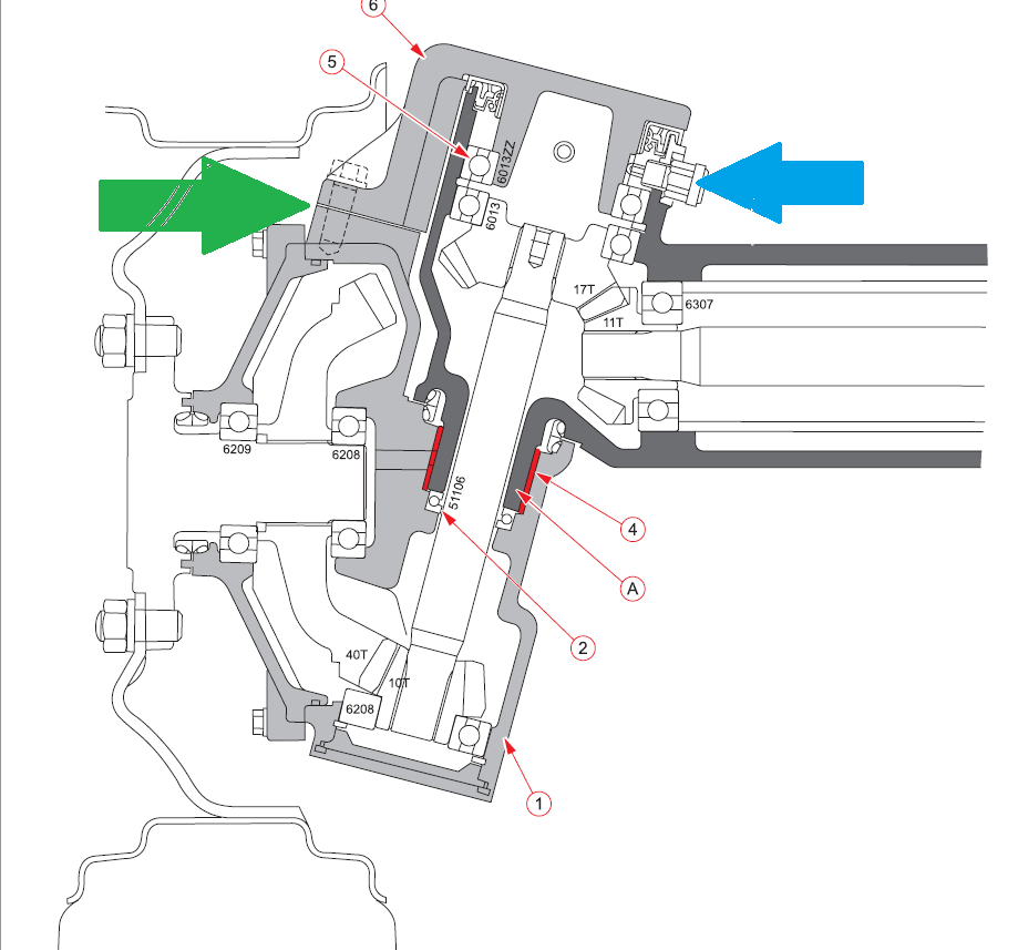

I just turned 1000 hours on my DK45 HST and.... I hear (and feel) crunching noises from my left front wheel. I popped it out of 4 wheel drive, jump off and look. The wheel was covered in hydraulic fluid running down the inside of the wheel. My best guess is the seal, and wheel bearing went bye-bye at best, and the way it was sounding, I'm guessing more may be screwed up.

Were you greasing that zerk on the upper shaft support? (blue arrow in drawing) Thats the only way that upper bearing gets properly lubricated.
If you were, perhaps the shims (where the green arrow is pointing) were not correct from factory, causing too much play.
I'm curious what you find the cause was here. I hope things work out for you.

Thanks - I have greased every fitting fairly frequently, so I'm not sure if I have missed this one ( I don't think so). I'll post what the mechanic says once it's fixed.

I'm gonna guess part # 6208 or 6209 in xcgreene's excellent picture.

I have a 2006 CK30HST that had the same problem. I took it apart in my shop and went to my local New Holland dealer and they had the bearing and seal in stock. I was prepared to drive the 175 mile round trip for the parts. All total the bearing/race/seal and labor was 85.00 dollars. If it is the bearing the numbers can be cross referenced. Good luck. A lot of loader work will have some effect on the front end even though it is built for it.

Good stuff right there!!!! I've also used O'Reilly's Auto Parts to cross bearing numbers. Only buy from the manufacturer when it's necessity. :)
