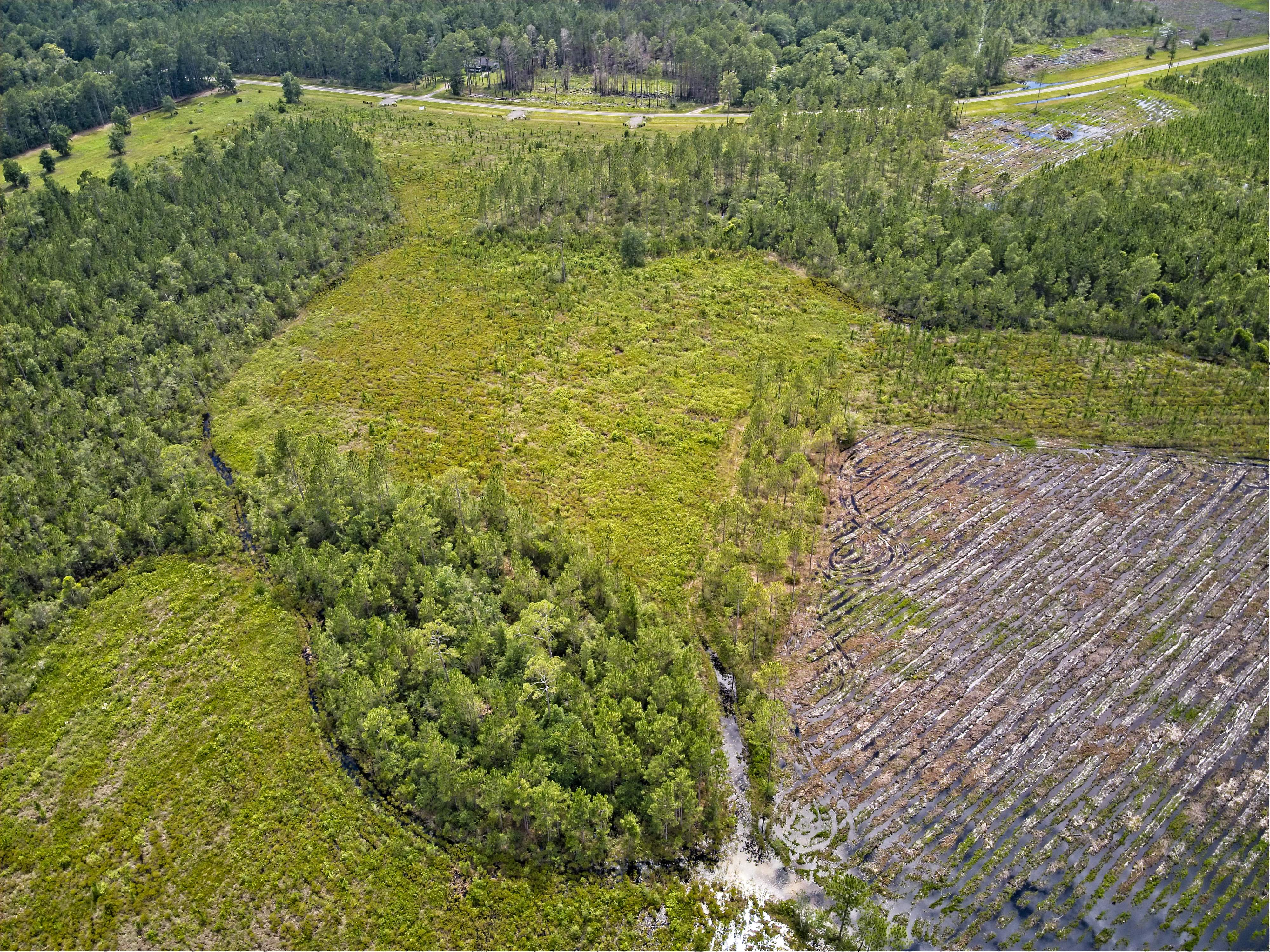

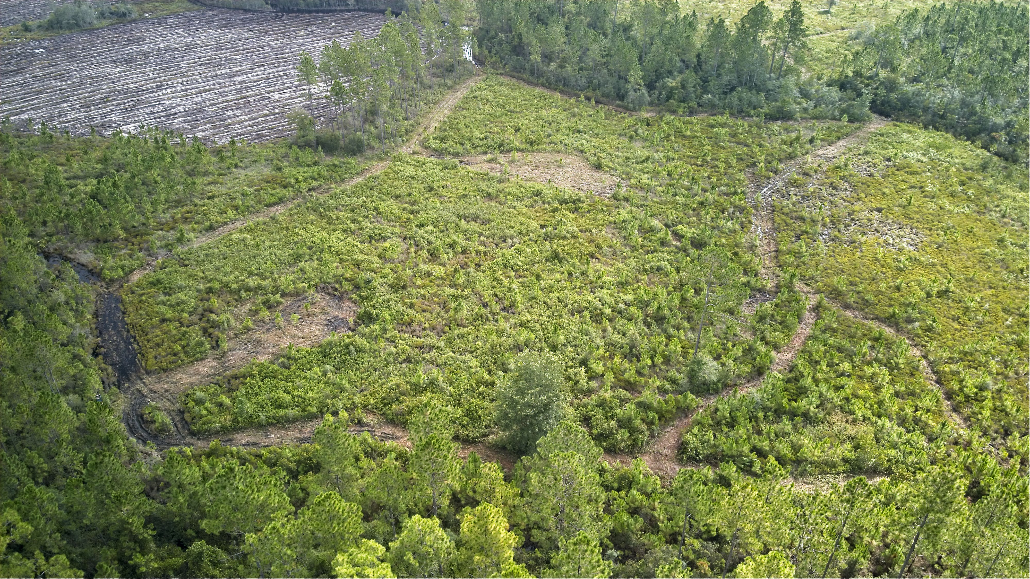

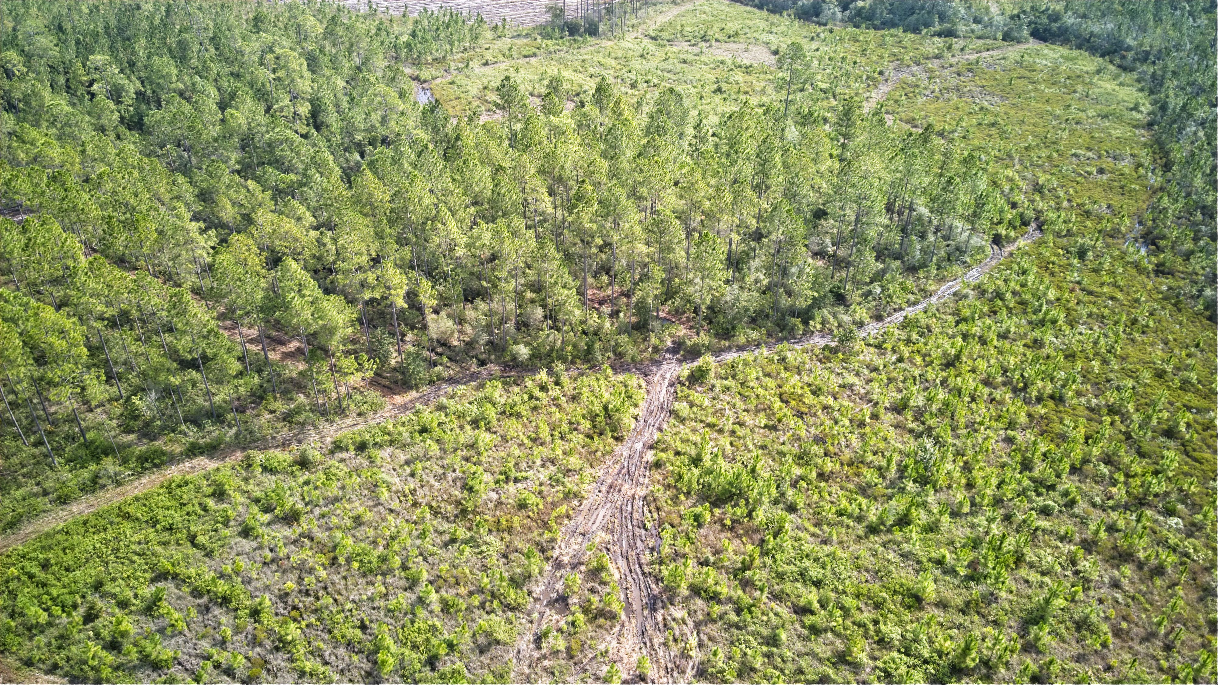

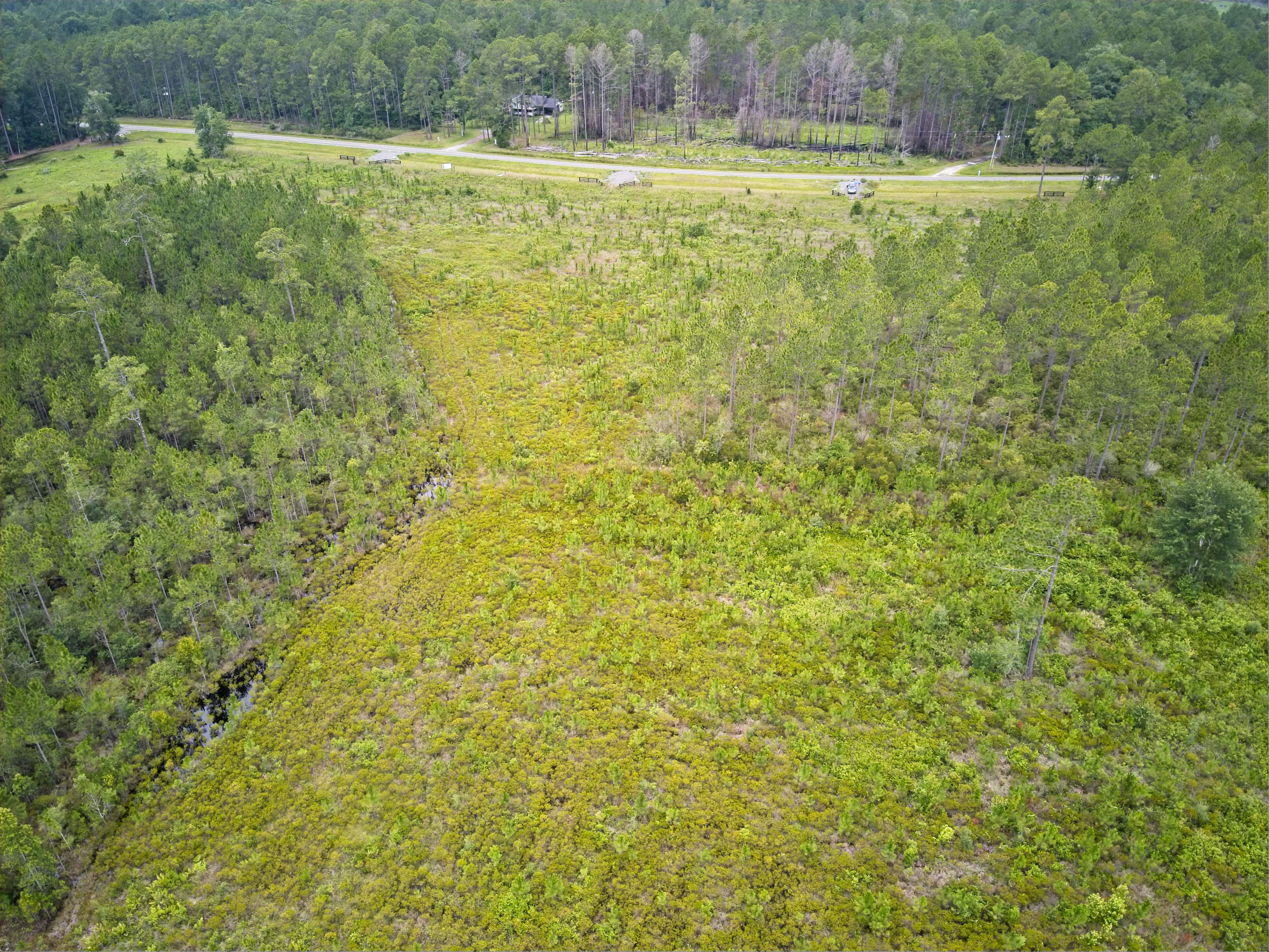

Here are some pics of the property. The areas that look pretty open are anything but. I have cut some trails just so I can access the property.

I'm even more convinced that you should learn more about the land before doing alot to it. I think I am seeing the rows mentioned in your first post. They appear to have been made intentionally but why? And why intentionally create an are that hold's water? Perhaps the ground is naturally wet and rows were created while hearvesting timber. Ask neighboring landowners with land that has been hearvested for help with when,why and who did the hearvesting. If there's a pulpwood or papermill plant nearby,contact them. That might reveal the answers as well as expert advice. What about the grey (look's dead) trees? That look's like culling unwanted trees for timber management. If you plan on putting net fence around the property when you begin pasturing it,do it now and lease land to a goat rancher. Goats will clear growth from ground and as high as they can reach standing on rear legs. After goats clean it up a bit,you will have a better idea of what lie's ahead and doing it will be easier when you can see better.

Jaxs, the title was "timber land into pasture land" so that is the answer to some of your questions. Rayonier owned the land and took timber from it. That is where the rows came from. They just didn't do anything after cleaning up the land a bit. Unfortunately, all the neighboring land is or was Rayonier so no real owners to talk to. I've been trying to find a local Rayonier forester because my guess is they would or could be a great source of advice. I think what you are calling "grey trees" is actually dirt. That particular area is still Rayonier. They took timber from that area and did not re-plant. As far as goats, already went down that road. I was told that goats will not eat what I have and a bigger issue is about $30k in fencing that I am not going to spend for now. I will start fencing it myself once I move there.

The photos are very helpful. Planted pines that have been clear cut. I will be in the same boat as you within 5 years after I clear cut mine. I will probably replant in long leaf pines though.

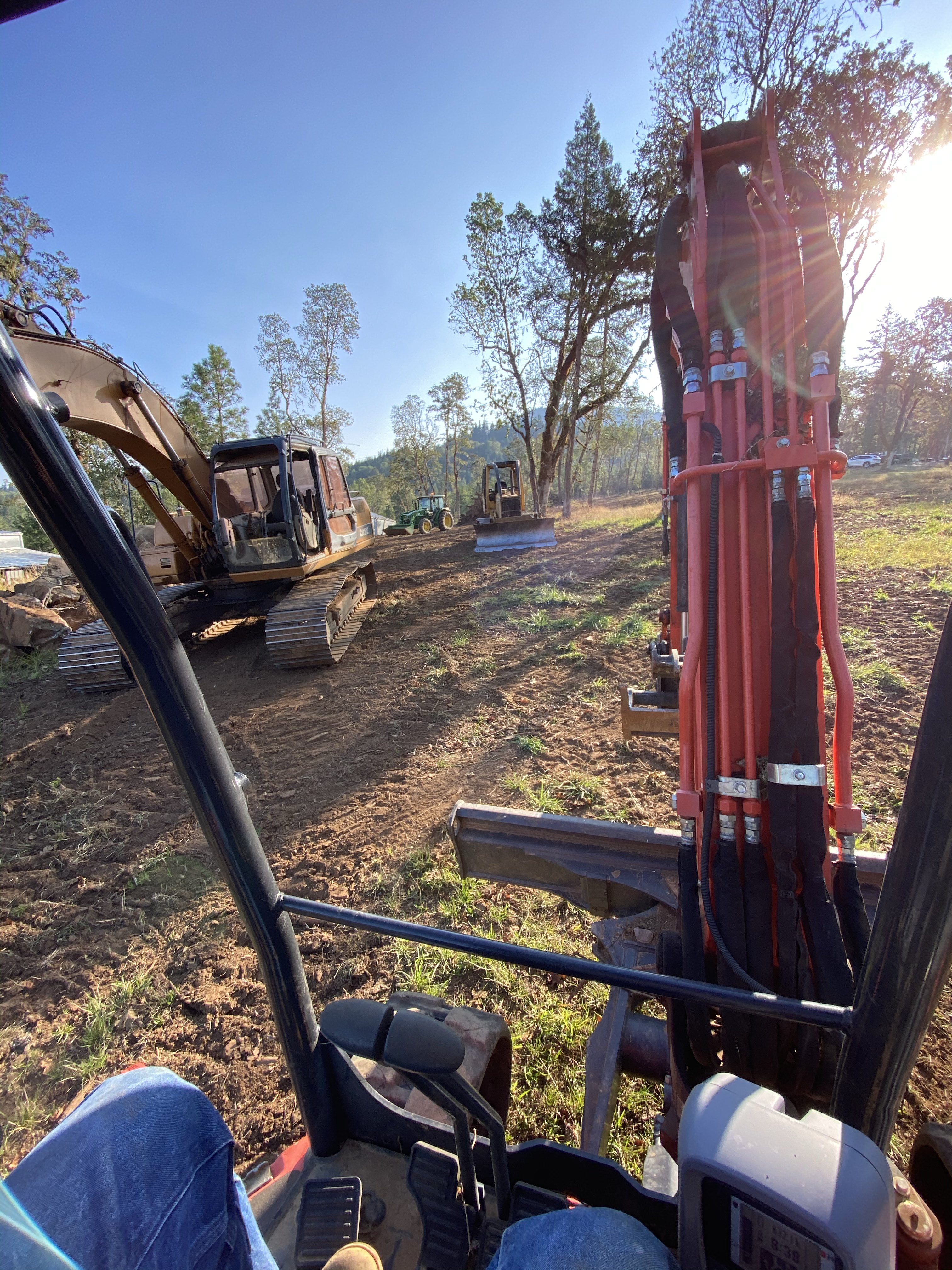

I have a side gig doing land clearing, currently working on a previously logged site. Without a doubt, an excavator that is sized appropriately for the job is the best tool in my arsenal. A dozer works good too, but if I had to chose one it’d be an excavator.
