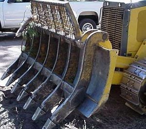

Have 31 acres of which approx half or more is timberland that was cut, cultivated and left unplanted....
What would you do?

Dozer with root rake blade. The combination has been in use for Successfully for years.

I don't have that many rocks so that is good news. Trees are not an issue here. The area I am working with is open with heavy brush. There are some trees that are just a little big for a bush hog but still small. I can use the ratchet rake on the bucket and get those out if I need to. There is very compacted root base that would seem to tell me not to use a tiller, yet. Funny, if I ask this locally, the answers I am getting are specific to the equipment people own meaning no one has the same answer. If they have a skid steer mulcher, that is the right tool. If they have a dozer, then that is the right tool. Hard to get real answers. A lot of good info here though.
