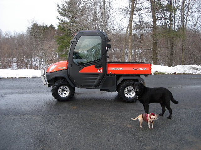

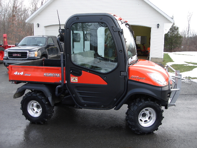

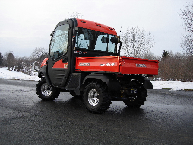

A couple of you guys asked for pics of the whole machine. It was warm enough here today to clean it up so I took a couple of pics. I do have a short video of it running with the turbo whistling, if someone could tell me how to post a video, I will.
