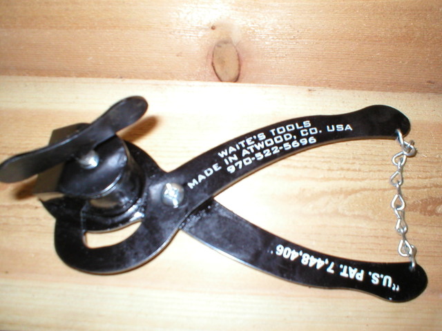

Once removed, if my Backhoe is in the Sun, I have to take a wrench and loosen a fitting and bled off the pressure that has built-up due to the Hydraulic fluid expanding. I generally loosen a cylinder hose fitting and allow a couple of spoon fulls to leak out. Be sure to select a fitting that dosn't have pressure due some load placed upon it. Works every time. Fred

Go back and look at post #19, I bought this gadget and it is worth the price. Cracking fittings is pretty sloppy and a little dangerous. Contrary to post 41, by definition, they have pressure in them, if there were no pressure, the quick couplers would go back together easily. I used the rag and rubber hammer method until I bought George Waite's gadget.

Here's more info on the 'tool': Patent US7448406 - Hydraulic coupler pressure relief tool - Google Patents

Question: can't you depressurize those lines by just working the control lever with the engine off? I haven't tried disconnecting any of mine but it seems to dump the pressure in the hoses to the loader if I just work the loader control in all directions with the engine stopped.

Yes, but after an implement like a hoe or grapple needs to be connected back to the hydraulic system the fluid in the lines has expanded in volume from exposure to high temps, (exposure to hot sun) then the problem of the expanded fluid blocking the ball shut off from opening enough to reduce pressure inside the line occurs at point of connection; and one cannot overcome that issue without relieving the pressure manually, prior to hookup.
See the patent article description of how hydraulic systems function in the link in my post above- it gives a really good description of the problem.:thumbsup:

Here is a gadget you should have.
Simple Tool Solves Hydraulic Pressure Problems
A simple tool invented by George Waite makes releasing pressurized hydraulic couplers as easy as turning on a water faucet. Waite's Hydraulic Pressure Relief Tool works like pliers to grip the valve end. Turn a simple tap on one side of the pliers, and it slowly presses on the male fitting, gradually releasing pressure

The gadget only works on the male side, the female side (on the tractor) as you point out can be depressurized by moving control levers, but the male side (implement) is off the tractor, laying on the ground in the sun ergo the pressure build up.

Some of us use both male and female on implements like grapples so we are forced to hook them up correctly. This tool is not so helpful if it doesn't have a way of relieving pressure on the female side.
I just keep a small ball peen hammer as well as a rag and a 3" piece of 3/8 brass rod in my tool box. The hammer taps the male tip through the rag and taps the brass rod which is positioned on the female nipple. No fuss. Works every time.

Hammer away, I did it for years, but it is not good for the QD and not safe either.
No editorial comment from me about spending $30,000 on a tractor and not willing to spend $30 for safety and convenience.
I have mentioned before, it sounds like I am shilling for Waite's Tools, but I have no connection with George Waite. I bought the tool on a recommendation from someone on this site, called Waite's, talked to the wife, got the tool and sent a check. Used it many times in the past two years. I guess in Texas it is hot all the time, here in NE if you take an implement off in the morning when it is 60 deg and want to put it back on in the afternoon when it is 85 deg you will have a problem. I also color code the line with red and black zip ties.
