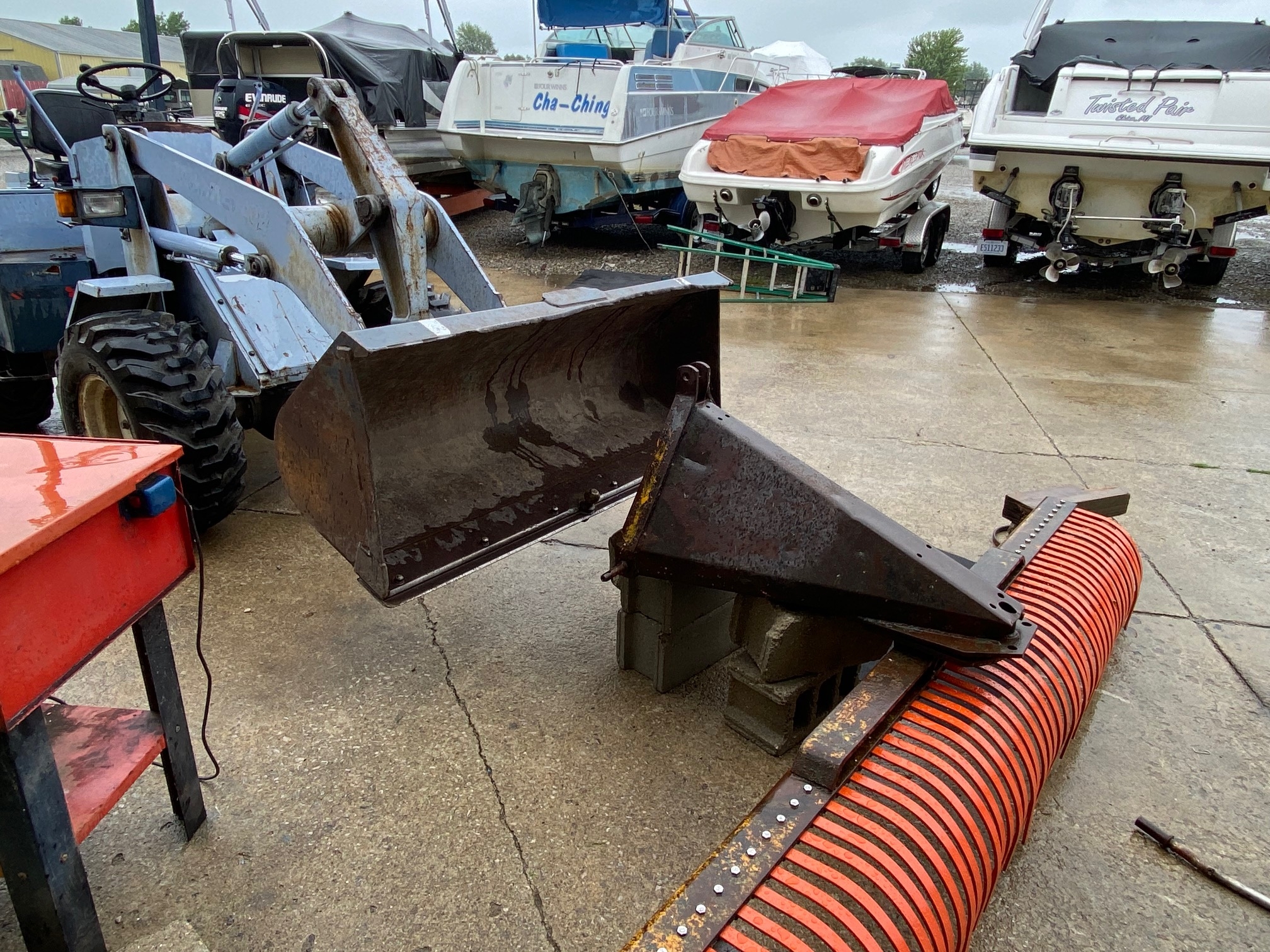

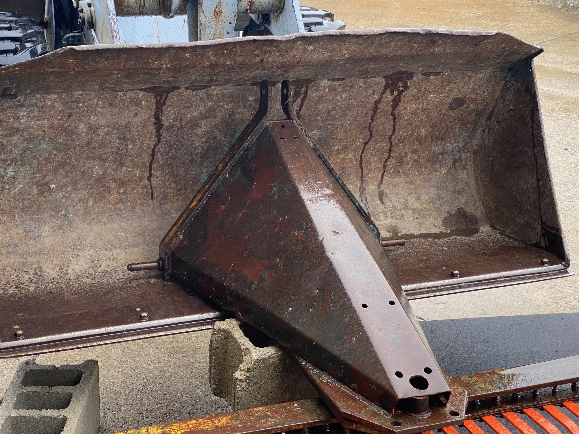

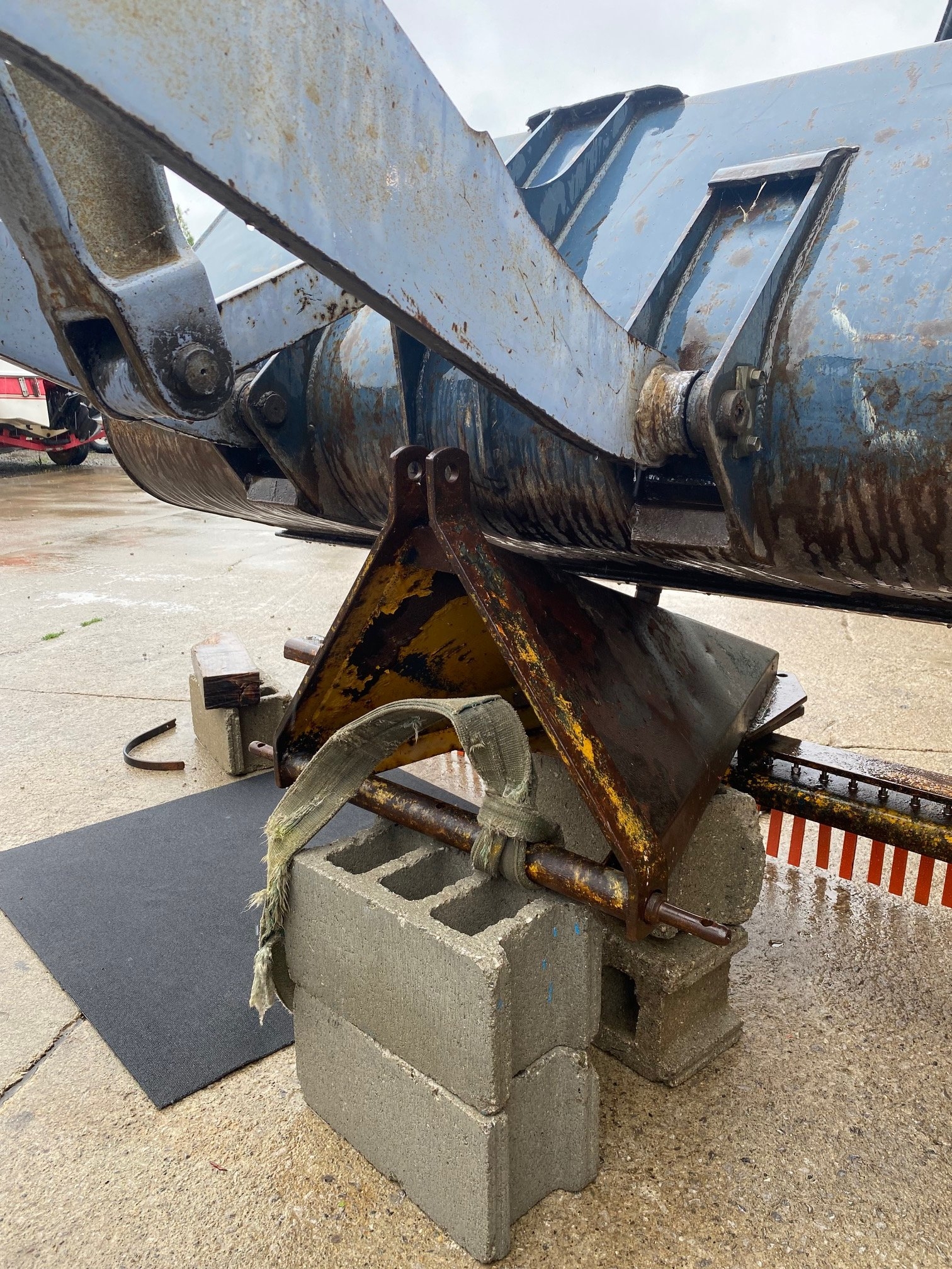

Hello,
Does anyone know of a way to get a 3 point hitch adaptor of some sort mounted to this bucket? Do they even exist? Before I start welding and drilling a bunch of nonsense to make this work, I wanted to make sure there's not some kit that'll attach to the bucket. I have a JD2155 for the rake, but if I could have more control of this and get it hooked up to this Kubota, I'd get a lot more done. Thank you to anyone for any help or advice.

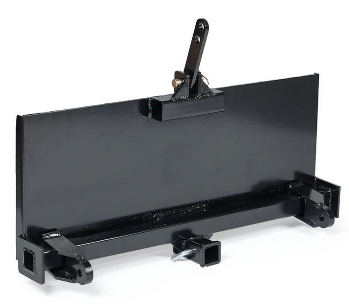

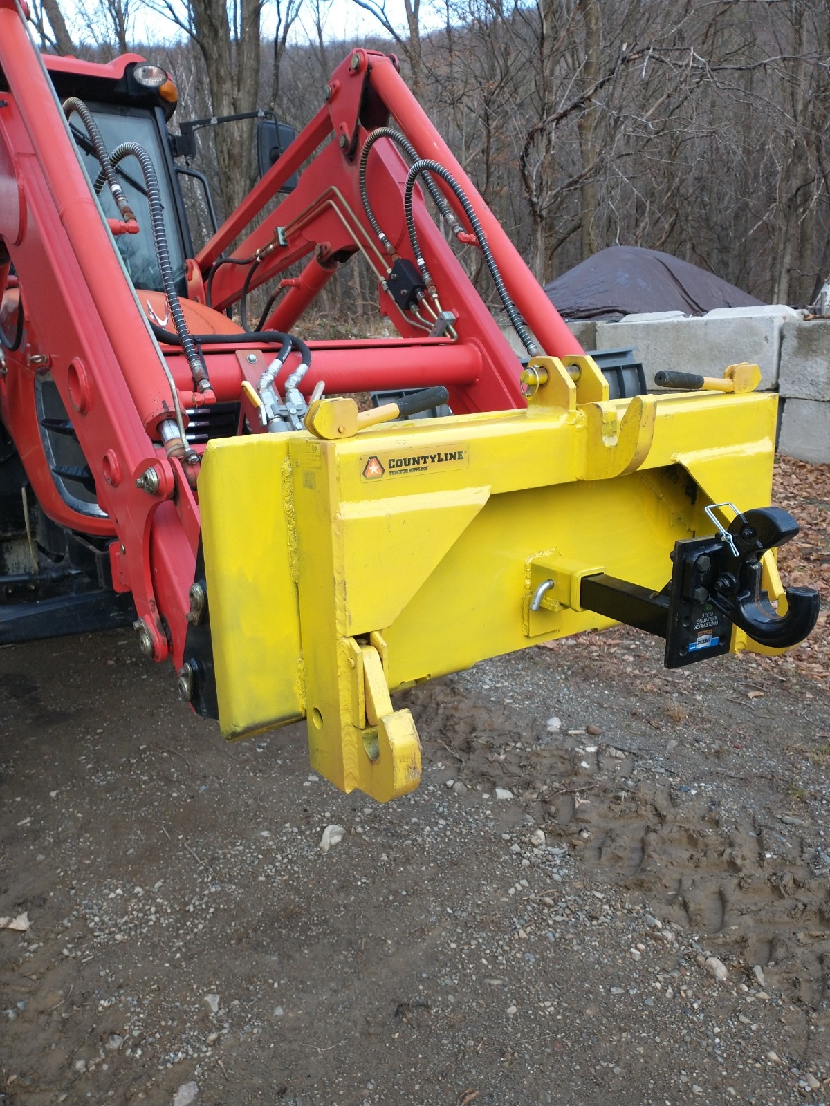

Never seen anything for a bucket mount but they do make SSQA to 3 point adapters;
And I built one by welding a quick hitch to a SSQA plate.
It works to move equipment around, it doesn't work very well for working with 3 point attachments as they are so far from the axle that dips and rises move the attachment up down to much.

Even when in the floating position? I'm on the fence on getting one myself.

I started a project but life came along and it's been stalled. It'll be a QA frame that with adaptive mounting for 3-point stuff (rake will be first). I have a fence row that needs cleaned out.
Mounting the rake to a bucket would be a cinch. Two pieces of angle bolted to the inside bottom of the bucket and something at the top for the top link and you're off to the races. It may not be quick on and off if you need to bolt and unbolt one of the angles but it'd be simple.
Mine is a heavy loader and I tried it using a york rake and it was terrible, in float it had so much more weight then the 3 point does.

I'm not going to be using the bucket mount for big areas. I have a John Deere for that. I have a marina and need to get in tight spots to get weeds down. Tough to do backing up with the JD and the herky jerky movement. When I get this mounted on the bucket, I'm home free. I've come up with an idea about how to do this with welding on to the rake itself. I don't want to weld a ton inside my bucket. I'm always loading cinder blocks and what not in there and I need inside the bucket flat.
Thank you to all for the replies. I really appreciate it.
