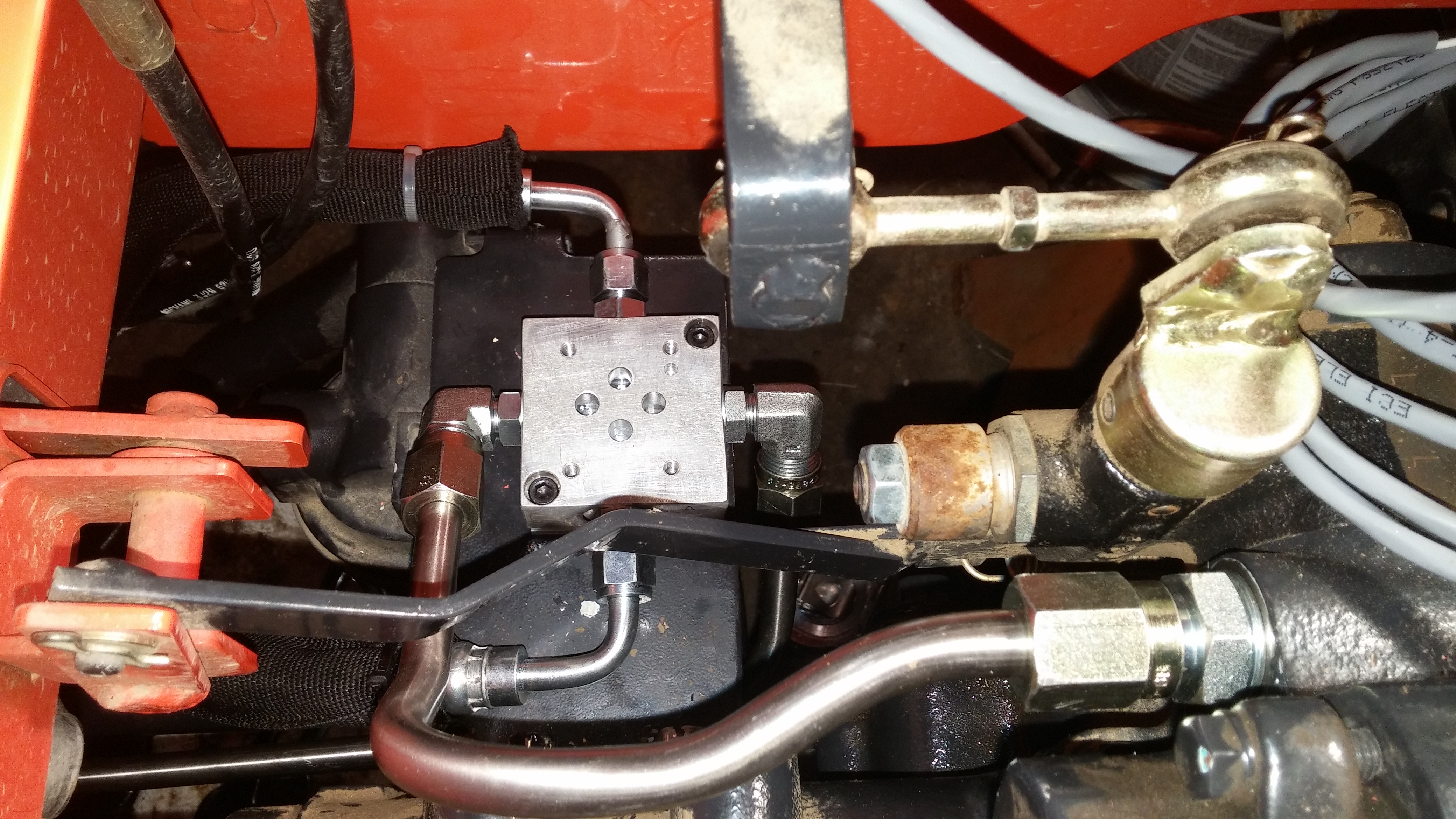

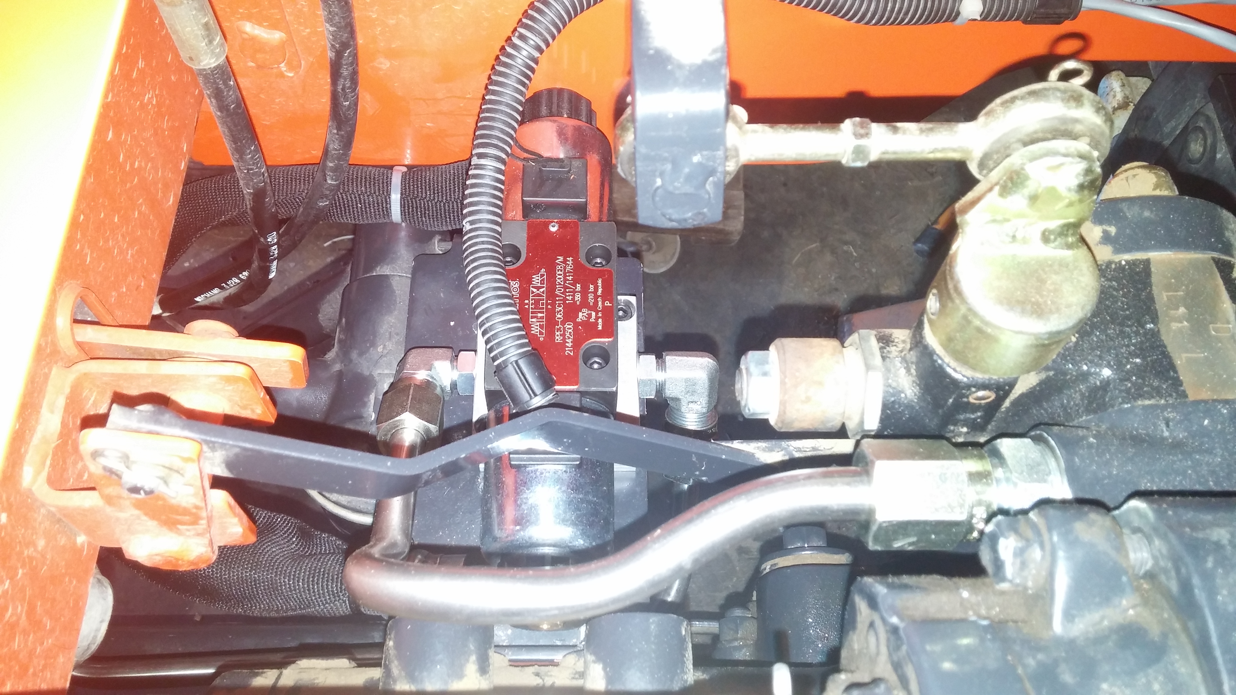

I went with this valve and the same do3 sub plate your looking at
12 VDC 21 GPM ARGO RPE3-6 DA HYDRAULIC DO3 SOLENOID VALVE | Solenoid Valves | Hydraulic Valves | Hydraulics | www.surpluscenter.com
Only reason was it was able to handle a much larger flow and pigtails instead of a bulky connectors. I have been very happy with it for the past 6months, its a very good quality valve made in Europe. I also opened up the ports in my sub plate I wanted as little restriction as I could get since my power beyond circuit also runs my backhoe when I have it mounted and if there is a lot of restriction it will create much more heat.
View attachment 518945 View attachment 518946
What a clean mounting with the hard lines. I sent you a PM
One general question. As this is in the power beyond going from the loader control valve to the 3pt lift you used an open center valve (correct) so everything works including the 3pt when not in use. If I have a load on the 3 point, will activating the valve cause the 3pt to droop? Also where does the return flow form the double acting cylinder go? Also if I operate the loader controls and hit the switch to operate the hay grapple, will the loader functions be impacted? I am trying to wrap my head around this.
/ Trying to construct a 3rd function #46
Think of it as just inserting a diverter valve in the power beyond line so everything will work as it did befor the valve was put in. All the valves are in series, loader has priorty next 3rd function then last 3pt hitch. When you have a load on the 3pt and you lift your loader It stays put because the 3pt valve shuts off unless it's moving. All return flow goes through the 3pt to tank. Hope that helps.
