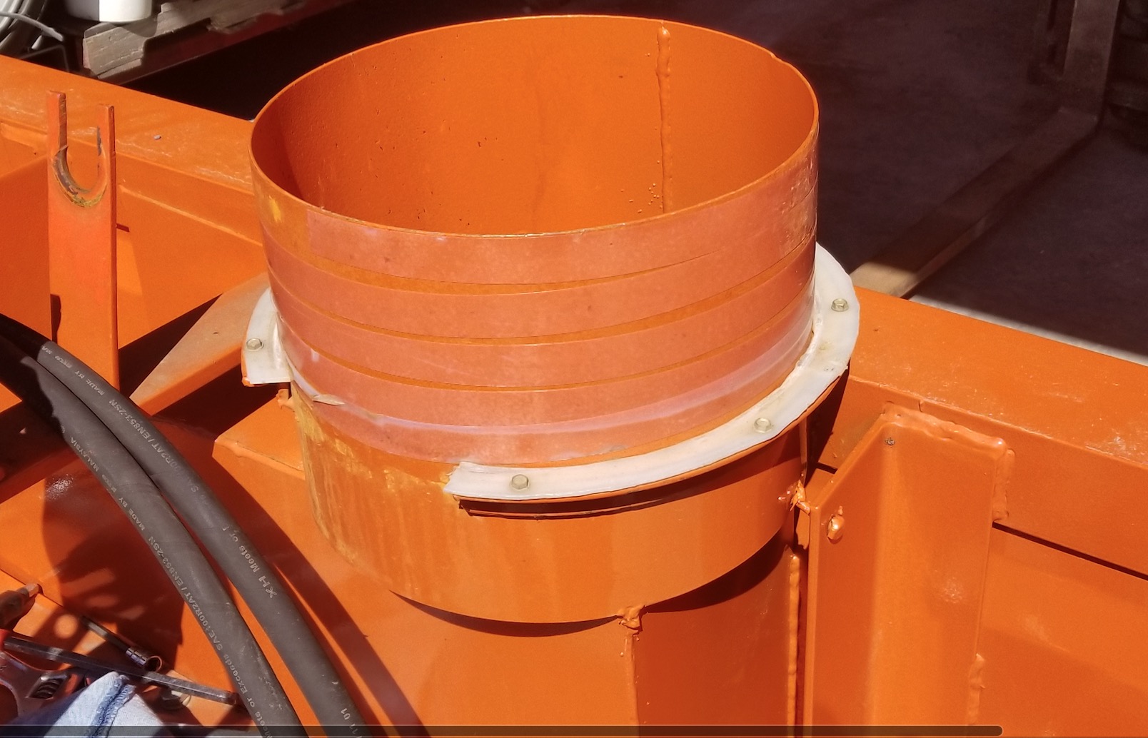

One complaint I have withe using a 3ph snowblower is that in some weather conditions ice starts building up in the blower chute between the fixed snowblower base and the chute itself. Basically its two concentric steel pipes and no bearing surface to slide on. Its just paint to paint or steel to steel. Theres a little bit of melting happening in between and eventually ice builds up enough to jamb the chute rotator.
My snowblowers have always been the manual chute turner type using a steel cable wrapped around the chute base to turn it. Not a very durable design. Eventually I cant hand crank them after using it a while.
I rebuilt an old snowblower and modified the hand crank to be operated by a hydraulic motor. I had to add this after installing a cab on my tractor. The problem now is I have lots of torque - enough to pull the chute off or break the steel rotator cables after the chute rotator ices up.
Ive tried oils, spray grease, dry lube...they all fail after a while. I then tried cutting up one of my kids crazy carpets (a thin plastic sheet with handles kids can use as a taboggan) and inserted it in between. It works great until the back and forth action causes the plastic to ride up and out of the joint until the friction from the blowing snow throws it out of the machine.
My thinking is if I could find some thin self adhesive UHMW plastic sheet somewhere it might solve my problems. UHMW is an excellent material used as plastic bearings. Its very slippery and takes a lot of abuse. On amazon I found this 1 inch wide tape
https://www.amazon.ca/CS-Hyde-Polyethylene-Rubber-Adhesive/dp/B000REGUE4
I pulled the chute, cleaned it well, and spiral wrapped the UHMW tape around the impeller exit. The tape seems very sticky and had good adhesion to the painted steel even though it was only several degrees above freezing in my barn. I re-mounted the chute and so far so good. Hopefully this tape lasts at least a season.

Look for an engineering plastic product called - Hyfax. Almost as tough as steel & perhaps one of the slipperiest products made by man. It is used on the bottom of the runners for dog sleds and the bearing surface between the frame and track on snowmobiles. Contact your local dog sled manufacturer or local snowmobile dealership.

I know people have cut "washers" out of plastic table mats to use between the surfaces of the blower body and discharge chute.
Last summer when I did maintenance on my 3pt blower It has a curved channel iron that bolts over the flange to keep the chute in place. In the back of the shed I found half a tube of old grease that is dull blue color about the consistency of Play Dough. I liberally applied that on the places any parts moved together. Not the best product maybe, but it has worked well and is easily and cheaply re-done.

An adhesive backed sheet of it 12" by 24" is only $11 at McMaster-Carr.

I'm finally putting the snowblower away!
I am happy to report that the UHMW self adhesive tape worked extremely well and exceeded my expectations. I originally guessed I would be lucky if it lasted a season.
The photo below shows how I wound the tape around the inside chute tube. It also shows the PE ring I made to make the chute rotate and slide with less friction.
The tape was originally white and now appears clear. It held on the exit tube and never came off. The UHMW provided enough slip that the chute never jammed up while rotating. If the summer heat doesn't cause the tape to peel off while the snowblower is in storage, I expect to get another season use out of the tape. If I was smart I probably should have wrapped something around to hold the tape in place as "just in case", but, oh well, the snowblower is now sitting in the storage rack 16 feet off the ground. I will see if it's still there in the fall time.
Would I by the product again to do this in the future? Absolutely.

Glad it worked!! Seems it became clear from UV radiation. UHMW and its cousin HDPE, is some incredibly good materiel to have around.
