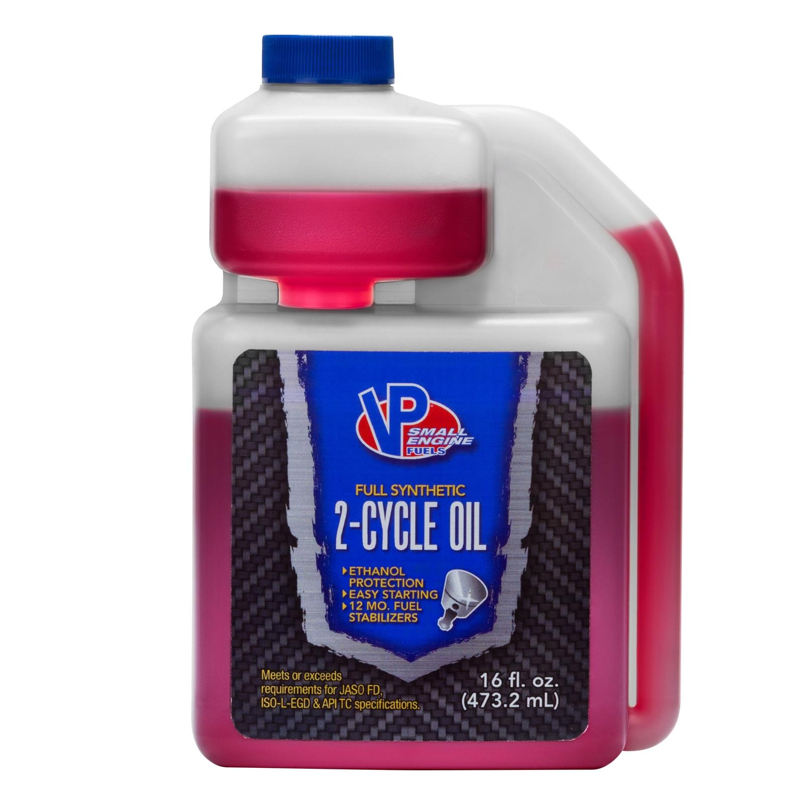

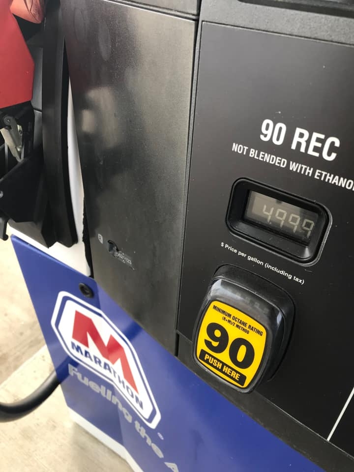

Just make your E-free pumps has it own hose. Other side of pump has hose for ethanol gas here.
Never a problem here and I still check to be sure somebody hasn't made mistake.
VP 40:1 for me in OPE and Gen and Boat just the efree.
I go through to much mix and efree to be paying for canned prices.

Like others have said about the Stihl Ultra oil, I was having carbon issues also. Changed over to Echo Red Armour and carbon issue went away. Have a local station that has 90 octane ethanol free gas with a dedicated hose to the pump so no mixing with other gasolines. All 2 strokes get the same mix @ 50:1. All my equipment starts and runs better since I made the change to Red Armour oil.

I did not have problems with carbon buildup when running Stihl Ultra, but I did not run much of it. I only used it when I could not find the Husqvarna XP+ synthetic blend oil.
THe Husqvarna XP+ meets the JASO FD standard, which is higher detergency and less ash than the FB spec.
Stihl Ultra meets the JASO FB spec.
The lubricity requirements of FB and FD are the same, but FD spec calls for higher detergency, and has more stringent exhaust smoke and exhaust system blocking requirements.
