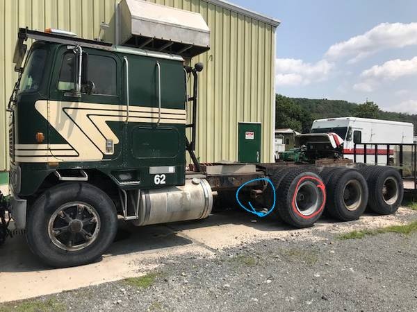

The front axle appears to be a lift axle.
Can't really see well enough to be sure, but I think I see a bearing cap like should be on a non-powered axle on the front axle.

Red circle makes me think it's not a drive axle.
Blue circle makes me certain that it's a lift axle

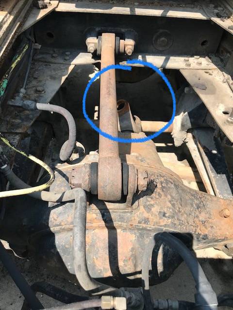

Did you look at the other pictures? Looks like a driveshaft was removed. Wondered why
There are a few true tri’s out there. Military has them, too. Always wondered how the front-most axle survives the stress of full lock turns!

Absolutely a twin screw with a pusher. Probably with a bad rear diff or a power divider that won't unlock.
Looks like rolling scrap with the possibility of a decent engine and transmission.

You can see the oil bath hub plug on the first rear axle, I never see any on road 3 powered axle trucks...
