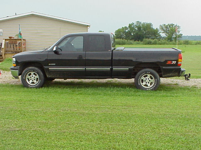

Here is my '99 Silverado w/ 5.3 auto.

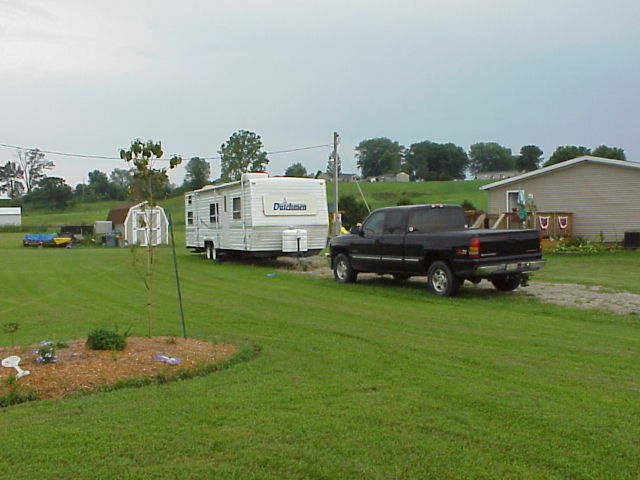

Here is another angle w/ the camper we had borrowed last week.
