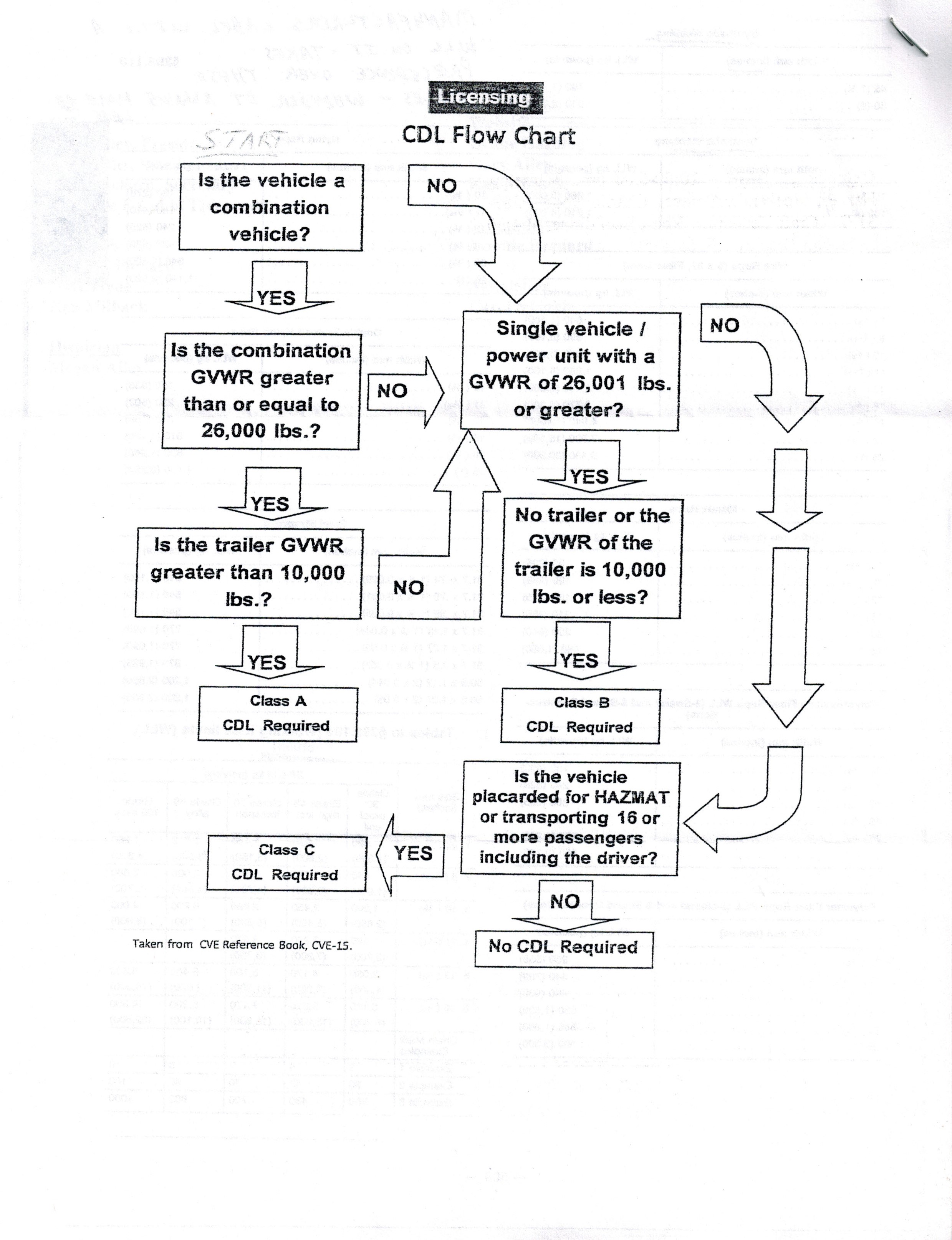

Actually you are both correct to an extent. A vehicle with a 26,000lb GVWR and a trailer with a 7,000lb GVWR (think car hauler). Would require a class B CDL. Because trailer is under 10,001lb. The 18,000lb trailer your reference is enough to even place a 3/4ton (8600 or 9200)lb truck into requiring a class A CDL. Former company brought in a KY Vehicle Enforcement officer and that was a specific question asked. Along with answer given.
/ Truck weight registration #47
This chart may answer the questions.

Hey Rock Knocker, we are talking page 1-1 right? If so its gross "combination" weight over 26,000 then CDL. You cant go over 26,000 single or combined without a CDL. My truck is 26,000 without trailer. If my truck was 12,000 and trailer was 8,000 you would be correct at 20,000. Heck a 12000 truck with a 14000 trailer is ok. My gross combined weight is 44,000----not OK without a CDL. Oh and for those of you that don't know MA brought back trailer inspections a few years ago! Bring on more fines!! Gents, bottom line is I'm not a lawyer or English Professor. Can I say not 1 fine/ticket or problem since getting trained and getting my Class A CDL and driving inter as well as intrastate---yes. Maybe I got it all wrong and I'm just lucky!!
Sorry Ted, but no. You can exceed 26K in a combination without a CDL if your tractor is less than 26K and your trailer is less than 10K
