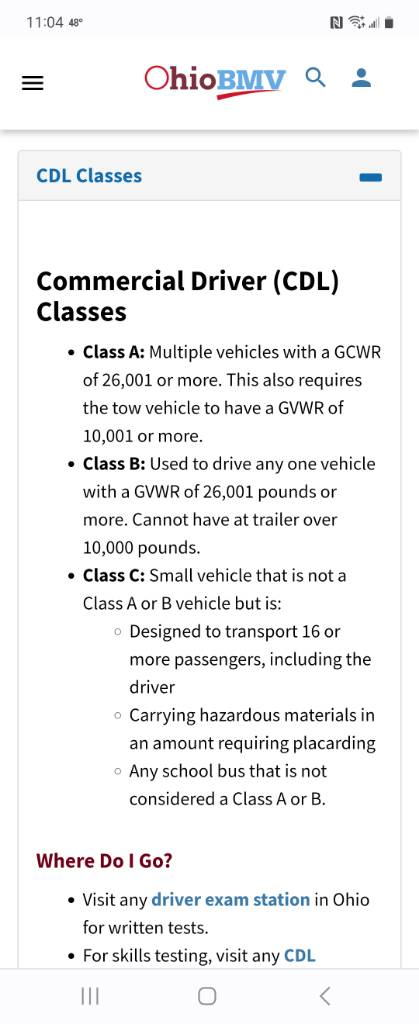

You need to reread the requirements for taking a CDL test in Illinois. There is no way to take a CDL test with a pick up and trailer and receive a class A with air brake endorsement. They also distinguish between a CDL with an automatic transmission or a manual transmission. There is also a distinction between having an air brake endorsement which would be a class a license, and a non-airbrake endorsement, which would be a semi truck with out airbrakes. A class B license.
Please reread your information before giving more advice.
You need to read my post again because I said minus air brake endorsement, and there is no way for a pickup to get class B because the tow vehicle is under 26K with or without air brakes. Class B is tow vehicles over 26K with trailer under 10K. Has nothing to do with air brakes or not. Class A is combination over 26K trailer over 10K. Pickup/trailer combination would be class A with L restriction,

So I have a SRW Ram 3500 with a GVWR of 11,700, trailer max of 17,300 and a GCWR of 25,300 and I have a GN trailer with a GVWR of 18,000. So can I take the test with that combo? Get a CDL-A for no air-brake, automatic only and no 5th wheel? Or will they laugh at me?
From just reading my state CDL website I would say no due to verified GCWR under 26K.
My truck is 11,700 and my trailer is 18,000. 29,700 total rating…. Capacity 25,300.
