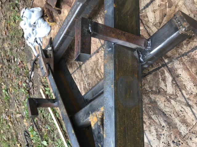

#28

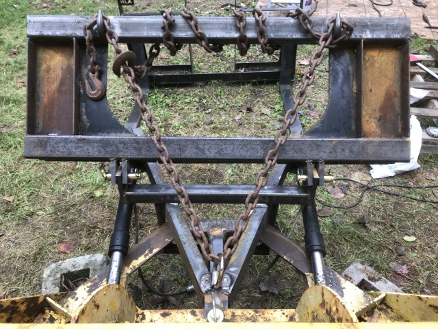

Hey Folks - Happy Thanksgiving from Canada (yeah - we're not on the same timeline...)
Back to report some more progress on the plow. Completion in fact with the exception of hydraulics and painting...
So today's tasks were:

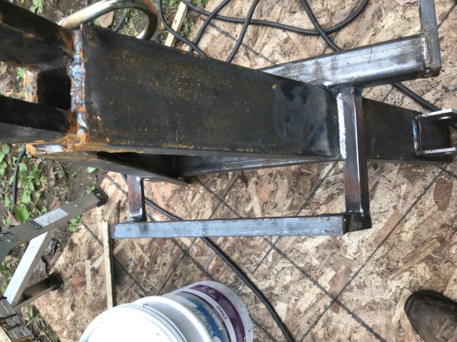

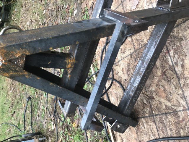

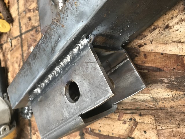

Weld the rear holders for the hydraulics on:

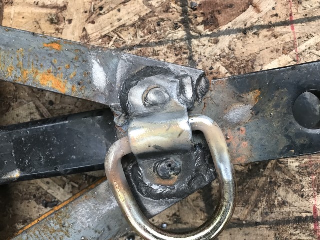

Weld the d-ring on where the chain will lift the plow:

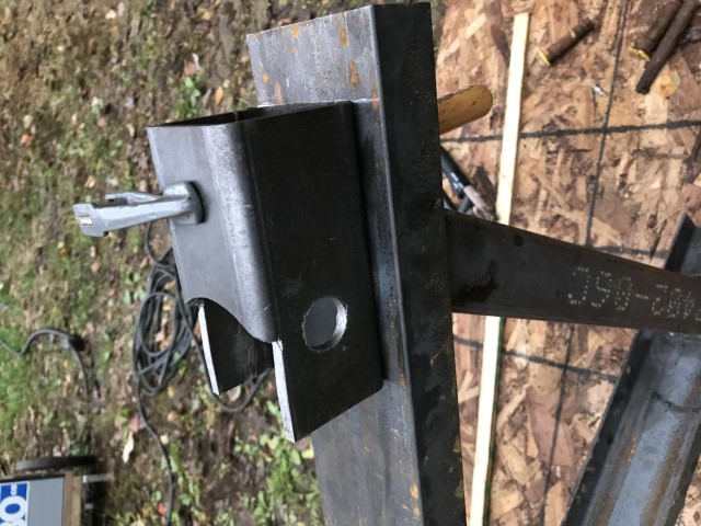

Attach the top crossbar where the plow\plate will pivot, and weld a support from the bottom for when back-blading:

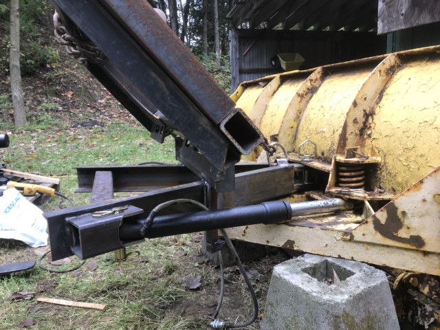

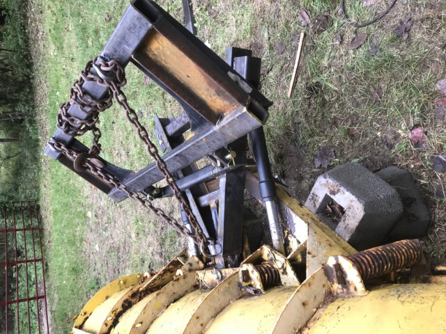

Weld on the grab hooks, pin it together, and chain it up. The chain is one of my spare tow chains for now - I'll purchase a more appropriate length later:

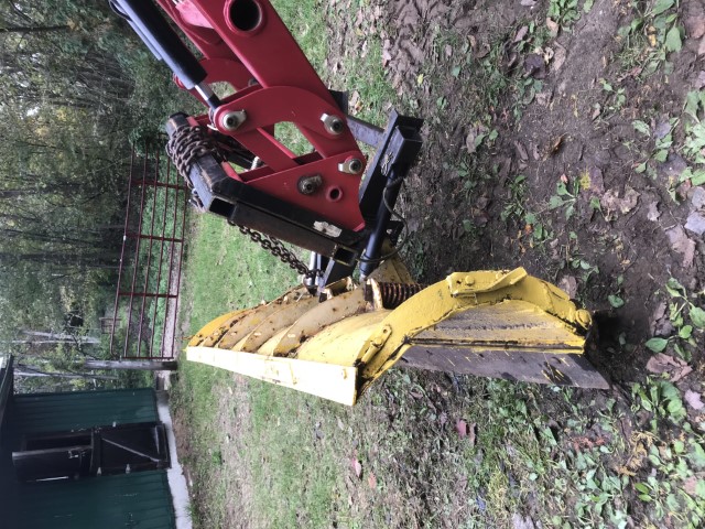

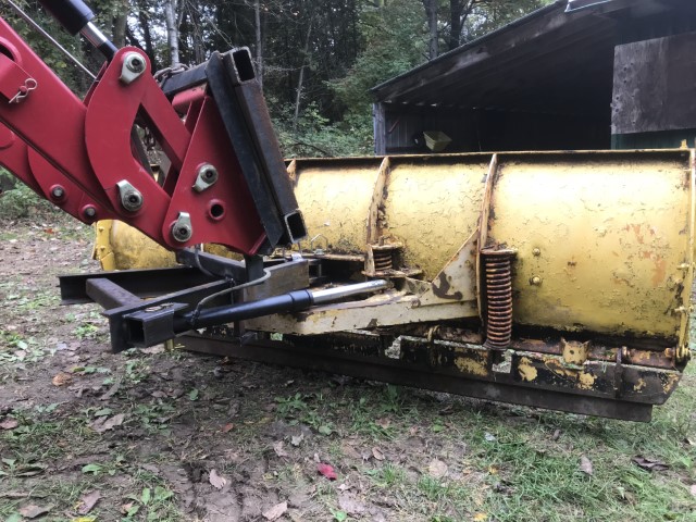

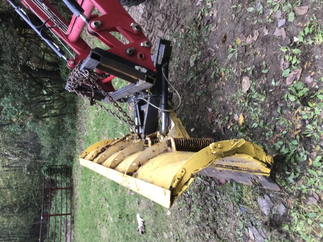

Right - that all seems to look ok - time to try it out on the tractor:
I don't have the parts to hook up the hydraulics at the moment ($$!) - so after purging the air from the cylinders, I simply connected them to each other. I'm able to easily manually pivot the blade when it's in the air. If I don't get to the hydraulics this year - I'm simply going to put a ball valve between the two cylinders. Open it to pivot - close it to lock in place.
Thanks to everyone for all of your help. Your assistance was appreciated (not to mention needed!)
Sean.

For anyone interested - total build cost was about $600 including the plow.

   / Truck snow plow to Tractor SSQA Conversion #30
Looks good and usable, I would cleanup the angles and brackets off the face of the plow,
maybe even fresh paint to slick up the face so the snow will slid off it easier.
Nice to get a functional blade for a moderate cost.
