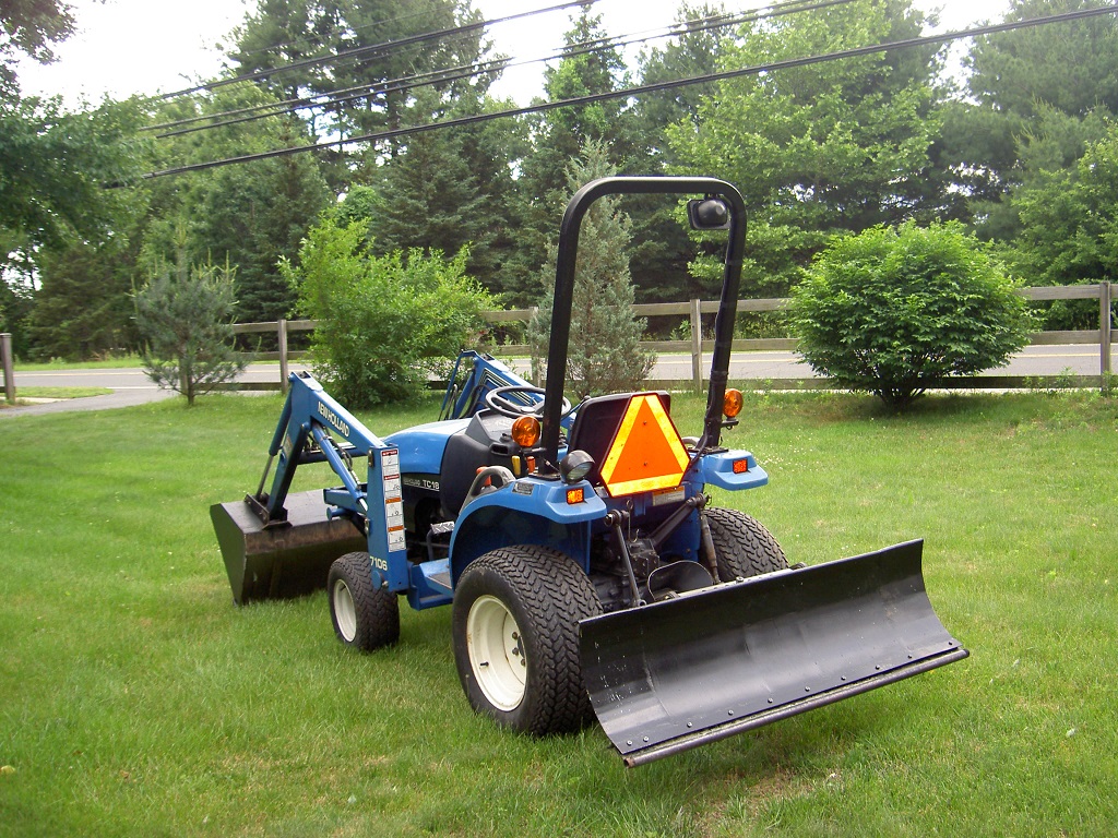

When my gravel/dirt driveway is not froze it is usually soft enough that the standard shoes don't hold the blade up, the shoes actually cut right into the driveway.
I either back blade with the snow plows or I use my 3 pt backblade and turn it so it runs backward to try and push the snow without scrapping gravel off.
Once its frozen hard I run without shoes and let the blade scrap clean.
Just a quick note,
When I say back blading I am not using a back drag blade on my plow, I am using my main blade backwards so the angle of the blade is not digging in..
but is sliding over the driveway.

Got it - thanks - that makes sense. The most important messages I got from your first reply were - 1) When the driveway is soft, the shoes don't do anything, blade still digs. 2) When the driveway is frozen, the shoes don't do anything, blade rides fine without them. Therefore - ditch the shoes and keep the back blade! :)
I still have the blower on the back of the tractor, and I have the hydraulic top link. At the start of the season, I simply tilt the blower upwards so it rides up more. Once everything is frozen, I tilt it to dig in more. Periodically I'd need to scrape the laneway with the bucket to get rid of some buildup.
I'm adding the blade this year since I snagged one so cheap ($150). Last year we got a lot of small snow falls that were a pain to do with the blower - backing all the way down the laneway and back again - but would be super quick work with a blade on the front. Best of both worlds now.

Looks good. I don't have shoes for my gravel driveway either. It sometimes digs in here and there but not usually in the driveway section. I would prefer the backblade over the shoes. It's a bit rough until things are frozen with a nice layer of packed down snow. Having a blade is great for speed and pushing banks out.

I was reading the discussion on the plow shoes. I have a loooong gravel drive too in northern VT. I also back drag with the snow plow if the road is soft and I do it also early even when frozen until I have I have a smooth hard surface to run the blade on, Because I have numerous rough spots from the tops of boulders that stick up a little here and there. Often we get some rain in the winter, especially lately it seems, and the road turns to a ribbon of ice. I don't sand. It is way cheaper and easier to run good winter studded tires on the wife's CRV and my p/u. I run chains on the plow truck - a 1 ton dually. Anyway, when the road turns to ice I put on the plow shoes to hold the blade up a little so I leave an 1" or 1-1/2" of snow on top of the ice when I plow. This thin layer will stick to the ice much better and easier than deeper snow when packed by traffic To turn the road back to a snow road. Just a different way to do it and thought you might be interested.

Looks good! Shorten up that chain by 1/3 or so (between the upper frame and the D ring) and you should be in a better place.

I have a gravel driveway as well and I welded a piece of round black iron pipe to the bottom of the scraper blade, worked great.
It doesn't scrape the black top as nice but wasn't too bad either.
