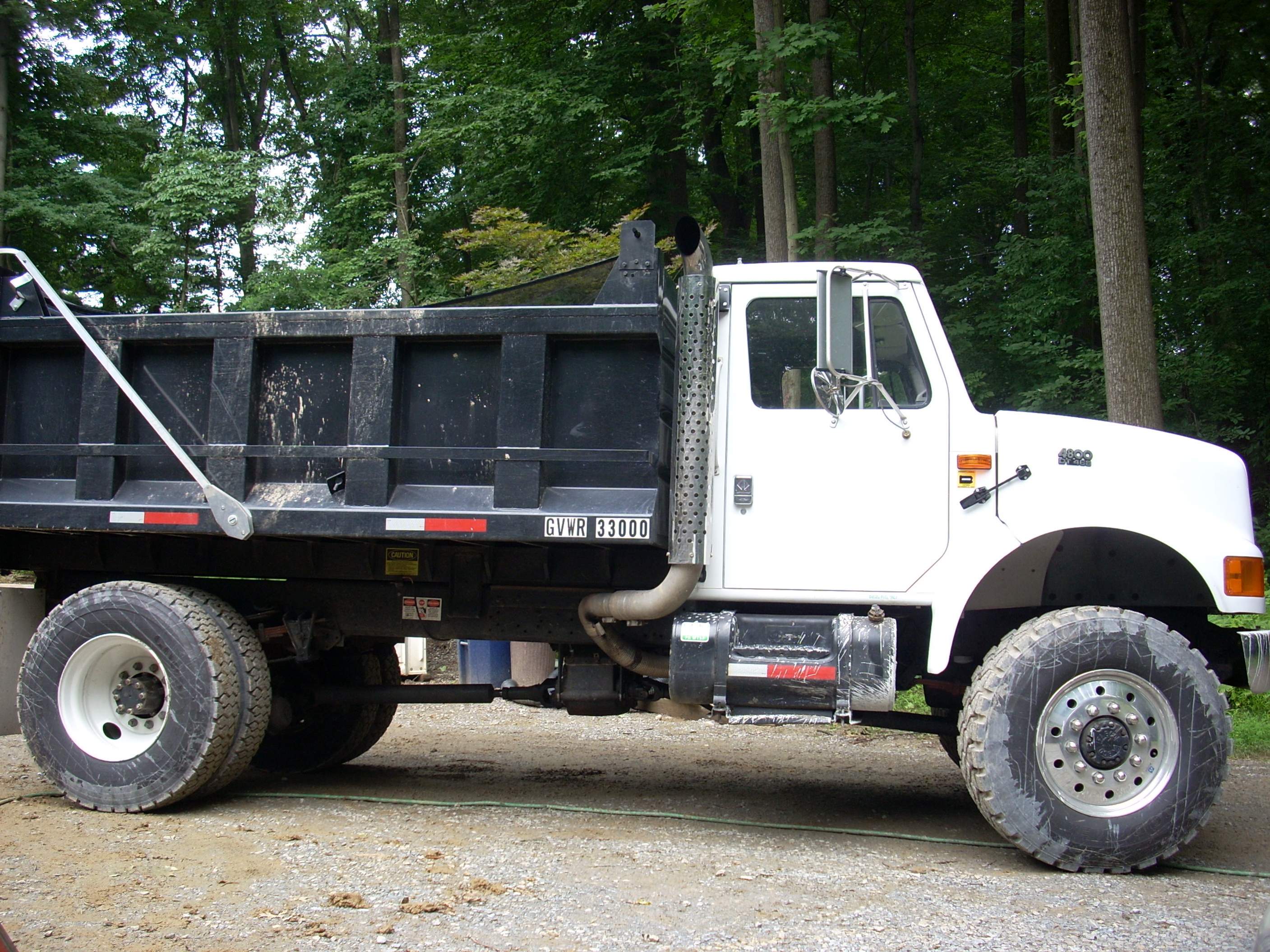

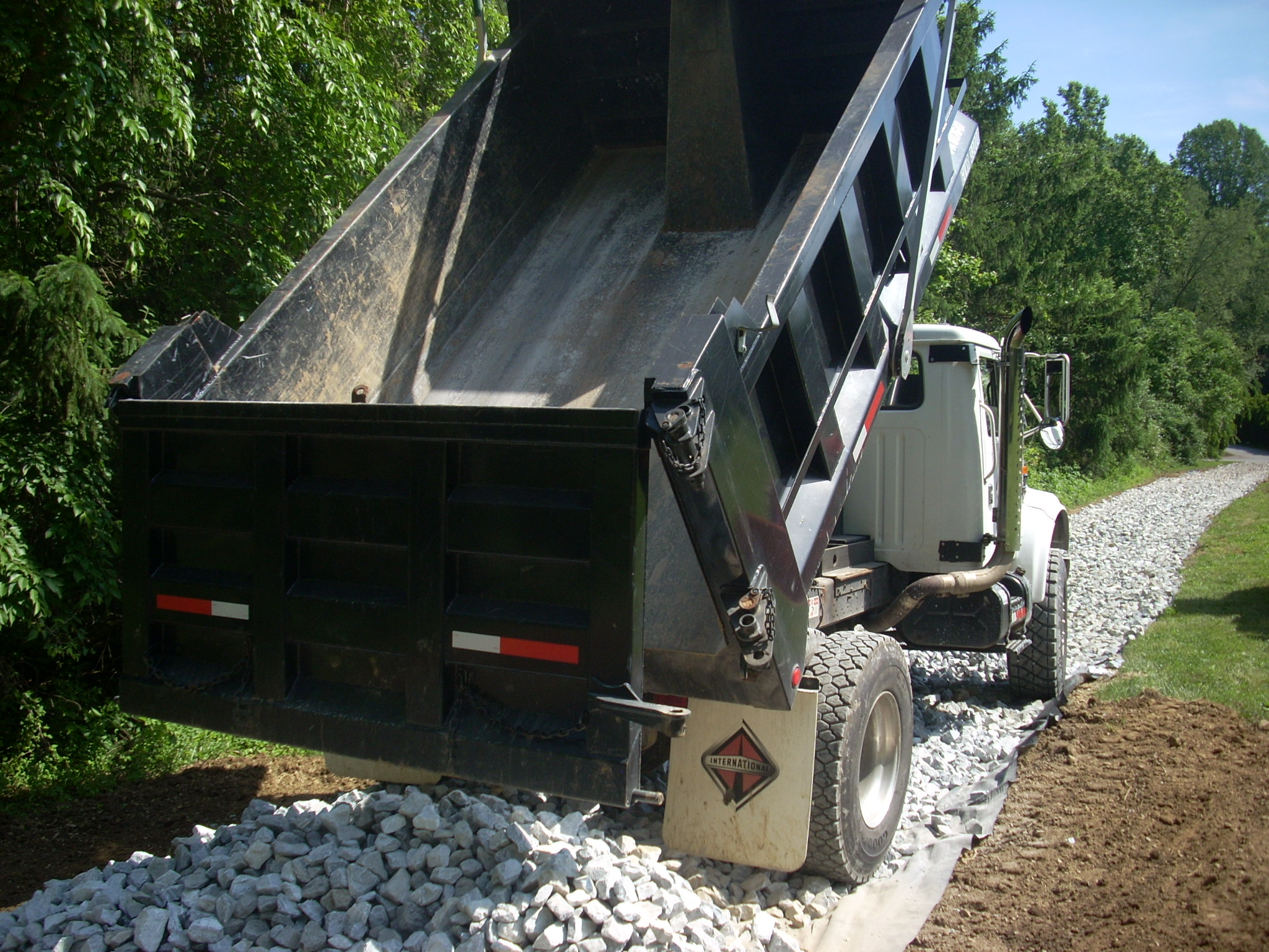

Yup, the sure do. Here's my IH-4800. I think it's a "real truck". Maybe DP can give me the opinion on my IH. I already know my GMC-3500 doesn't qualify. ;)
First picture is from '07. 2nd picture is last summer while installing a driveway. I added Alcoas to the rear wheels.

Nope Builder, that is a real truck:thumbsup:
Chris
/ truck info wanted #16
oh and dont forget your class A, your going to need it ;)
/ truck info wanted #18
Builder, that truck is BA
Thanks. :thumbsup:
It's "real", too. ;)
I actually had to use my "not real" truck to pull the "real truck" out of the mud once last summer. Can you believe the "not real" truck didn't break pulling it out of the mud? The "real" truck was fully loaded, too.
