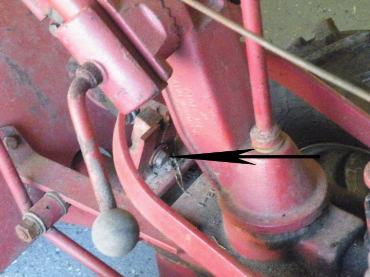

I am watching a friends home while they are away on vacation and he lent me his ancient roto tiller so I could till my garden. Kind of a policy of mine to return borrowed items in better condition than I got them, and this will not be too difficult as the thing is falling apart.

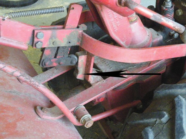

This tiller is so old I cannot find a model #, only a serial # which seems rather useless. All I really want to do right now is tighten the belts because the forward belt is so loose, I cannot even get it to till anything with more resistance than water. The only adjustment I could find was here:
But as you can see on the reverse side:
It is as low as it can go.

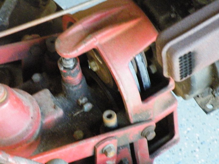

Would swapping the two belts make a difference? (see pics below)
Is there any other way to tighten these belts?
Is there any way to find a manual for this thing online with only a serial # so I can get new belts?
Thanks!

Since it has two belts, I believe it is a two speed Horse. MTD has an on line parts search here: Troy-Bilt - Replacement Parts for Troy-Bilt Mowers, Trimmers and Snow Throwers
In the past, I've bought belts at Tractor Supply.
The serial number is on a tab that is on the side of the transmission housing just under the line of your black arrow. Clean the yuck off and you'll find the serial number.
Since that adjustment block is all the way down, I'd say the belts are stretched beyond further use, and it needs a new set.

Your pictures look like my 1976 Horse. I think "Horse" is your model number. This model requires matched belts. There should be no difference in tension. I recommend you purchase a set of matched belts. The local Belt Warehouse can furnish matched belts at a lower price than MTD. If you take the belts to a Belt Warehouse you would want to match the belt that is tighter. Of course it's possible that neither belt is correct, so you may want to order from MTD
Also. check the roller. The roller and the hole in the roller and the pin through the hole will wear out. My guess is yours should be replaced. The roller block will probably last forever. MTD sells a retro kit.

Swapped belts, did no good..
/ Troy Built... Horse? #8
If the belts are stretched, it does no good to swap them, and from the looks of the adjustment block, those belts are either stretched or the wrong ones.
Based on your serial no., I think you're looking for belt no. 1128 for a two speed Horse. Part Finder

Just wanted to wrap this up. The belts came in (2 day delivery!). I found the manual here (Horse I). I didn't follow the directions to remove the belts, well, I just cut the old belts off.
Getting the new belts on is not a walk in park. The real problem is that there is no good way to describe it lol. You have to loosen the little metal block that adjusts the tension on the belts, in fact I just removed it. It is located on the pivot point of the shifter. Basically, put the thing in neutral, slide both belts on the TOP pulley and slide them both all the way towards the engine, then work the first belt furthest from the engine back (away from engine) and get it on the first pulley (furthest from engine). It takes a bit and if you can get a helper to move the shifter (watch your fingers!) you can get it. I also found putting a wrench on the bolt on the top pulley helped spin the pulleys making it easier to get the belts on.
Once you get the belts on, it is time to put that metal block back on but set it so the tension is more loose than it was with the old belts. The new belts are much tighter than the old and you take a chance of starting it and it taking off, even if you think you have it in neutral. If you find the belt is still too loose, adjust it tighter (with the engine off). I put it on basically the lowest setting I could.
It worked GREAT. Darn thing tore through the garden like water. It was an AMAZING difference.
