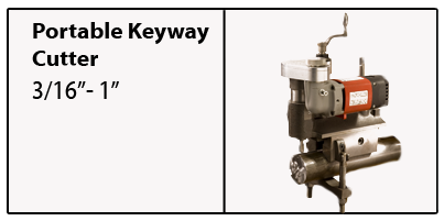

I do have a question however and that is, I want to know how you'd 'machine a keyway' in a crankshaft on an assembled engine, I'm puzzled over that. I gotta hear that one...

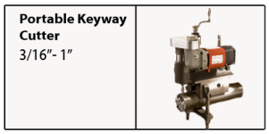

you are correct, there was no scathing editorials, doesn't mean they cant occur, I was just trying to be humorous, and to let people know I am not worried about tone, just to learn, no matter what form it comes. anyways, yes clamping a mounted drive shaft properly on a mill would suck, using a clam- on key way cutter would be better, if you can get the clearance, or even hand cutting a key way is also possible, or go with grub screws. with a matched inlet on the shaft.
but thankfully that is not my only option. which is why I posted the info I did, to get feedback. so thanks
Do you have a link to a 'clamp on keyway cutter' that I can see? Reason I ask is, I'm a Journeyman Tool and Die Maker and I own and operate a short run machine and fabrication shop and I've never seen one so I'm curious. There are only 2 ways I know of to develop a keyway, milling it or broaching it and neither can be applied to an assembled engine.
Just curious and I'm always open to new ideas.
   / Troy-Bilt Horse engine swap #79
Maybe something like this:
From:
Portable Bore Repair - Portable Wedling
Bruce
   / Troy-Bilt Horse engine swap #80
That's pretty cool, I wonder how well that works
