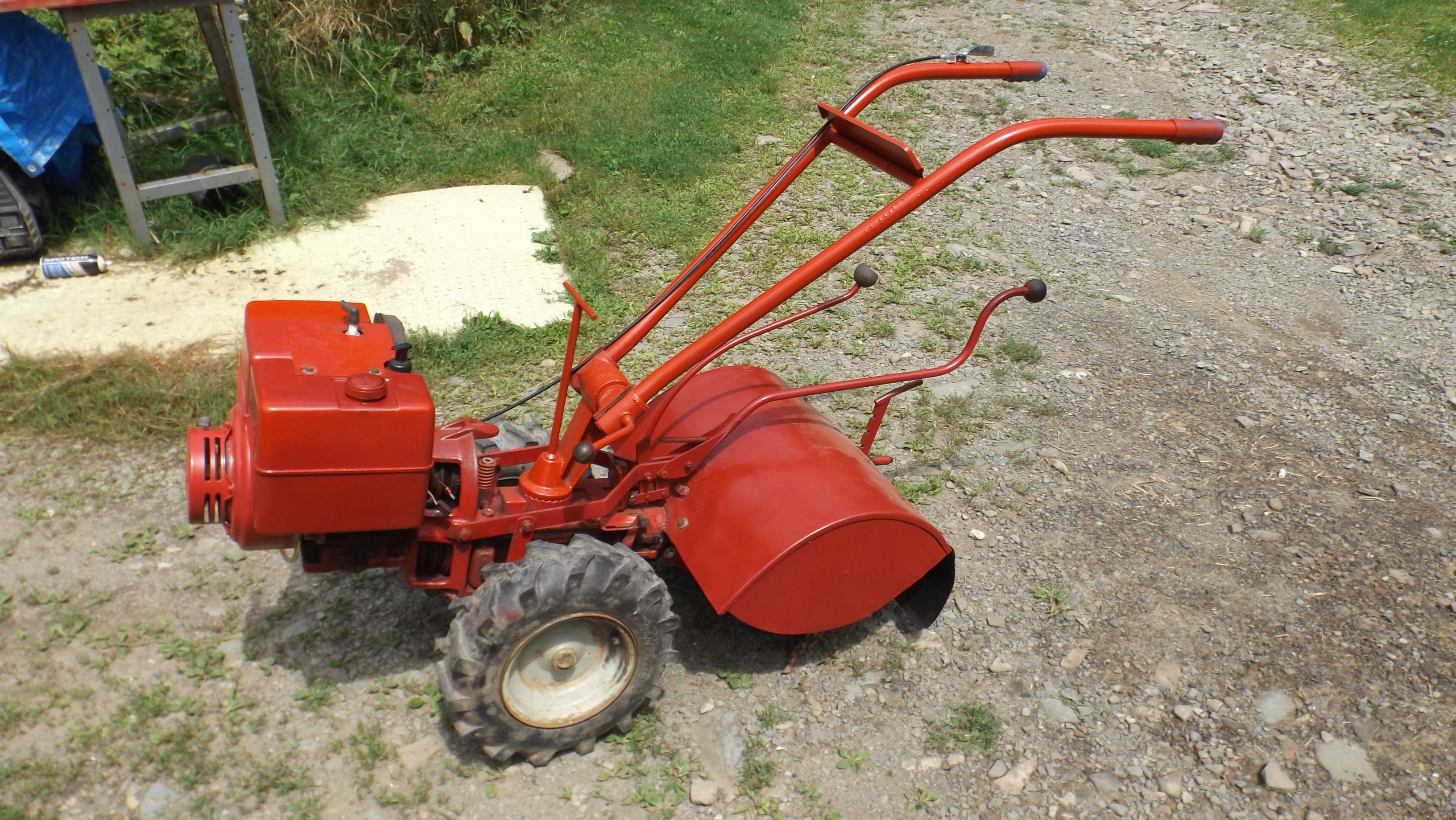

i have a troy bilt horse tiller..i can't find the model number anywhere and nobody around here can tell me..HELP!.i need either the model # or the reverse belt size (i need the reverse belt)..can send pix if you email me @ klkokkonen@yahoo.com

I have one, about 30 years old. It does not use a belt for reverse. Reversing is done by lifting part of the assembly to loosen the drive belt and driving the transmission directly on a rubber rimmed disc attached to the drive pulley. The only belt listed in the parts list is part number 9245, called the forward drive belt. That disc part number is 1919. The manual refers only to "PTO Horse Model," no number that I can find.
/ TROY BILT HORSE BELTS #3
Like Reb said no reverse belt, rubber disc is reverse. the model number was on a sticker on the rear of the tine cover. Parts numbers listed are still available just put a GW- in front of the part numbers.

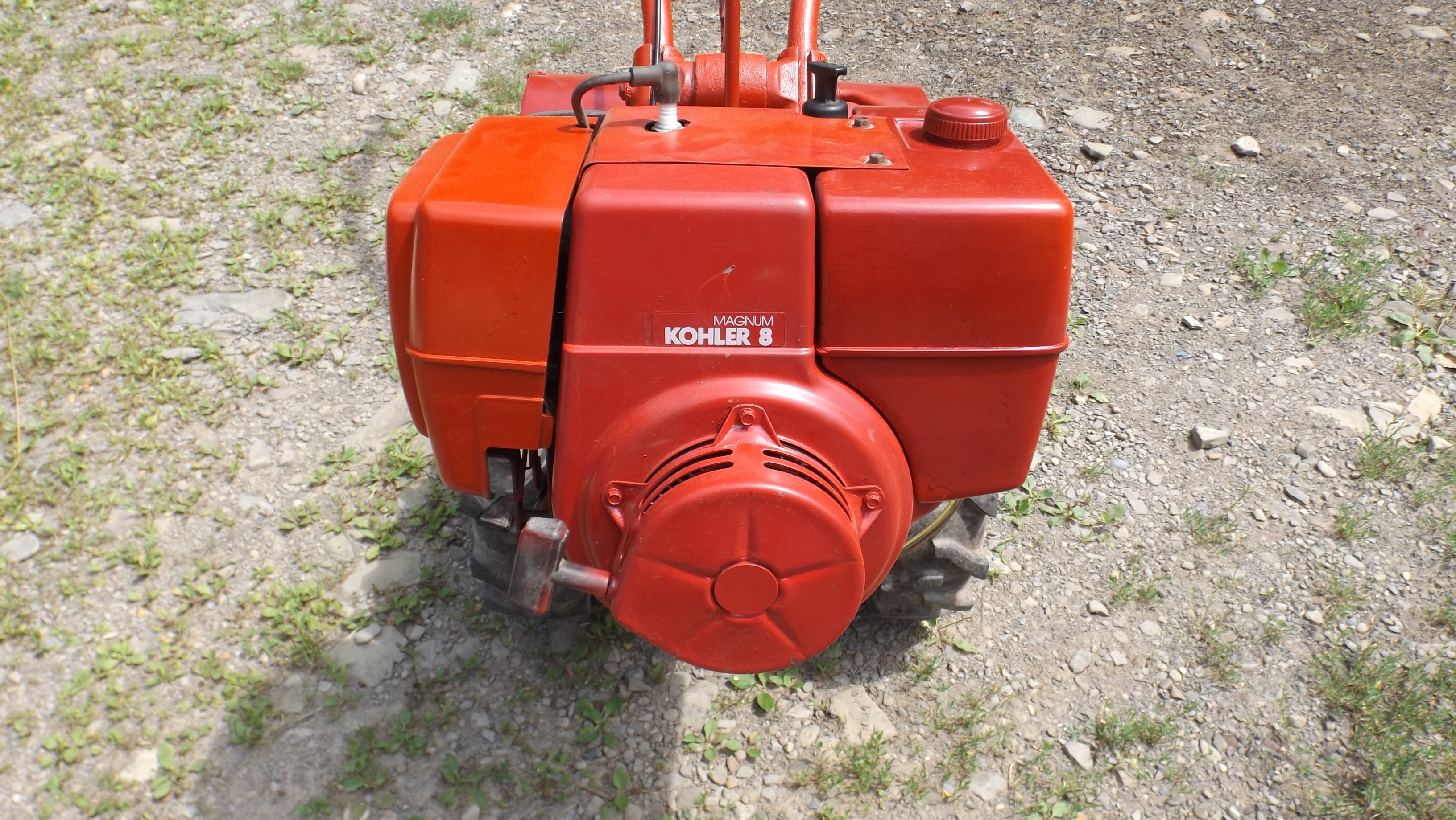

Everyone is giving you the correct advice. I have the Tecumseh engine but sure do like the Kohler like you have. Yours seems to be a repaint but still looks good. Very nice.

THANKS EVERYBODY!..just ordered the friction disc (which it uses) on that "E-BA" websight,for 17.00..my local shop wanted 65.00 for the "kit"(?)guess that comes with a bunch of extra parts?..thanks again...k.

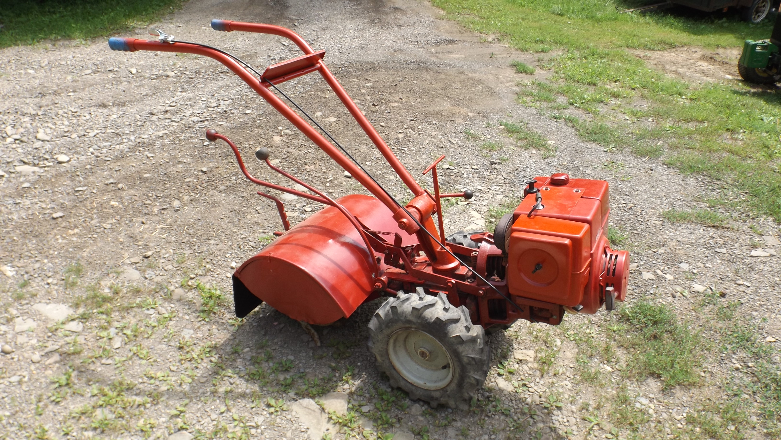

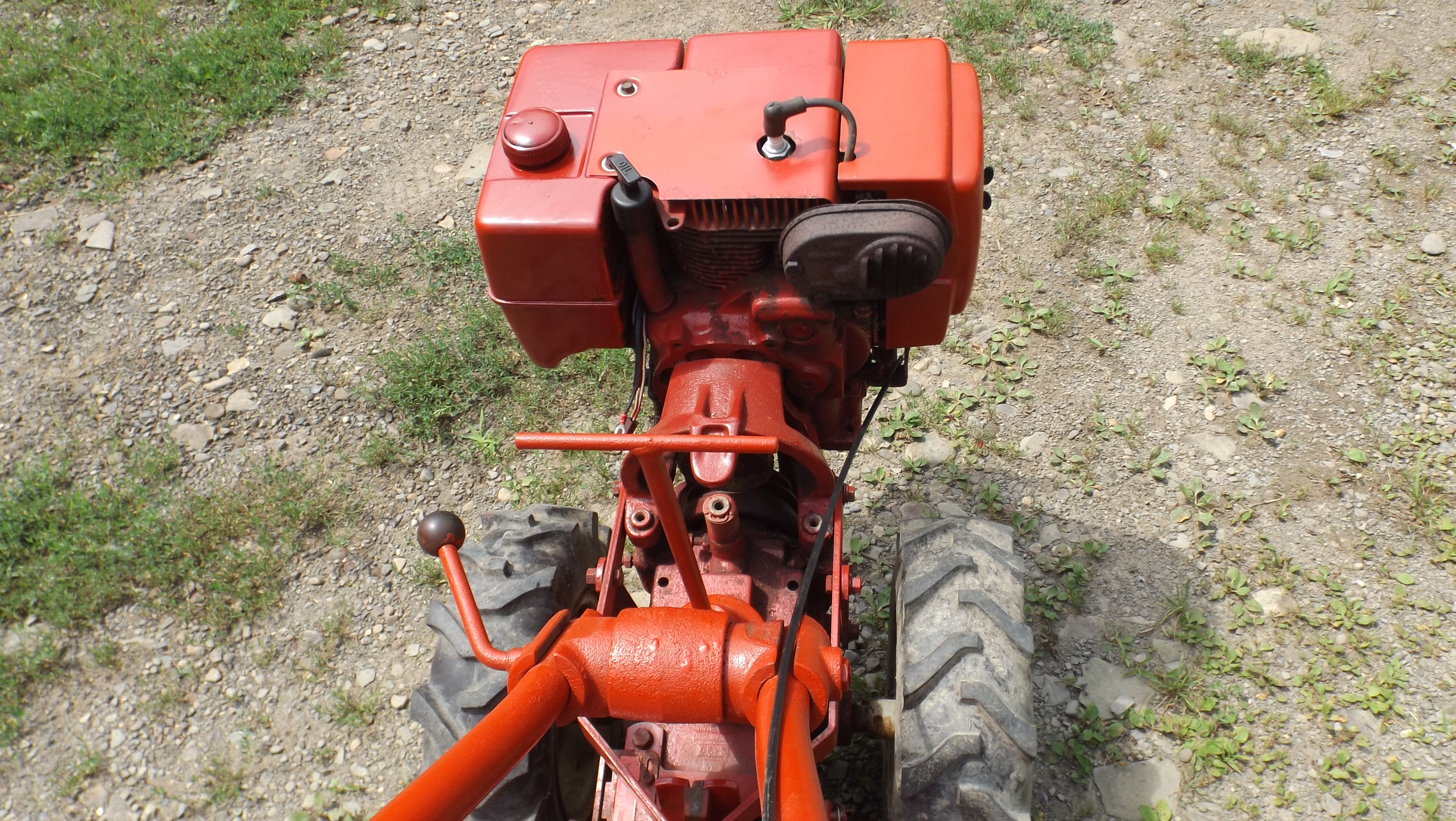

these are "during pictures..i always forget the 'before"..it was a 80.00 yard sale find.
