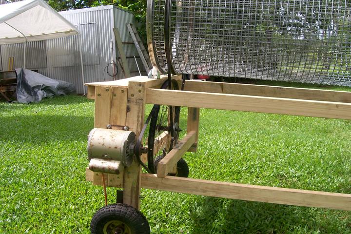

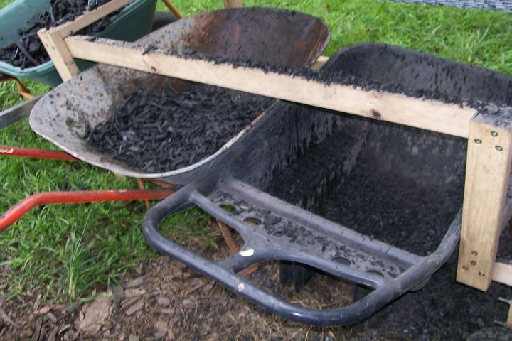

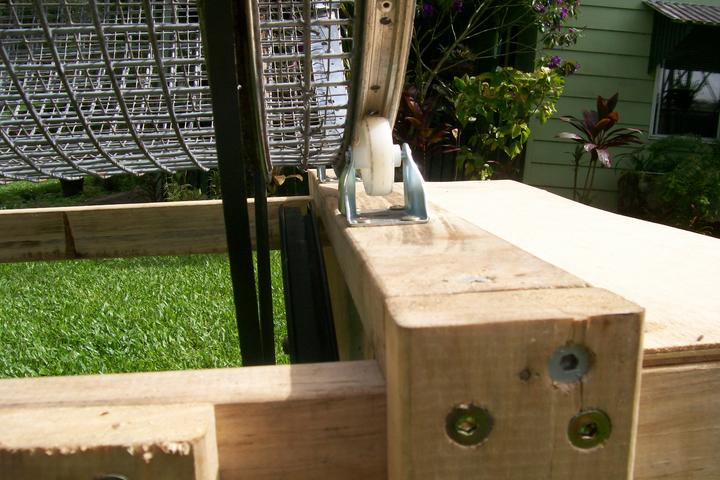

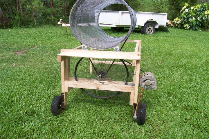

Hello all again, I cannot get the video to work so I'm going to try some pics.
I ran it today and it worked well. It does about 13 rpm and I wanted it slow so as not to make too much dust. It feeds into 3 wheelbarrows.One for fines for a garden a mix,one for medium for potting for the orchidists and one for lumps for cooking on grills.
It is nothing new but I've reduced the framework by using the belt drive to help hold the barrel down, this also makes servicing (belts) easier.
Regards Vince.

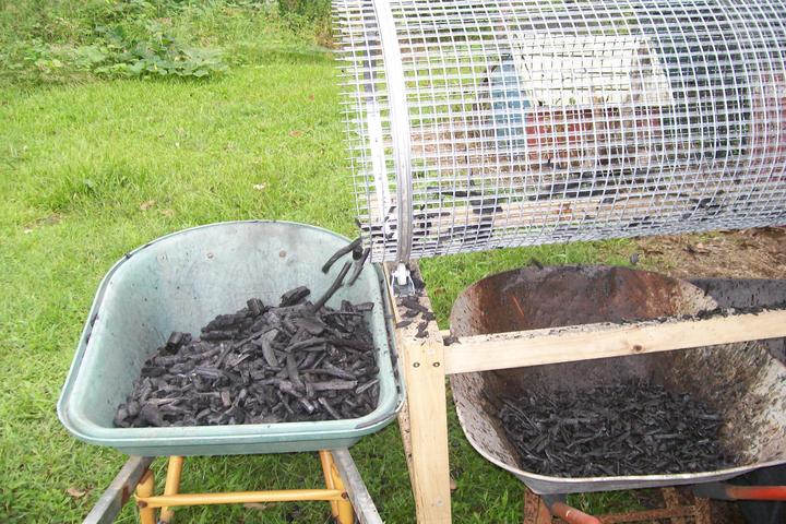

Hello Massy 1635.
Unlike others who may use them to sort soil and /or stones I use it to sort my charcoal into 3 sizes. I have no luck with movies so i will try to post a couple of pics.

Forgive my ignorance but does the mesh change size 1/2 way along?
Looks like an item that will have more uses than you probably envisaged.
Are those cycle rims on each end of the drum?

allenr... yes I used 1 inch welded mesh throughout (5 ft. long) and overlaid 1/2inch mesh (very fine wire) over the first half to get three sizes of product.
The outer rims are 700 c from the salvage shop at the tip and the other (driven) is a 27" rim from same source, because this was a tad larger I had to cut a piece out to make it fit. All are tied on with tie wire.
I replaced the cluster on the complete wheel with an aluminum pully machined to fit the hub thread.

What a great idea. I have never seen a multi stage trommel.
Did you have to experiment with different tilt angles at all?
/ trommel
#12
Hello Ledge End, Re angle.
No , No science involved. I just built it with equal legs on a flat slab of cement(easiest) Then I added the wheels knowing I could always lop a bit off the
other legs if needed.(or dig a hole) (or use some bricks) I'm sure different product would need different angles. One strange thing, some of the bigger pieces actually work their way to the High end and fall out,this must be a bit like a flat belt drive travelling to the high point.
