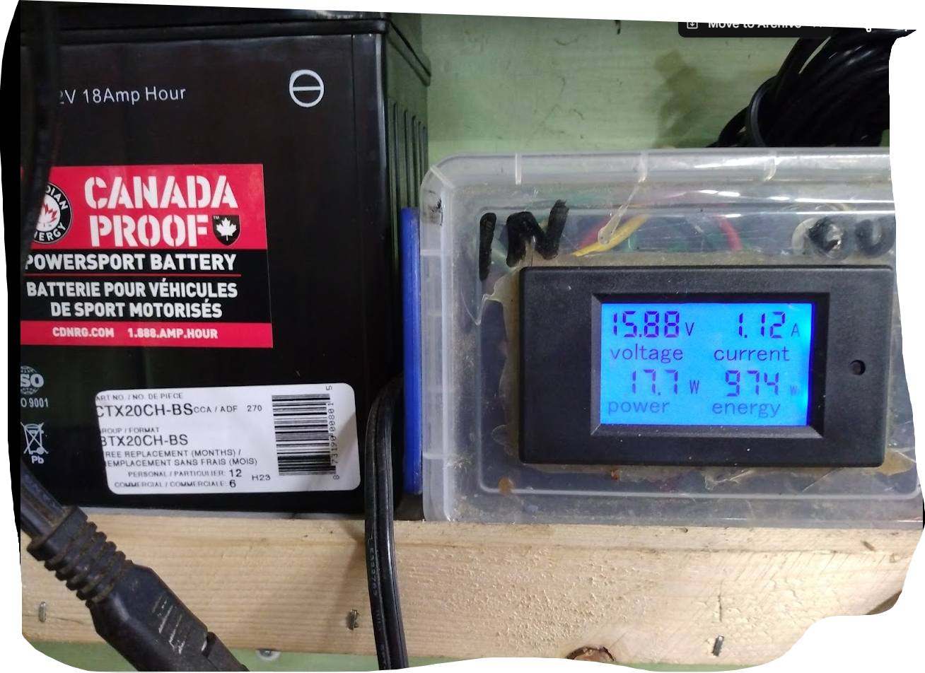

I used to swear by Schumacher maintainers but the latest one I bought boiled a new AGM battery dry on my bike. They sent me a replacement that tried to do the same thing but this time I had a volt/milliamp meter on it. Showing almost 16 V and over 1A on a totally charged new battery, you could hear it and smell it. I wrote them complaining about it, all I got in return was the sound of crickets so never again Schumacher.
Saying that, I have 2 Schumachers that are over 10 years old and weigh a ton, compared to the new all electronic crap.
My go to now are Battery Tender brand so here's hoping they're better.
