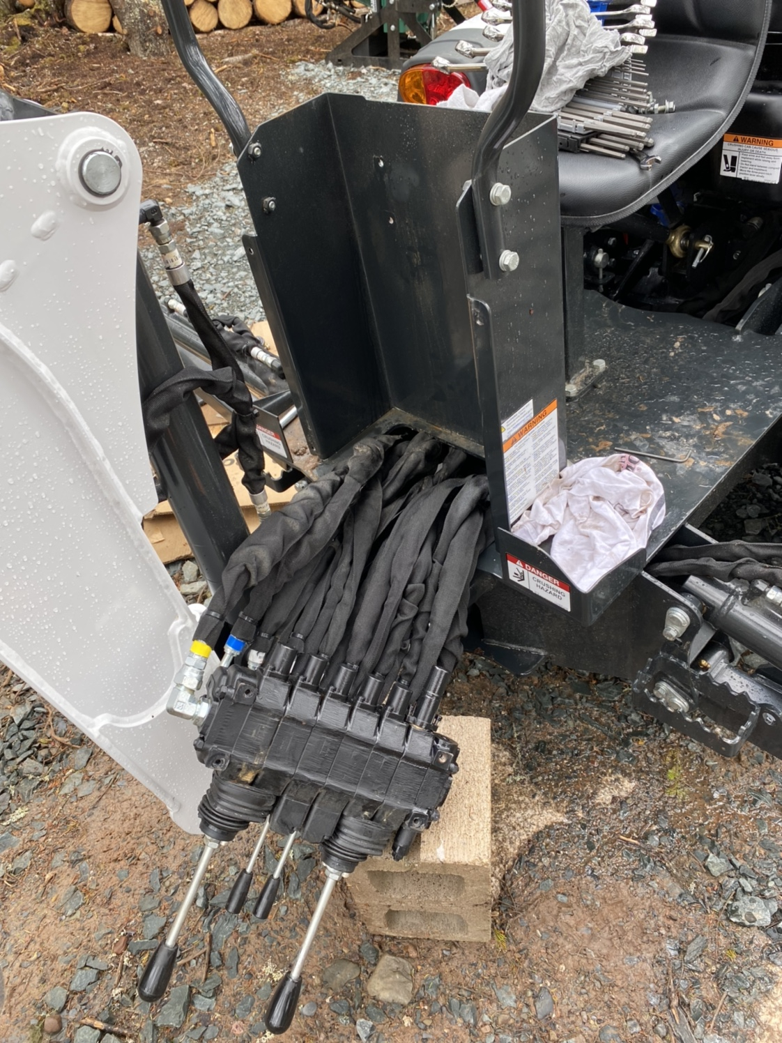

   / Trick to keep quick connections locked together?
Red and yellow hoses stayed connected which are the ones completing the loop. Blue hose which is the used oil return is the one that popped off and the pressure blew the cover off the valve on the back side of the main boom lever. Now moving any lever in any direction blows out out this leak.

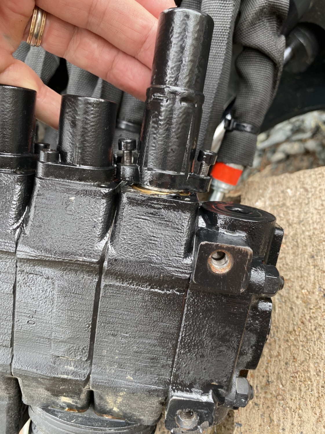

   / Trick to keep quick connections locked together? #9
View attachment 700934View attachment 700935
Note the cap screws did not come if the holes, though they did get bent when the ears cracked on the cover. This was just me investigating to see if I can repair on site and what parts are needed.
Is that the oring poking out?
   / Trick to keep quick connections locked together? #10
Something is wrong. Connectors don’t just pop apart.
