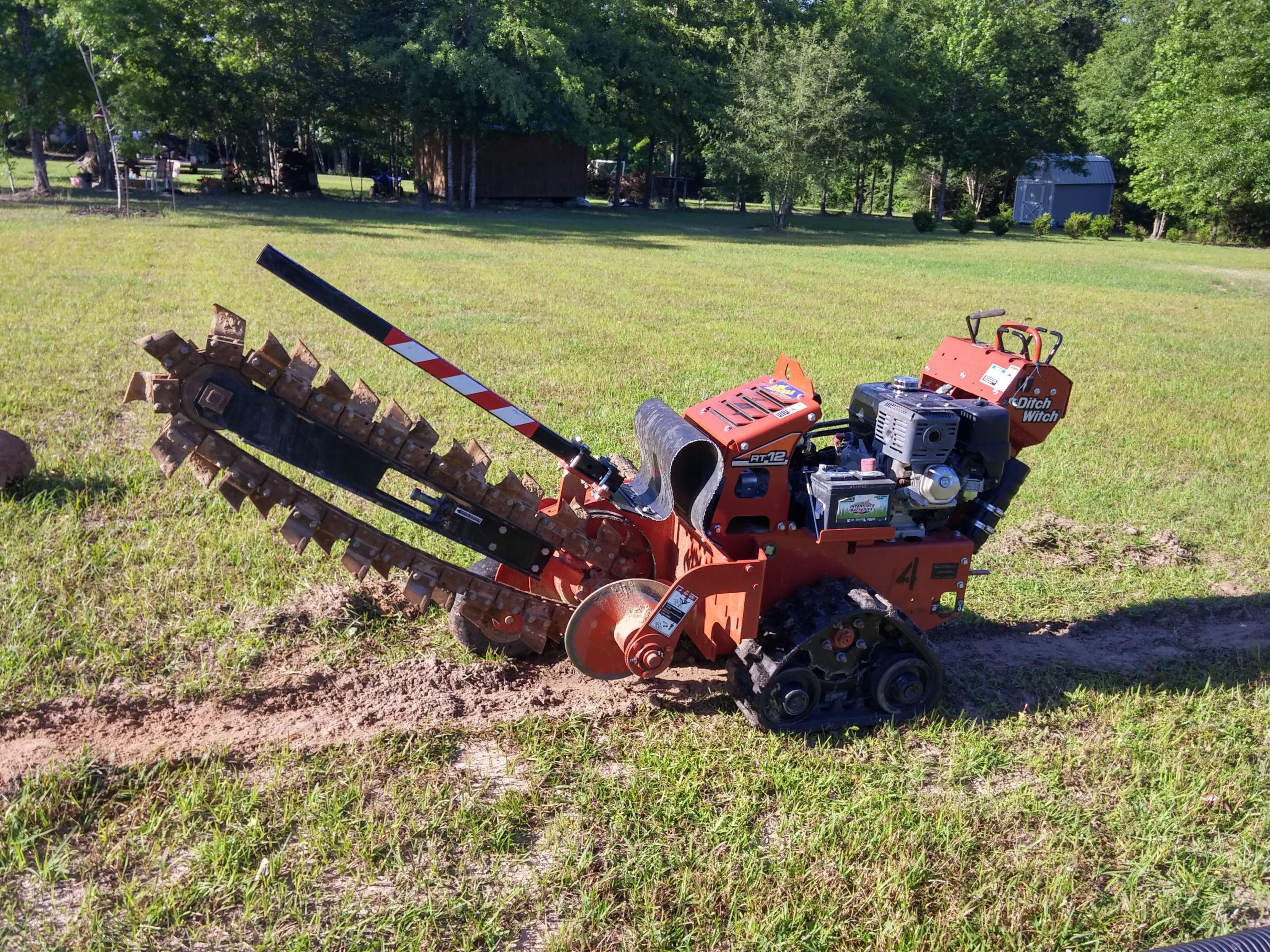

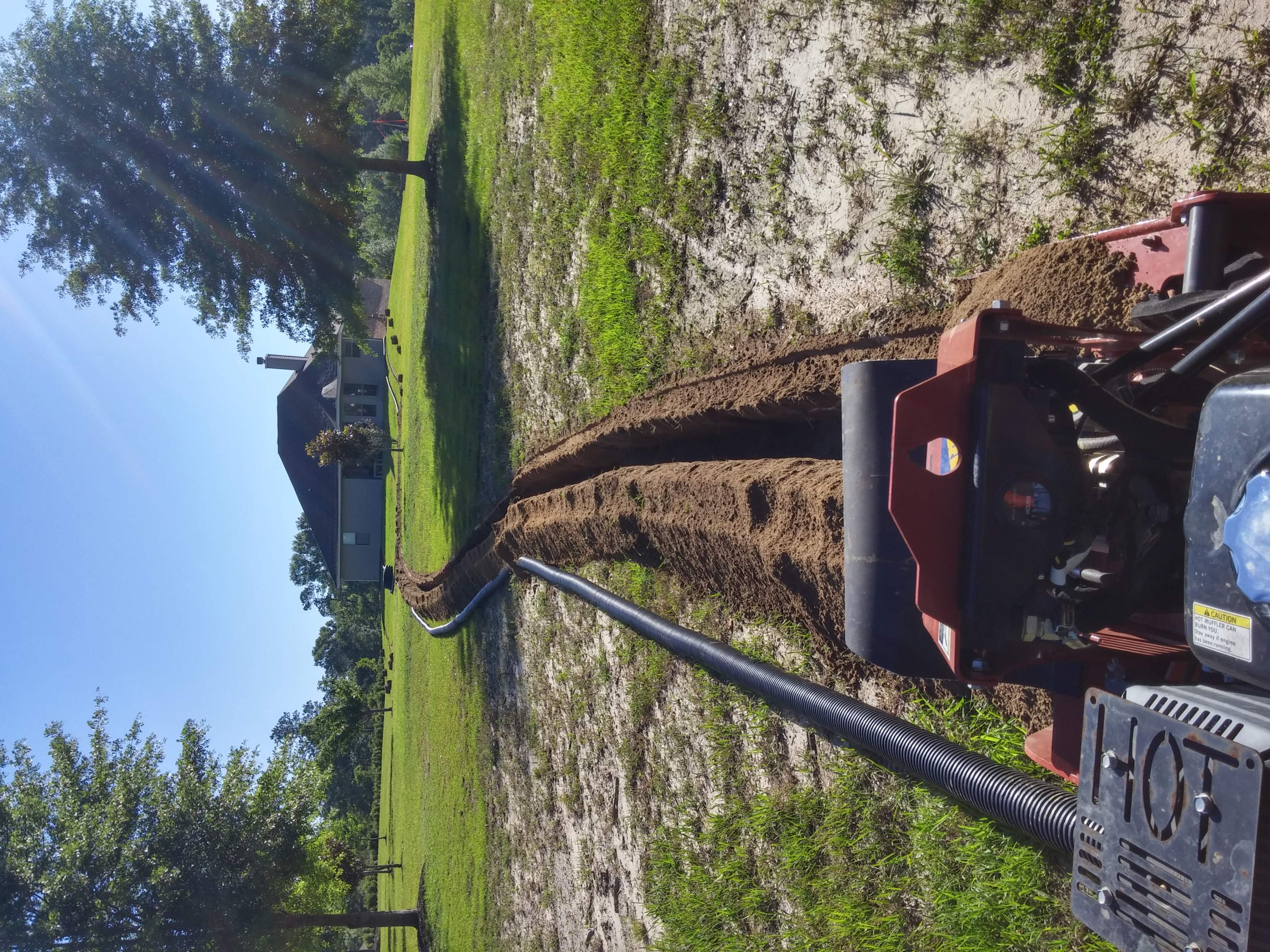

<img src="http://www.tractorbynet.com/forums/files/attachments/425023-trenching-20150502_085223_hdr-jpg"/>
550 feet in 45 min. 18" deep, 6" wide.
<img src="http://www.tractorbynet.com/forums/files/attachments/425024-trenching-20150502_083651_hdr-jpg"/>
$125 for the day.
Work smarter. Not harder.

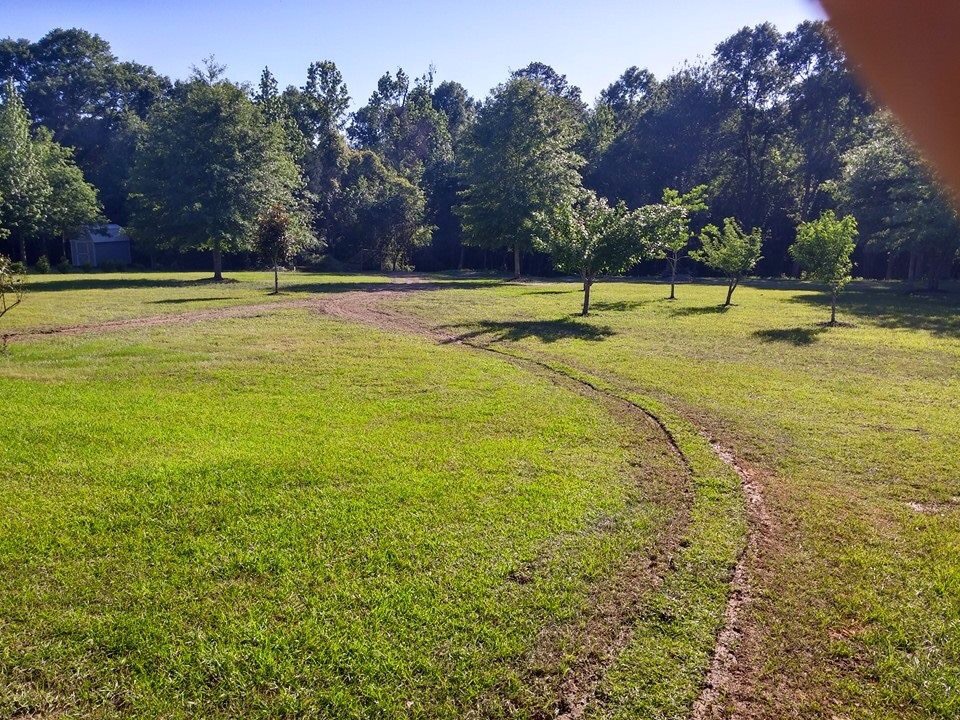

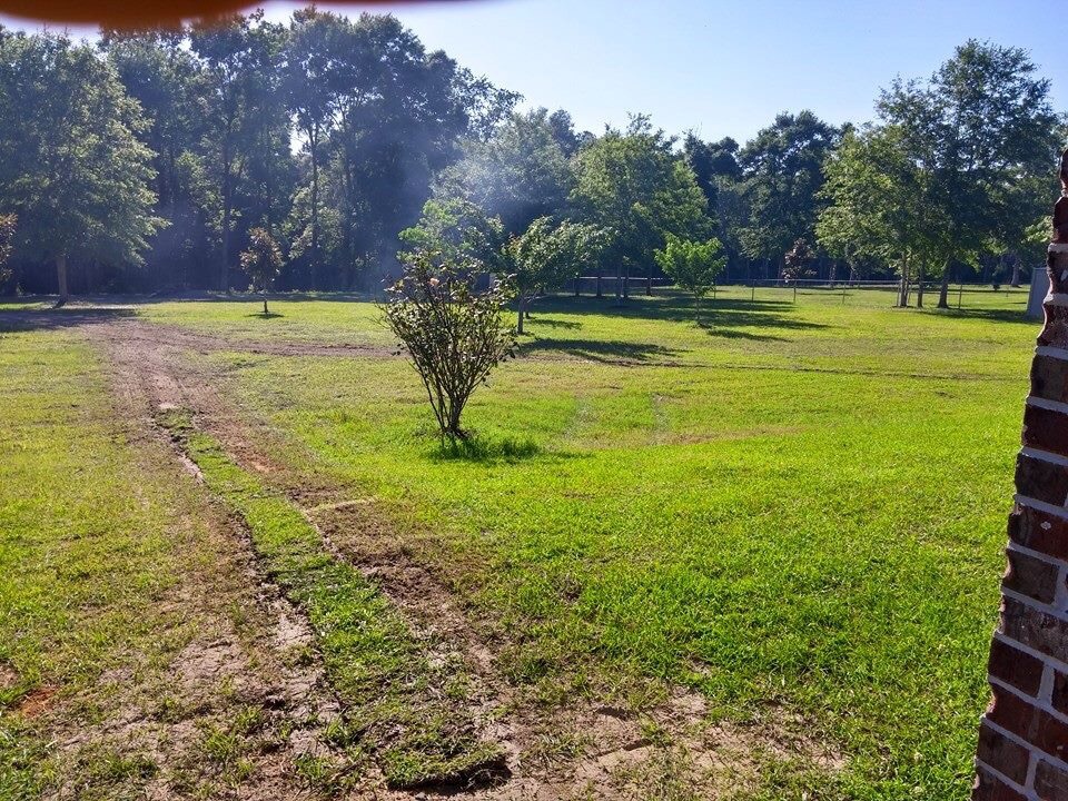

Finished project. If going across finished lawn, rent a sod cutter and cut your path you want to trench. Roll up the sod, dig your trench, backfill and the just roll the sod back over the path.
<img src="http://www.tractorbynet.com/forums/files/attachments/425027-trenching-image-jpg"/>
<img src="http://www.tractorbynet.com/forums/files/attachments/425028-trenching-image-jpg"/>
If there is worry about damaging lawn I recommend a vibratory plow, you won't even be able to tell you were there.

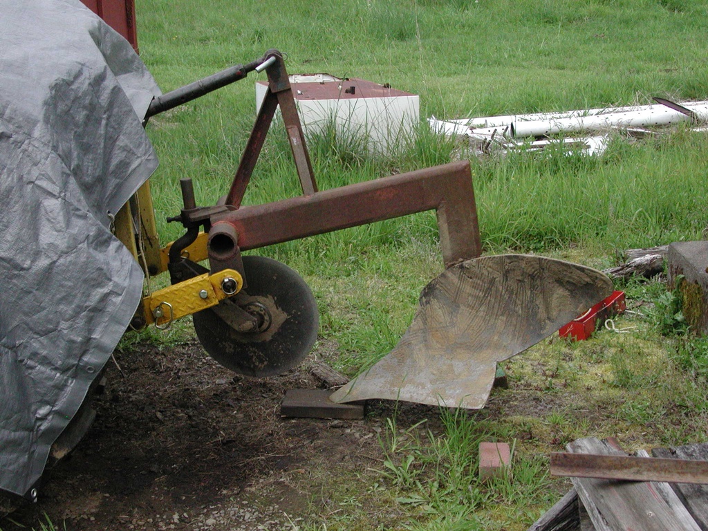

Call a local irrigation contractor with a cable plow , I have one ,150 ft 18 inches in the ground about 15 minutes .
Yep, also some electricians or contractors who install fiberoptic, gas, and electric services for the local utilities will have these machines too if there's a crew in the area
