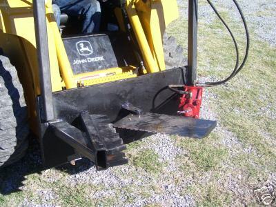

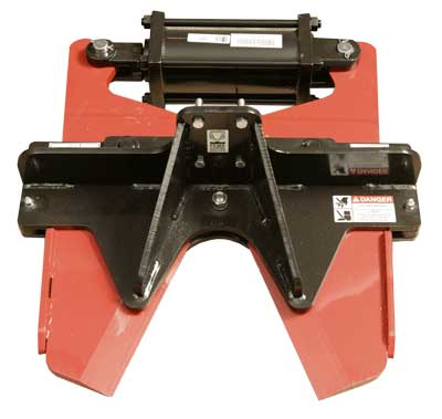

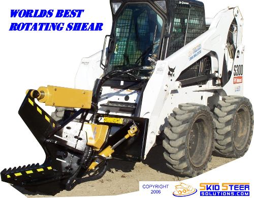

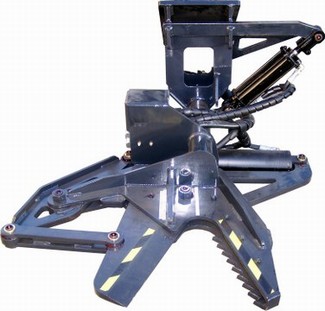

Tree shears.
The last tree cutter, looks fairly simple and tuff. Maybe cost $300 to build.
