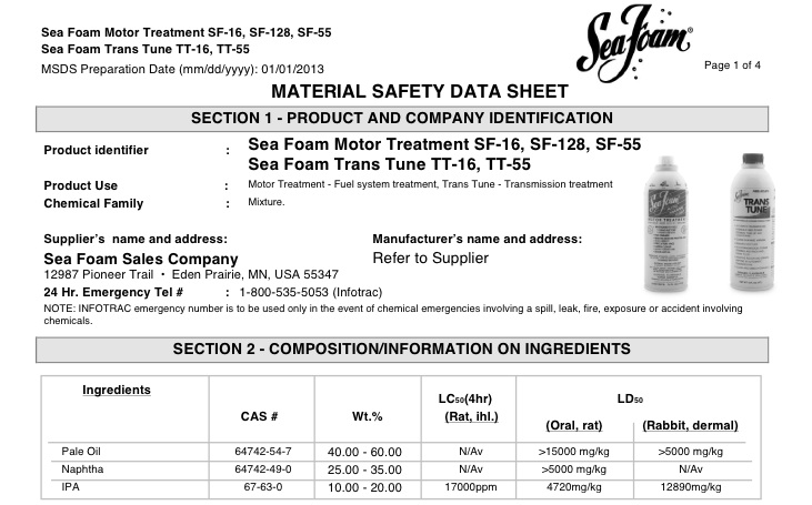

Speaking of sea foam and ethanol free gas.... If you ever smell sea foam, it has that distinctive alcohol smell to it. There are other petrol based products in it, but it smells mainly like isopropyl alcohol.
Are we wasting our money by buying ethanol free gas and then adding sea foam?

What is IPA?
http://seafoamsales.com/wp-content/uploads/2012/12/MSDS_seafoam_EN.pdf
Bruce

IPA is isopropyl alcohol.
Ethanol is also alcohol.
Are we trading out one evil for another?

I wonder if the two alcohols have different solvent and water absorption properties.
Bruce

Did a little research. Ethanol is made from grains, and IPA is made from propane.
In theory, IPA should be much better on the rubber components versus ethanol.
/ tree removal - chaisaw problem, wrog fuel mix #51
Not saying your wrong, and i bet your right about the effect of ipa vs ethanol, but what is your theory based on?
/ tree removal - chaisaw problem, wrog fuel mix #52
The higher alcohols tend to be less corrosive. Methanol>ethanol>propanol>butanol...etc IPA is a propanol
/ tree removal - chaisaw problem, wrog fuel mix #53
Propane is a petroleum by-product. So, mixing it with gas should be safer. I've been trying to do some internet searches, but a lot of people use ethanol and IPA interchangeably. So, not a lot of help there.
