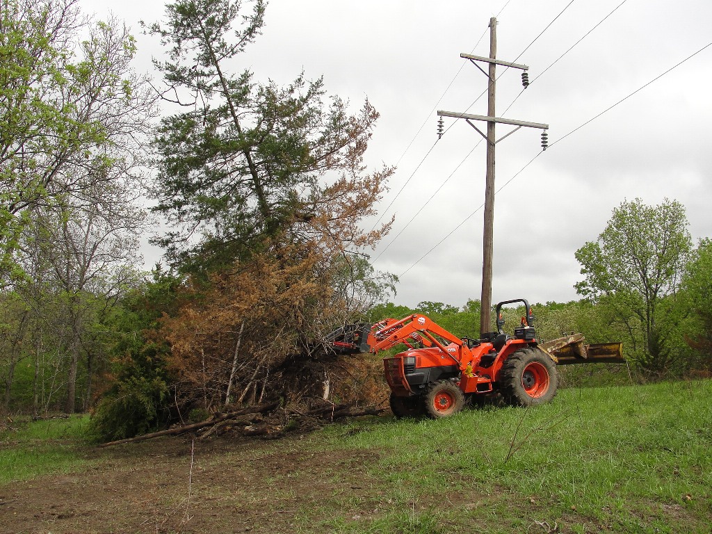

A Puller leaves pits in the ground where you pulled the tree. If you do this at the right time you can shake most of the dirt off the stumps and smooth it pretty well. A puller is generally less expensive and lighter. Several local companies near me build/sell them. They run from $1250 to $2500. Pine trees are very easy to pull. I built my puller and first used it on a Kubota L4400. Worked great. The trees you have described can easily be pulled with your M7040. Here's a pic of my L4400 with a pine tree larger than the ones you described.
