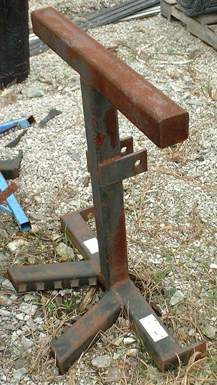

Heres one I got at my local Souther States (Feed Store) for $40!!
