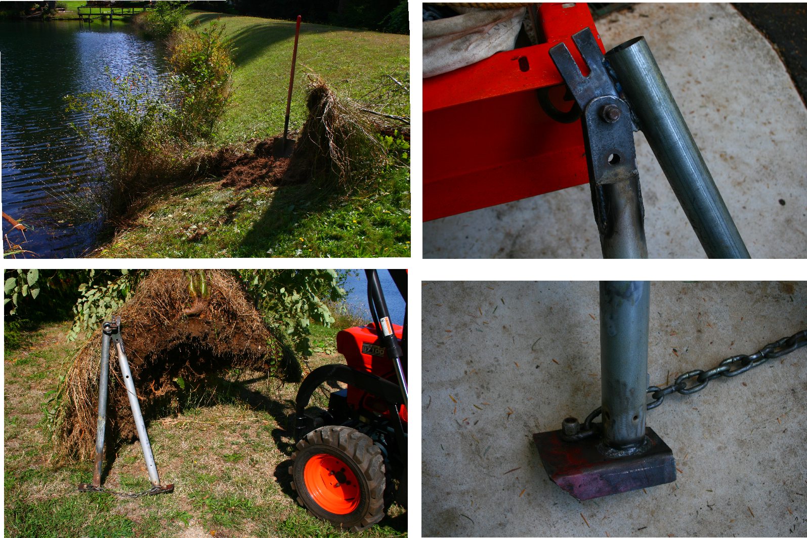

My location has a number of interesting terrain problems. One of these is a normally well maintained earthen dam which has had recurring alders coming back each year below the mowing line, and refusing to give up no matter how many times pruned to ground level. The last couple of years pruning was not done resulting in 3"-4" trunk size trees.
Also my front yard has a few very steep and very tractor unfriendly areas where some small "trash" trees need to be removed before they become larger trees (or if simply cut, sprouting a whole bunch more suckers, etc).
Since I am not about to risk my tractor (not to mention my backside) in either of these steep areas, it was worthwhile to cobble up this frame which is designed to stand up near the base of the small tree, wrap and hook a choker chain around the base of the tree, hook the chain into the slotted top of the frame, and continue on to the tractor's drawbar (located safely on top of the dam).
I had previously tried just a straight pull without the frame, resulting in little more than laying the tree over and digging some nasty wheel wells in the top of the dam.
With the frame, the tractor didn't even slow down :D

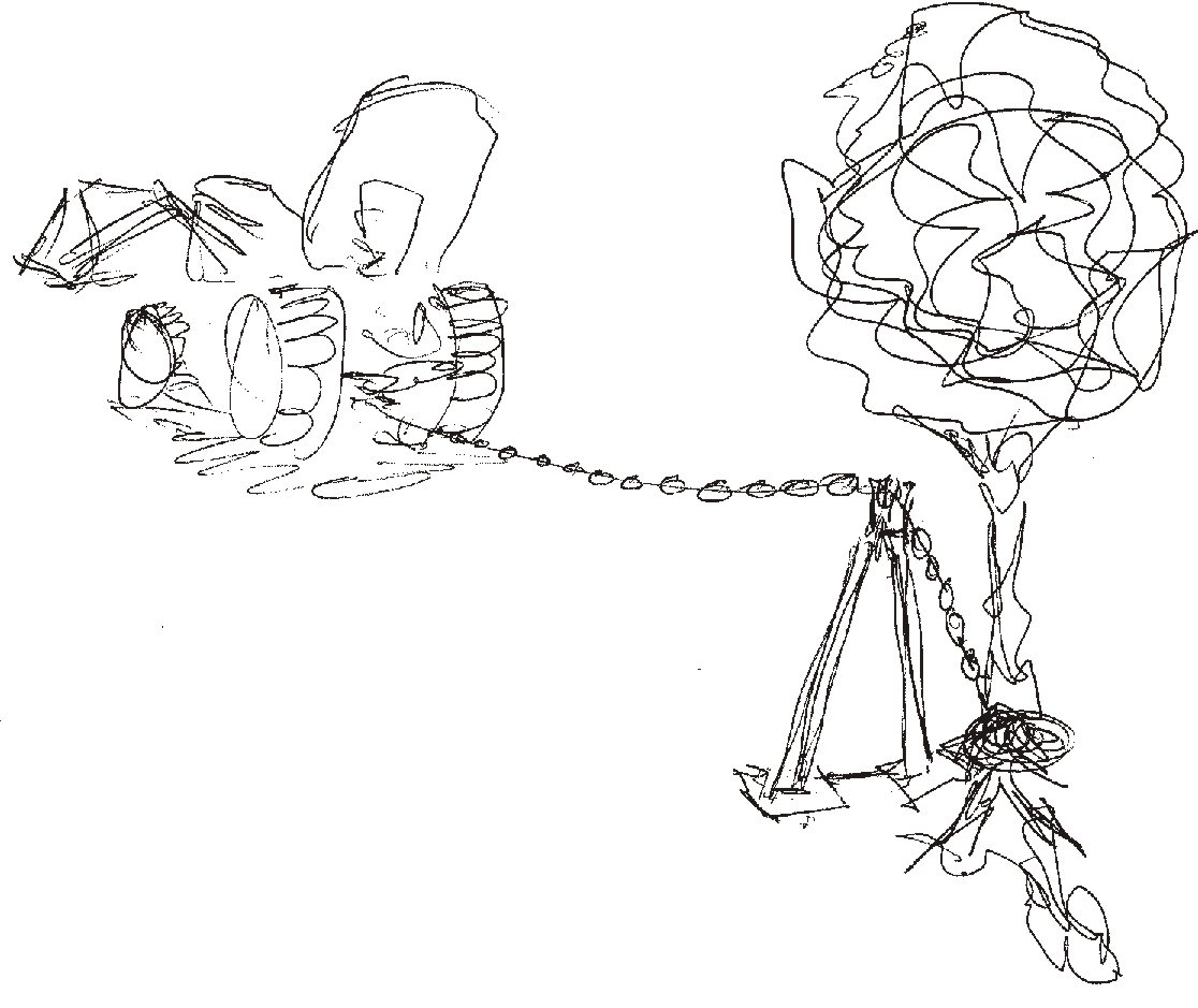

OOOHHHHH,,, Better pictures please, I am not figuring it out exactly (have the concept not the particulars)
One overall shot with it hooked and ready to pull would be great if you would be so kind.

Hard to get it all in one shot.
Besides, I already pulled all the trees at that location :D
The next place has so much other brush that I might get lost, much less take a clear picture. :eek:
So here's a sketch

Don't get me wrong here, the tire rim is a great suggestion, I have used the tire rim many times in the past, and it works pretty well most of the time. But sometimes in softer soil, one edge will sink more than the other, and the rim flops over on it's side. Suggest the widest rim you can find. As I said at the beginning, I have quite a bit of tractor unfriendly areas to take care of, so it was worth it to me to take the time to cobble up the most efficient scheme I could.
Note the size of the pads on the puller (4"x6"@) they typically sink in 2"-4". I was going to spread the puller's legs further apart, but that was the longest scrap bin chain on hand. So far so good, but possibly it may require wider stance someday.
