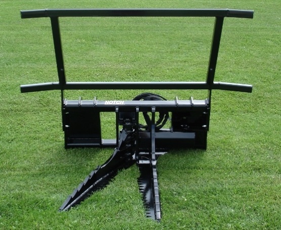

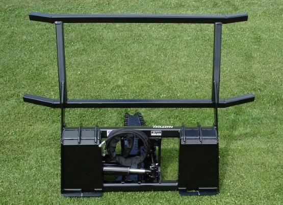

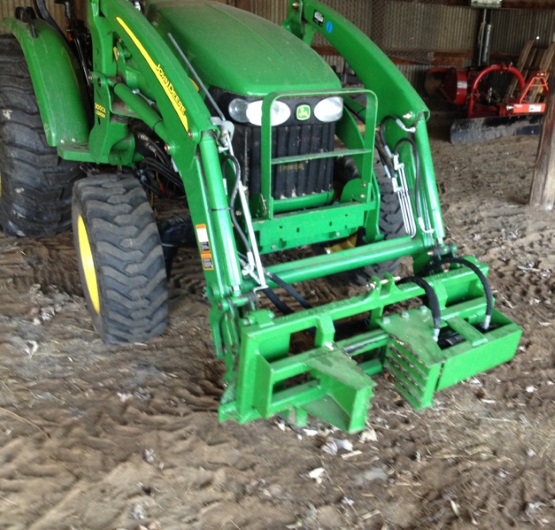

I don't favor the ones where the tree is not centered in the puller. The Notch unit is similar to the Danuser with the serrated front arms to use for light digging. I am going to ask Notch for specs. on the width, thickness and grade of steel used in the front arms. Can you post pics of the one you made?
Thanks
   / Tree / Post Puller Type & Manufacturer? #9
Will Notch make it fit the 3 point and the Loader?

I am going to ask them if they would do it and how much extra $. Would really be nice to have this (or any) puller work on either end. I have read your posts and noticed you have the "Buckthorn" extended puller. How do you like it thus far?
