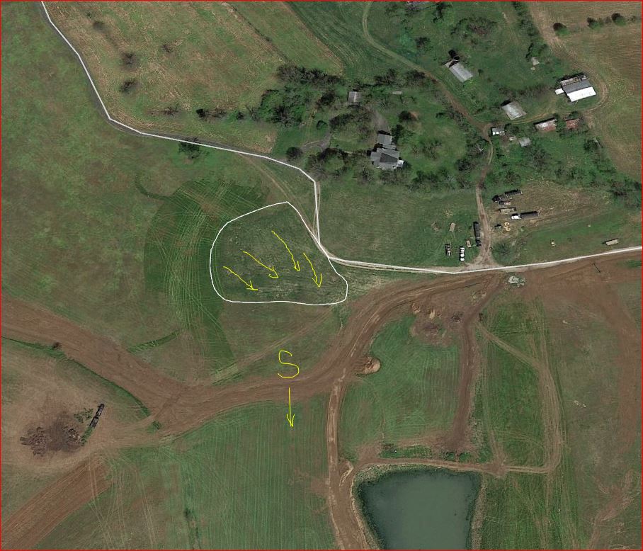

I have an area in which I want to specifically plant an 'orchard'. About 3/4ac on a small hillside. I don't know the pitch, and it is likely less than it appears. It can be driven in all directions, so isn't too steep. But, I'd like to terrace it and plant 'fruit/nut' type trees on it. The work of terracing it won't be hard, but I want to try to insure I design the whole spot well.
I know next to nothing about fruit trees, and don't want an inordinate amount of work/upkeep. But some isn't too bad.
Does anyone have an experience in terracing or a link/info on designing such a thing? Again, this is NOT very steep, but enough that row cropping it would be difficult. So, they just put it in grass and left it.
And... speaking of grass. What type of grass would you plant for UNDER the trees? There is nothing there now. I plowed and disced the hillside last fall/spring. So I can plant anything which makes sense and would be easiest to deal with and most beneficial overall, to a long term orchard. Both in upkeep and in orchard optimal ground cover.

This is a Sat image of the space for the proposed orchard. About 3/4ac with Southern exposure.
   / Tree planting sweetspot... and recommendations requested #40
Terracing requires dirt work. Dirt work exposes the soil to erosion. You'll have to slope the terraces away from the edge, back towards the hill, then provide drainage at the back side to remove the accumulated water.... VS just leaving a natural hillside with grasses that control erosion that's probably already in place.
As a kid, there were 4 houses on our block on top of an escarpment. My dad terraced his back away from the edge of the escarpement, and provided drainage at the back edge to move rainwater away through pipes, down the hill. The other 3 neighbors sloped their yards towards the downhill, to expose the view.
All three had major washout problems, but ours.
Anytime you change natural drainage, you really gotta plan out what to do with the water it'll catch in a large rain. ;)
