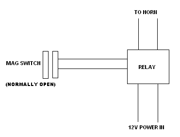

Is this the basic concept (don't laugh)?
I was looking at Wikipedia about relays. Is a single throw (normally open) relay what I want?
I also don't know how the connections at the relay work.

here is a JPG version of the picture.

I don't like the idea watching for a mark or watching a drag chain spacer. It distracts the planter from focusing on the tree planting. An audible sound does not interfere with the eye balls and gets a rythm going.
I don't want the...look...look...look...look...look...look...plant. I want...beep...plant............................beep...plant.
The adjustablity is nessesary depending on how early I want to harvest trees. I can live with some limited adjustability but 11 ft won't be the only spacing. I can live with 11' or 5.5' or 3.65' or 2.75' spacing (either 1, 2, 3 or 4 magnets on the rear tire rim).
I can fashion the mounting brackets, etc. to mount the required hardware. I don't mind to do some rig up as it is once per year for one day of planting.
I like the idea of using the tractors horn and a relay/magnetic switch to activate a beep. I think some rare-earth magnets stuck to the tire rim would be strong enough to activate the mag switch and stay put while driving. If that doesn't work I could always double side tape the other side of the magnetic contact switch on to the tire rim.
