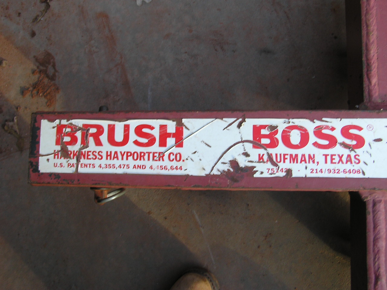

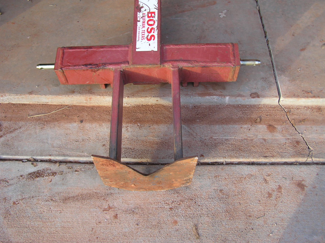

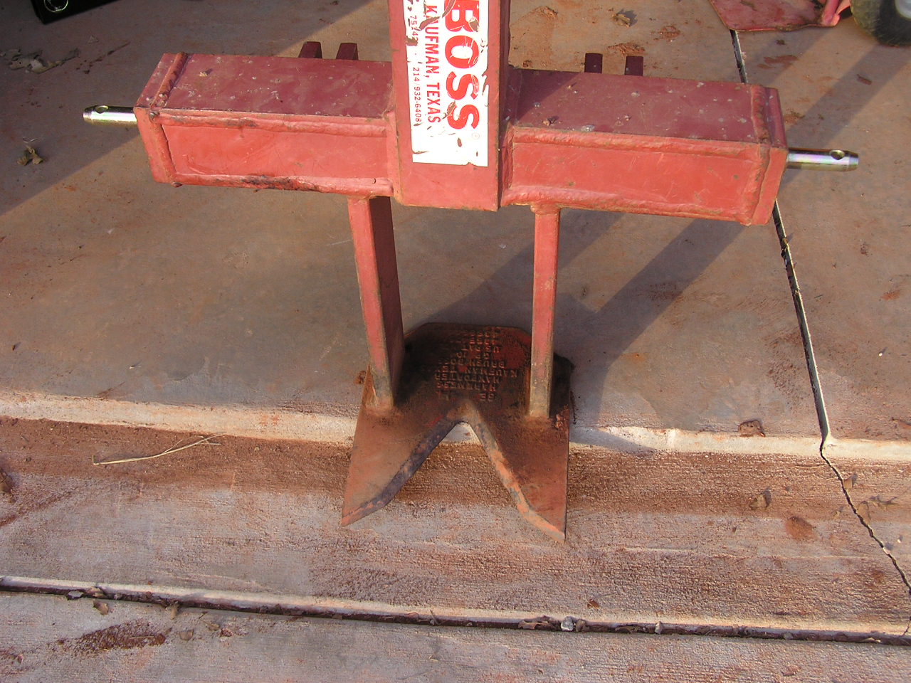

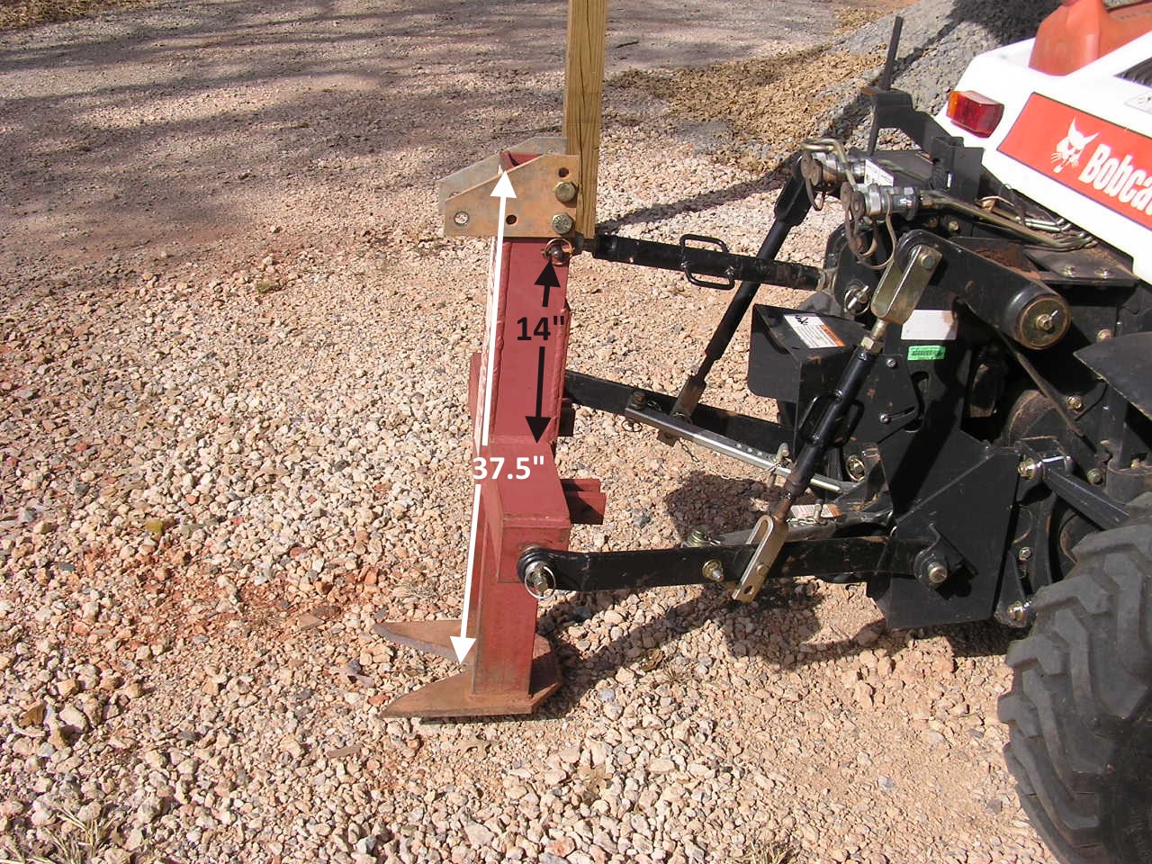

There was a commercial version that was similar, but it had a hydraulic toplink and a pivoting foot.
I bought a used one about twenty years ago, don't have pictures from back then, but since I keep everything, I still have it.
I added a plate at the top so it can be turned around, it would pull any cedar tree that the MF 240D that I had back then could drive over.

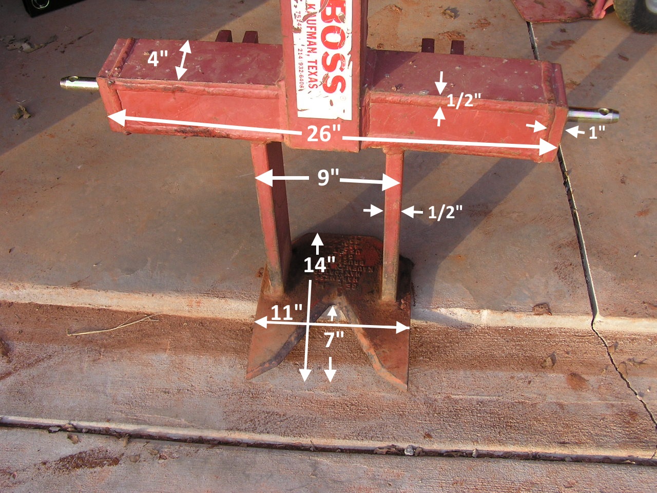

Did you ever have the toplink and foot? That company seems to be defunct, so I'm considering building one: any way I could talk you out of some basic dimensions? Length of the "leg", size of the grubbing plate, etc. I did find an old document regarding it, with a drawing of that foot and toplink, so I see just how that was supposed to work, but I would imagine that it will do most of what I need on its own as you've got.
/ tree grubber. #22

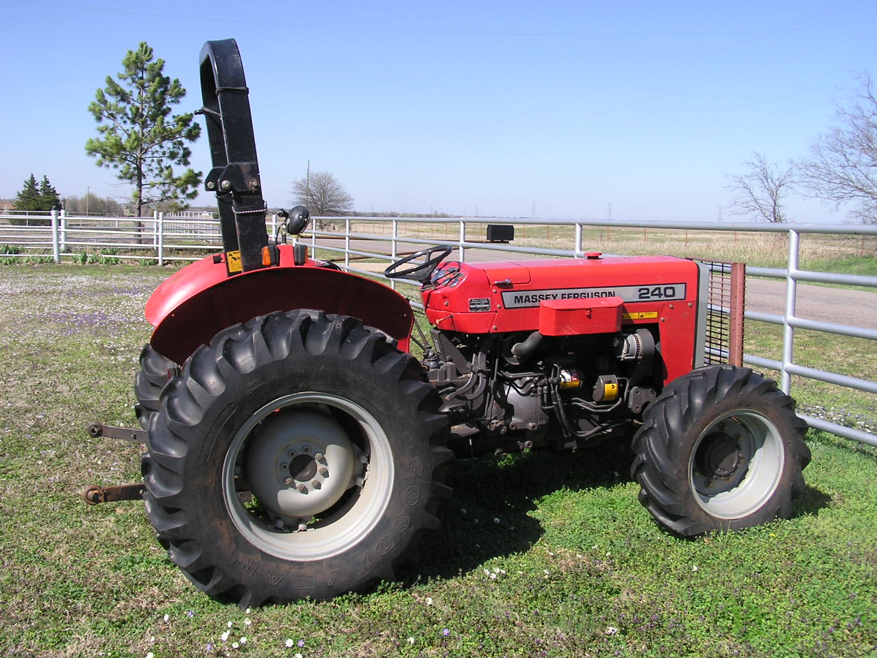

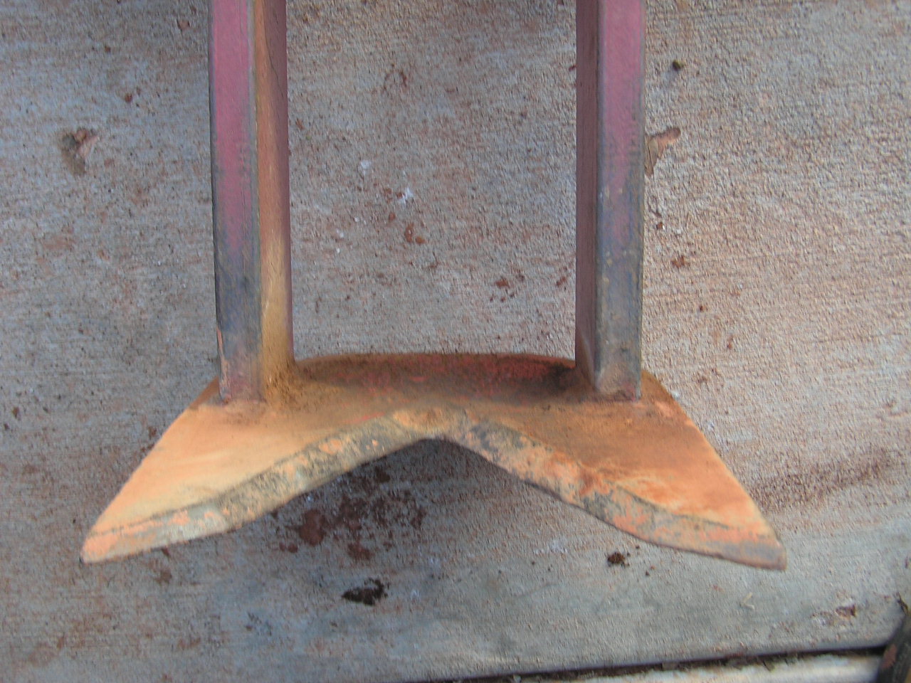

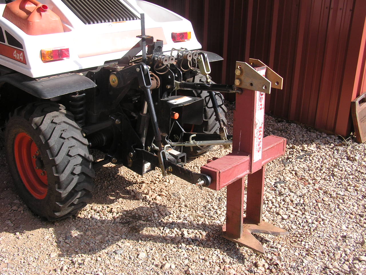

Yep, bought it at an auction, had the hydraulic top link and foot. My tractor, a MF240D was big enough that I could angle the blade and back up causing it to go under ground and hit the root ball, then just raise the 3 point to pull the cedar tree out. After about an hour my clutch leg would give out, so I put the bracket on top for the top link, so I could turn it around. Cedars are flexible, so I would drive over them, drop the 3 point as the tree went under the front axle and pulled them out, never stopping.
Let me know if you need other measurements. The blade is 1" thick.
/ tree grubber. #23
View attachment 408780 View attachment 408781 View attachment 408782 View attachment 408783
, Wow, when somebody asks you for measurements, they really get the bonus plan!! Thanks a lot!

How about some dimensions? This is just what I have been looking for. Send to jham501@gmail.com
/ tree grubber. #25
Jerrbob,
Look again. Dimensions are provided.

Sorry, sold the tractor six years ago. You will just have to use your imagination.
The Brush Boss
Now using it for a counter weight, but this is the way it was mounted for pulling cedar trees on the tractor's 3 point.
