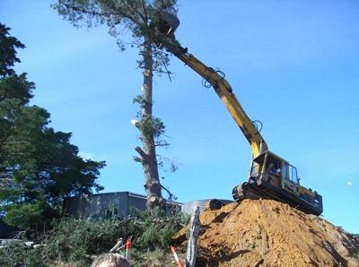

Clearing trees (especially something 10-20" dia & 50' or greater ) isn't for the faint hearted or inexperienced - combined that with using a compact excavator of limited reach & you'll be placing yourself a little too close to the "action" for my liking (an excavator in inexperienced hands is also easily damaged, usually on the boom or swing in clearing operations).
To give an idea of scale below is a photo of our 22T excavator preparing to remove a tree (comparable is size to your larger trees) - the higher the bucket is placed the greater the leverage the "push" will be placed about 1/2 way up this tree. Also with this tree being "springy", as high as possible the branches are in the process of being removed to prevent catapulting "spears" & to aid felling into the narrow slot we had as a drop zone without causing consequential damage to structures on the ground
With the bulk of your clearing which is smaller trees, as others have recommended a CTL would prove the better/quicker "tool" & is far easier to operate.

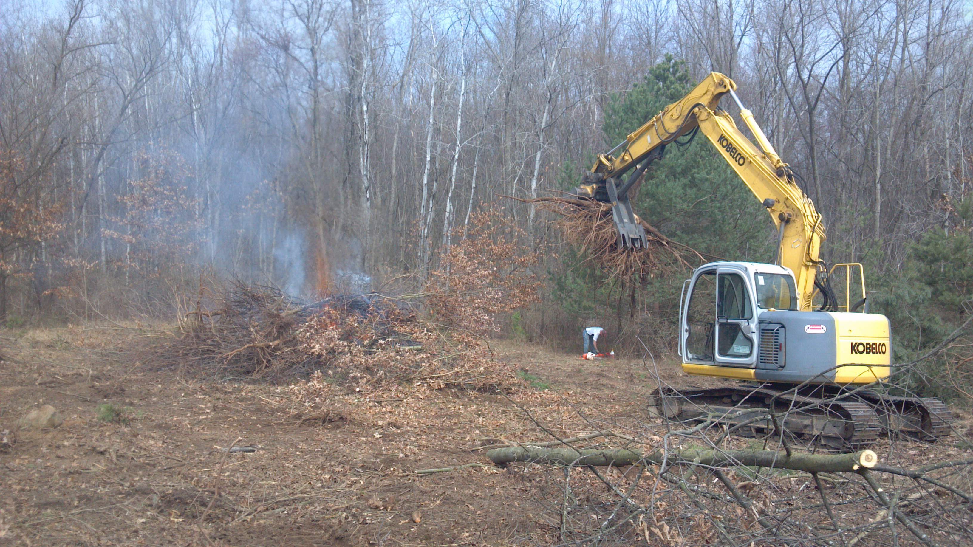

I think you would be pushing the 121's limits.....that's just me....I have a Mini-X that is slightly smaller than the 121, and I wouldn't touch that job with a mini....something with some reach and power is what you need. I would hit that with my Kobelco SR135 and it's hydraulic thumb...plenty of power and reach to grab, remove and stack with out spending most of your time tracking all over the site.

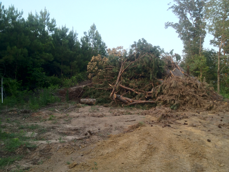

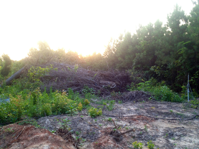

Down here 6 days rent makes for 2 full weeks of rent time. Clearing 6-10" trees with a 121 isn't a big deal. On the bigger trees, depending on the situation, I would cut them then dig out the stumps assuming this is stuff that you would enjoy.
While a 13T excavator would make this job a snap, you're not a contractor with time constraints.

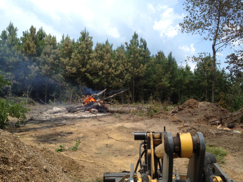

The biggest slow down will be consolidating the material into a burn pile. Assuming ground conditions allowed, I would dig the trees with ex and swing them into the right orientation, then consolidate/forward/pile with a loader of some description.
With the exception of the fresh pine, this was mainly cleared with a KX121 in 2-3 hours. The biggest we removed whole was maybe 14" dbh, 18" on the stump, give or take.
A day after I lit it.

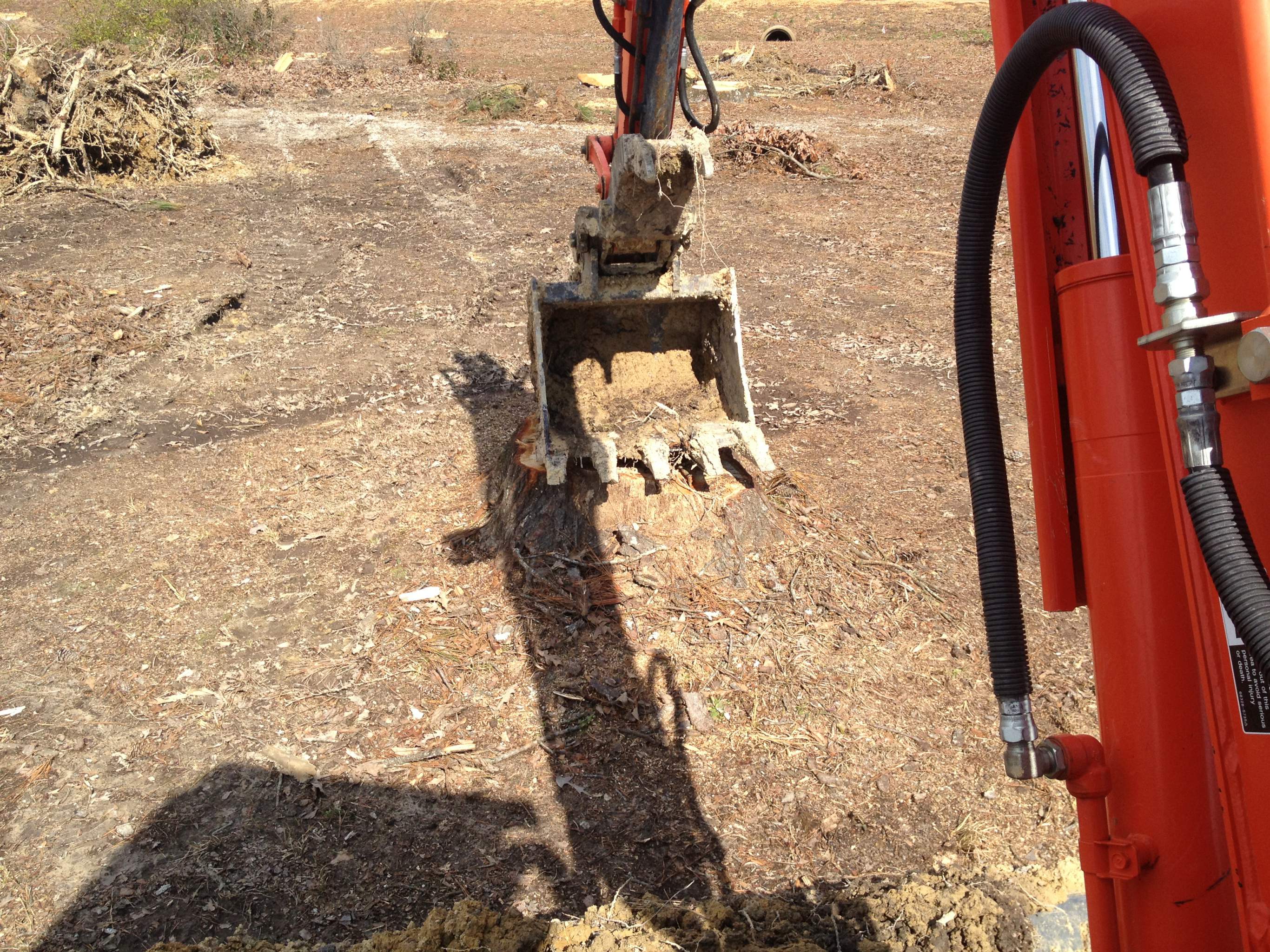

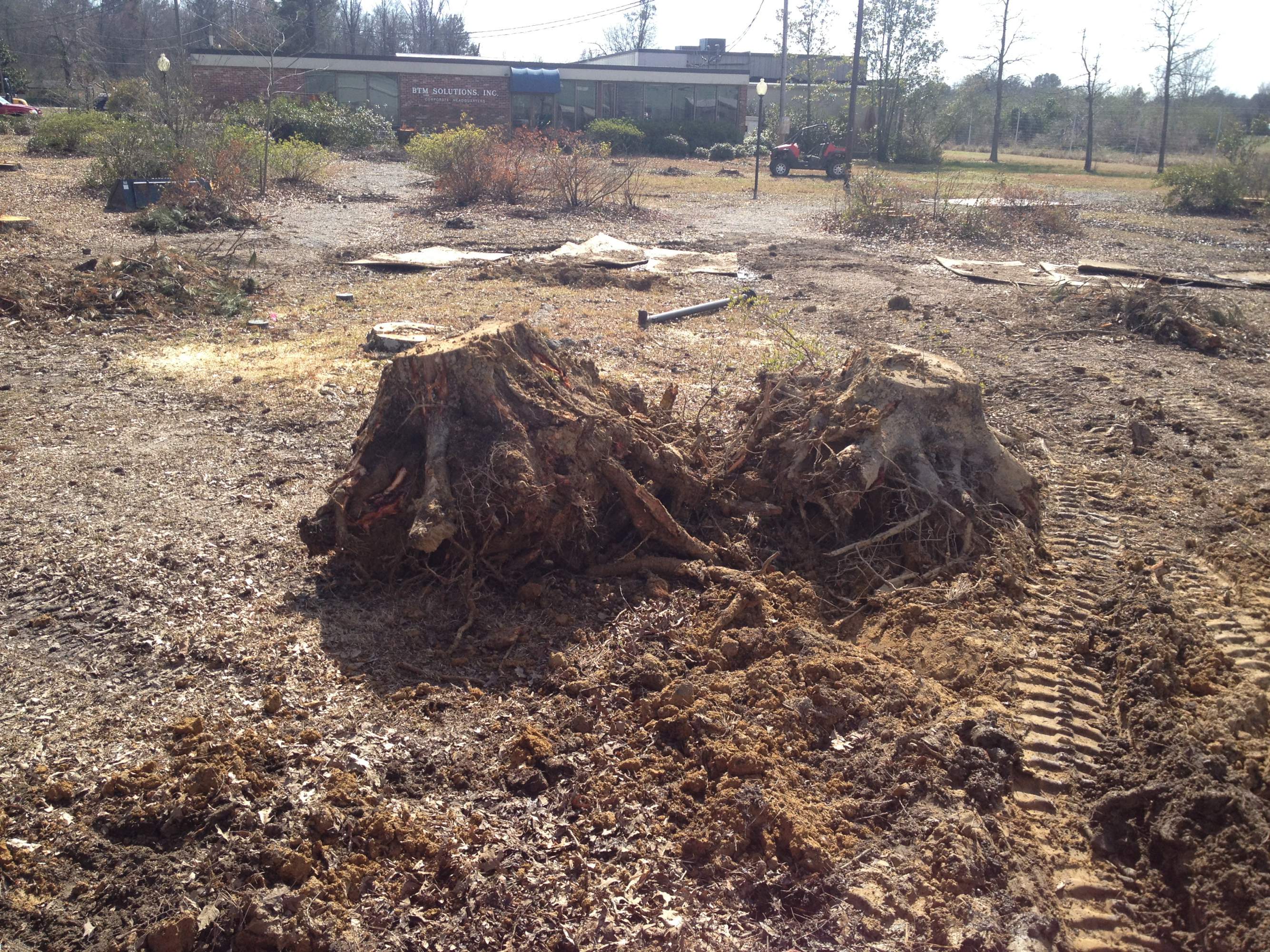

Cut the bigger trees and dig out the stumps if you don't feel comfortable pushing them over whole. I would suggest leaving the stumps taller than I did, however it still works.
That's a "24 inch" bucket in the picture; I haven't measured its outside dimension. Kubota 121-3.

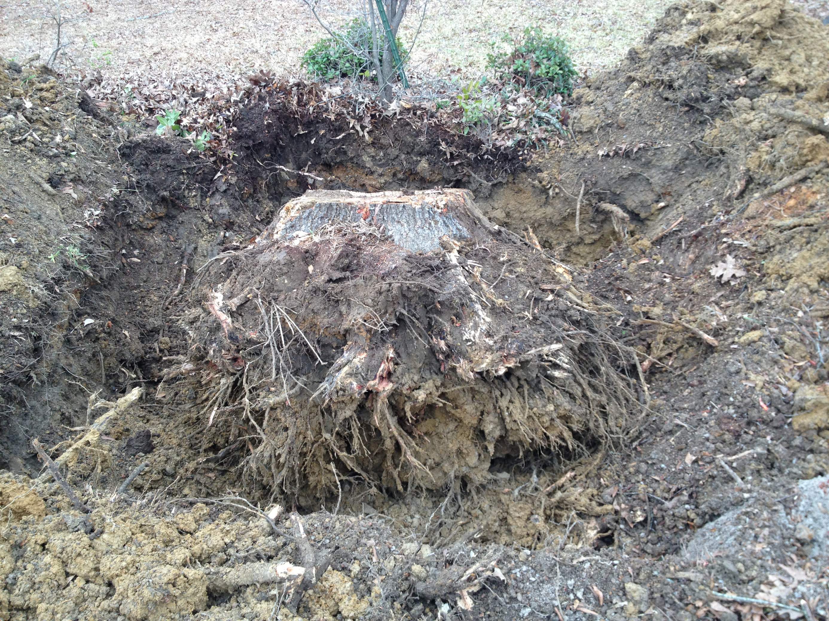

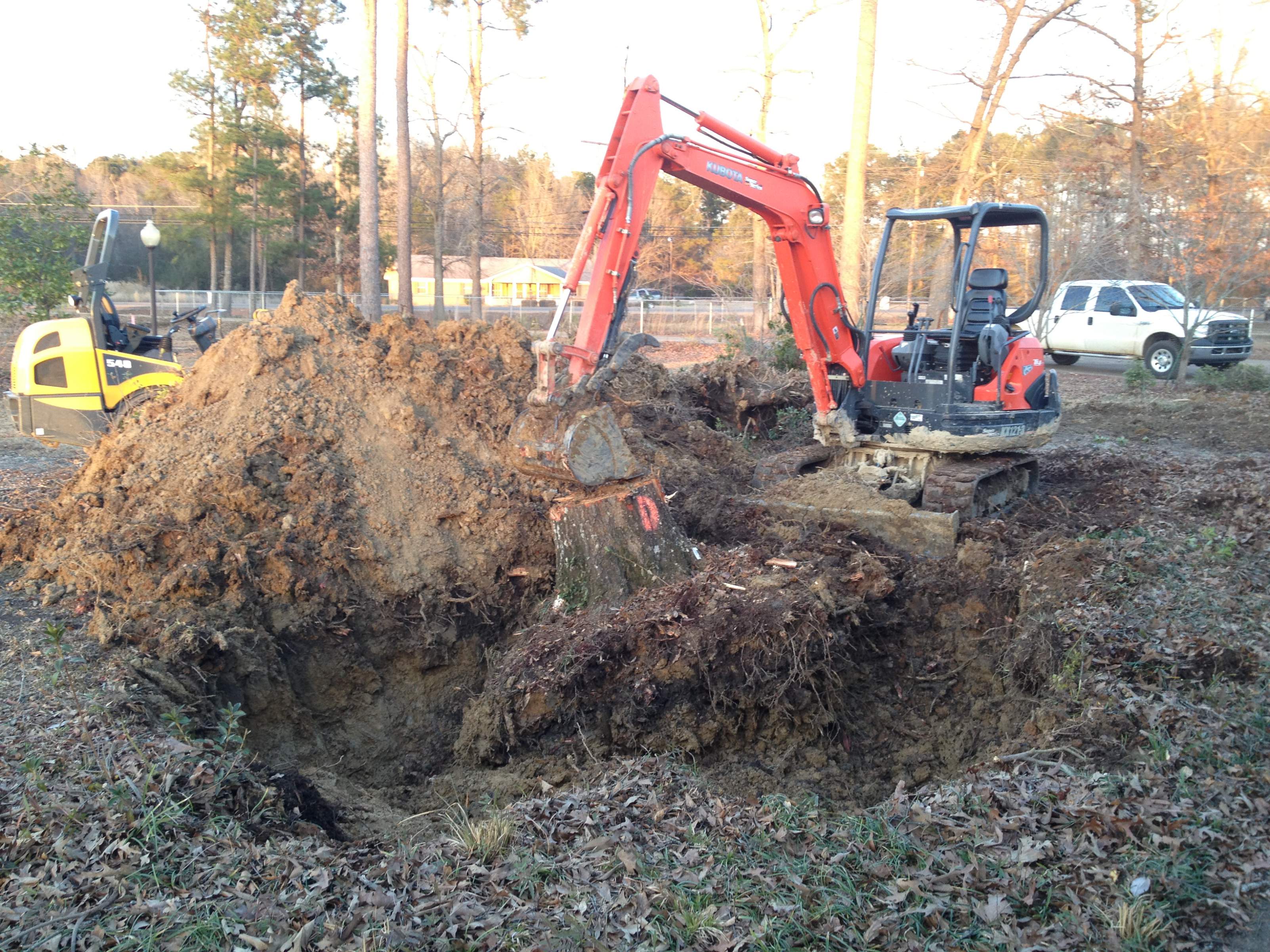

There's no reason a 121 couldn't clear a large tree, provided it's fairly neutral in weight/lean and you can install a high line/rope to pull with another piece of suitable equipment to pull it into the lay.
The 121 has no business pushing any "large" tree over by itself. Cut the tree then dig out the stump!

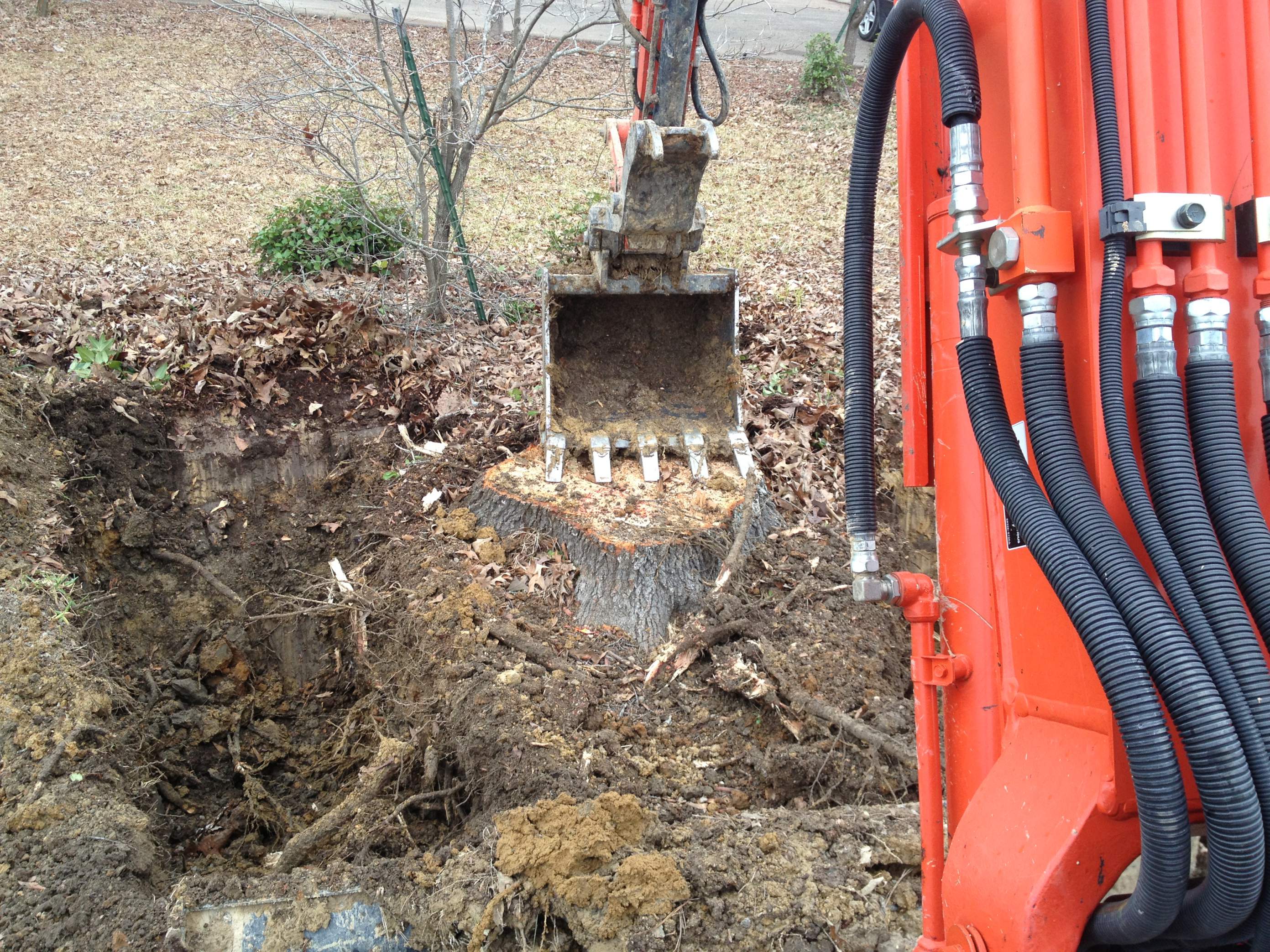

This is a 30" stump, 20 minutes between the pictures, another 10 minutes to roll the stump out and fill the hole back in.
This stump took a while longer, it's my biggest to date with a machine this small. Guessing it's near 40" if it was ALAPed. (Cut as low as practical).

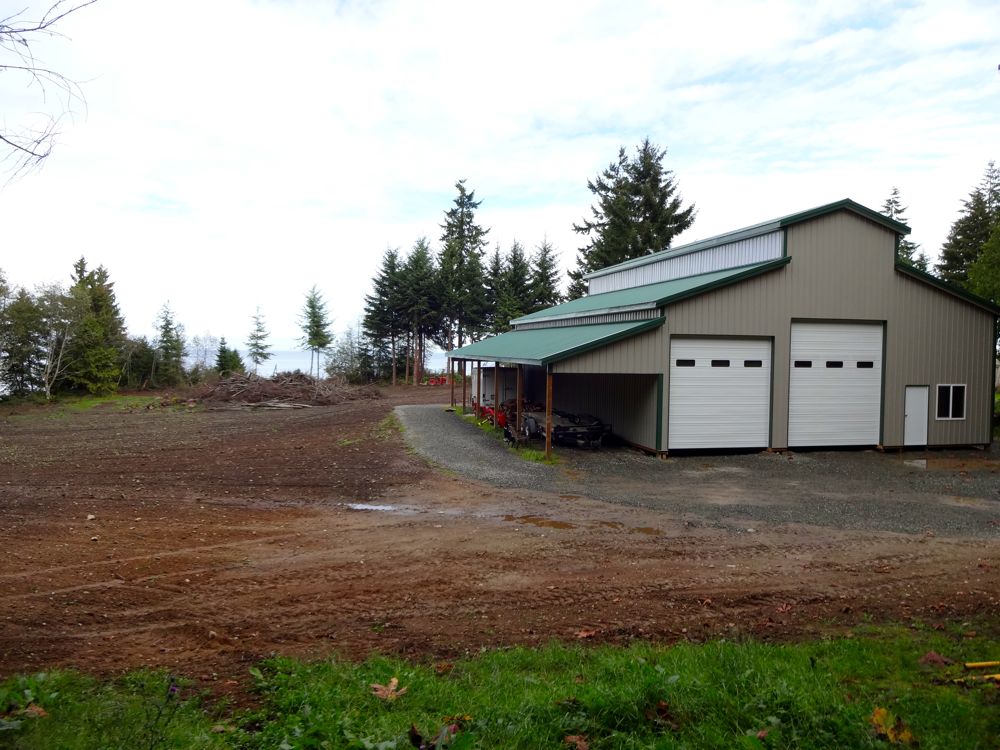

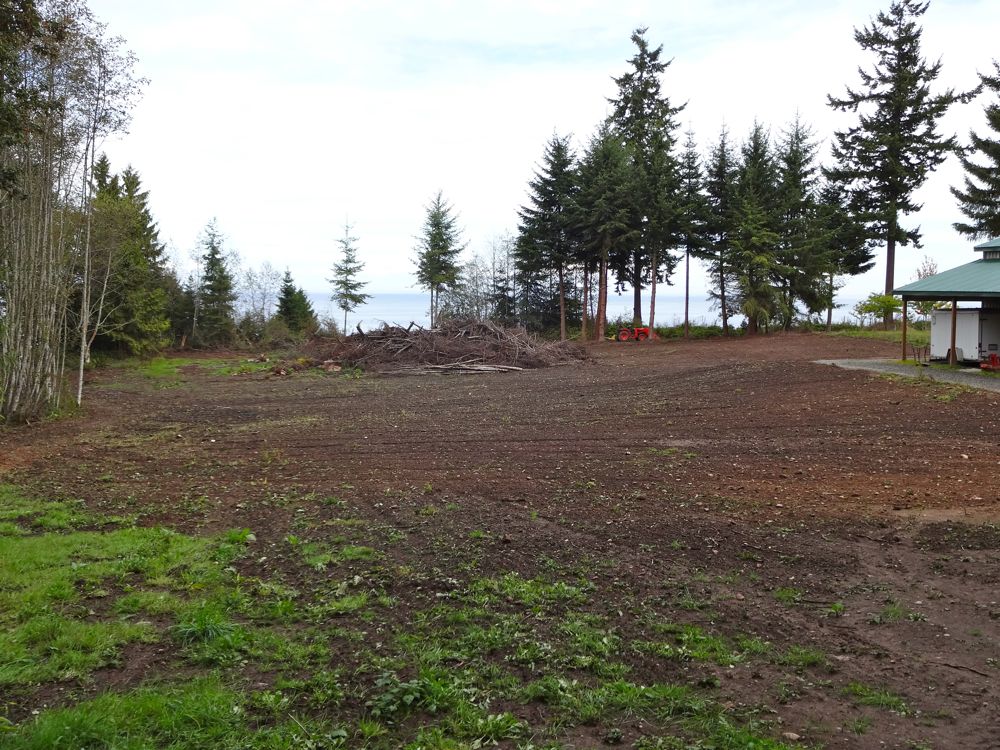

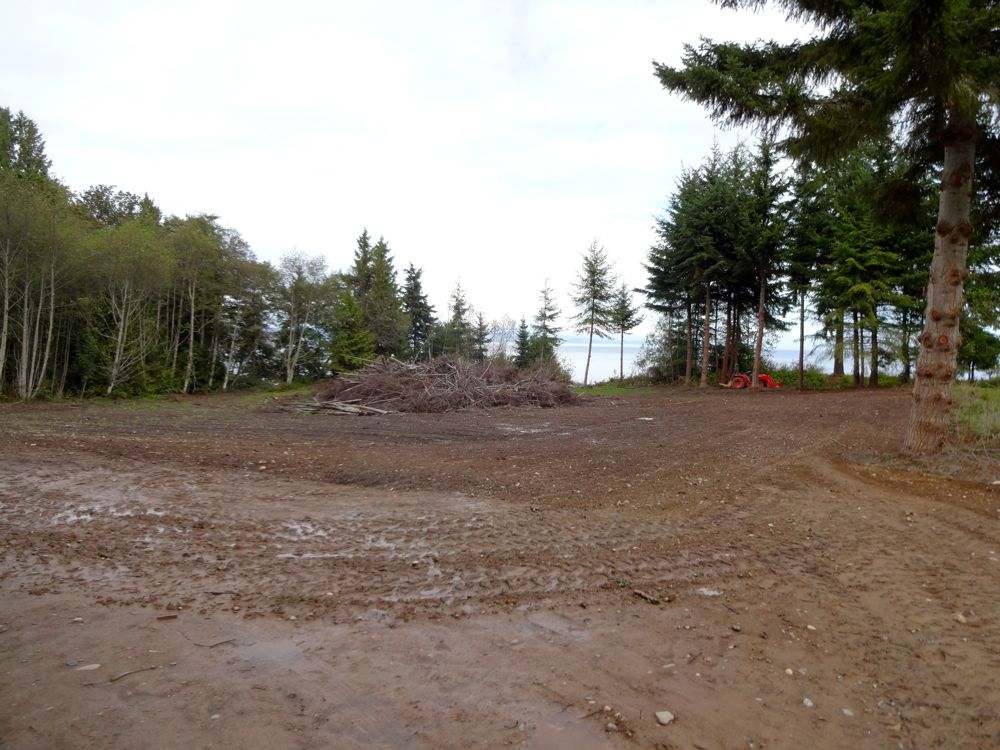

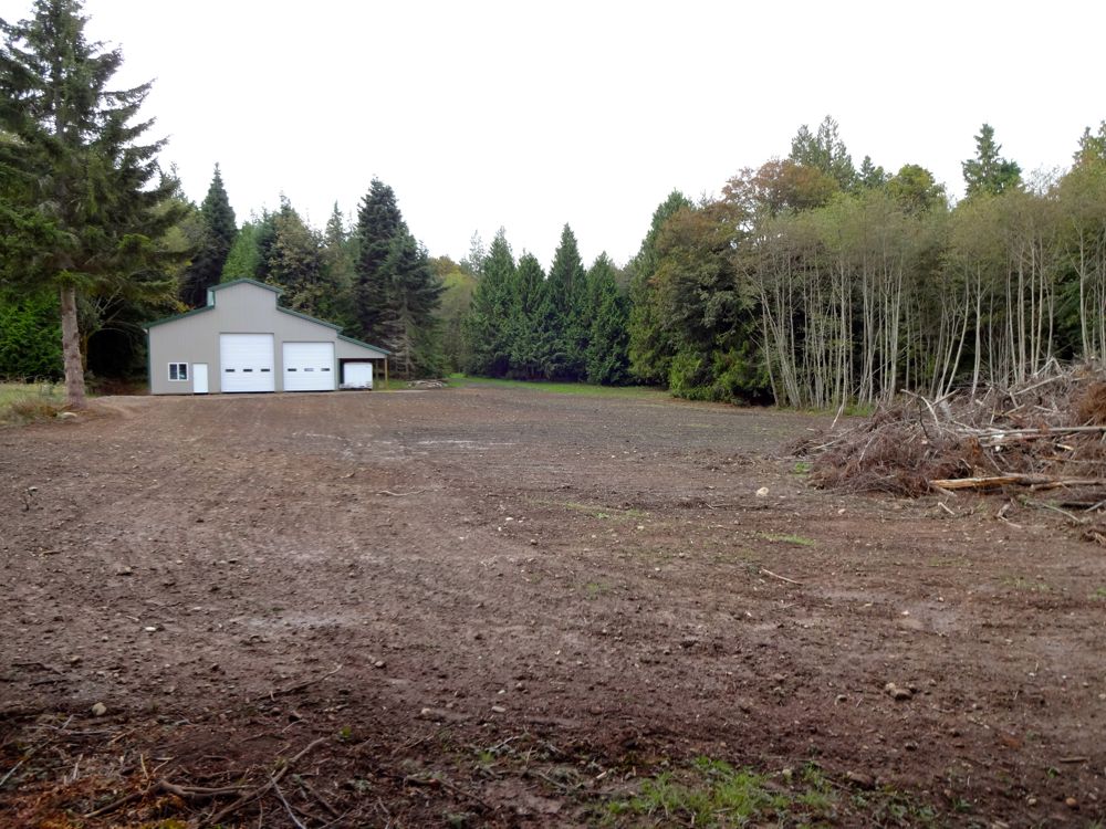

Don't you hate it when folks don't follow up with results? I''ll rectify my guilty behavior.
After going over many options and taking in opinions here and elsewhere, I decided to tackle it myself - mostly.
First up - I did it with even a smaller excavator. The rental place I had in mind didn't have KX-121's, I was mistaken - all they had was a KX-91. Based on no universal opinion regarding the 121's capabilities, this caused me some concern.
In chatting with my local excavator/dozer pro, he mentioned another outfit in town that rented Cat equipment. They don't advertise to the public very much - they primarily cater to contractors and the timber industry. Chatted with them, and ended up renting a 304E...still smaller than a 121, but I was assured it was up to the task in the right hands, and given enough time. I had the latter part covered...the former, not so much.
The first two days were brutal...but then, it started to click. I noticed I was no longer thinking about what control did what, and was just starting to move the sticks without thinking too much about it. Another day was spent practicing being smooth, then a couple more days honing technique. After two weeks, the trees were down - but doing it again today, I could probably knock them out in under a week.
As it turns out, the biggest problem wasn't knocking the trees down - it was moving and stacking them. The little Cat had no swing power, and the alder grove was thick - so there was a lot of dragging trees around to clear them from obstructions, instead of picking them up and simply swinging them to a stack. Also, another shortcoming that was quickly noticed - limited reach. Creating tall burn piles just ain't possible with these little guys, so I ended up with about 20 or so smaller piles instead of two or three.
With the trees down, I had to call in the pro to grade for the pole barn - quite a bit of dirt needed to be moved about, and I took heed of the advice to bring in somebody who knew what they were doing. While he was here doing that, he took a couple hours to consolidate my 20 piles into two, and we got one lit off before the burn ban kicked in.
While I definitely saved money doing it myself, my time is now free. Were I still working for a living, hiring it out would have been a no-brainer. And, I readily tell folks now that should the opportunity present itself, there are few things in life more enjoyable than running an excavator. The fun factor alone was worth it, and now that I've a little skill under my belt - renting it again for future chores will be far more productive.
Pics show the final result. A little different, eh? Last remaining pile gets burned soon, pasture grass seed going down after the ashes are spread. Then, everything sits as-is until we can afford to build.
Another update in a couple years. :D

Enjoyed following your updates...
Must be a great feeling of satisfaction know all that you have acomplished!
Don't wait so long to post next time!
