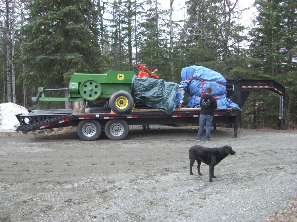

You do realize the PU attach. on a 346 is about a foot wider than a 336? Can a farmer haul over width farm equip.loads in AK without a permit?
No permit, no flashing lights, no wide load sign, no pilot car - if you're less than 10 feet wide - so, 9ft. 11in.; I'm good to go! Lot's of fishing boats on the roads up here with just a yellow "wide Load" sign on front and back with an amber warning light up to 12'.
AKfish

AK the only thing prettier than that load is the lab! Thanks for all the advice on towing but my luck, I called the guy to tell him I would buy the 570 nh baler but he just sold it,maybe a blessing in disguise. I bought a 336 today with a 30 kicker, baler has been kept in the garage and hasnt been used for three year, the guy bought a 348 and has been using that. The baler is extremely clean and cared for the owner owns a heavy equip co and religiously serviced it. I went over it and checked all the wear spot and its very tight. As far as towing its only 30 miles away and no highways or toll booths. I think I might be better off with the JD because there is a dealer only 20 min. away(parts) NH is about an hour. He gave me manual for the baler and one for the kicker, $3,000.00 If it ever stops raining we'll see how she goes. Ill try to post some pics of her tomorrow thanks again for all your input.
/ Transporting a baler
#26
Couldnt figure out how to do the pictures but I baled a little hay today 85 bales missed 1 bale kicker works great was hitting the back of 18 ft wagon very pleased with the baler
