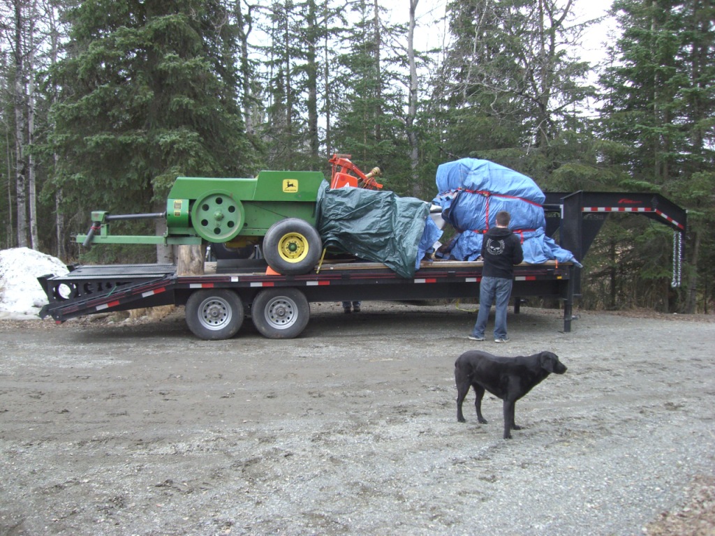

Oh, come on.... It's NOT that bad hauling a sq. baler on a trailer!! I hauled my JD336 baler from SD to the Oregon coast then north to Alaska. Fond memories along I-5, thru Portland :)eek:) and then Seattle :)mad:)...
I used a deck-over trailer that was 102" with rub-rails. The baler has those fat, over-sized tires that fit with about 2/3 of the tire surface on the deck and 1/3 hanging off the sides. Propped the tongue up on a Cottonwood stump and blocked the wheels with those hard, plastic wheel chocks (screwed them into the trailer deck). Couple of big, 'ol nylon tie down strap and that baler didn't move more than an inch or so after nearly 5,000 miles!
Worked just fine... :thumbsup:

This is what it looked like when I pulled into the yard - around the 10th of May or so.

I'd like to hear your comments after trying that load with a 346 baler instead of 336.

I'd betcha a couple of 4'x8'x1" pieces of plywood screwed to the trailer deck and extending out on the rub rails would make a pretty comfy spot for that 346 to ride! I might just have an opportunity to test that design...
eMailed a fellow up north of me about 550 miles (1-way) that's got a 346 for sale. It's been for sale for over 2 years... So, I'm a bit cautious - but, he's gonna send me pics.
I'll let you know! :biggrin:

You do realize the PU attach. on a 346 is about a foot wider than a 336? Can a farmer haul over width farm equip.loads in AK without a permit?
