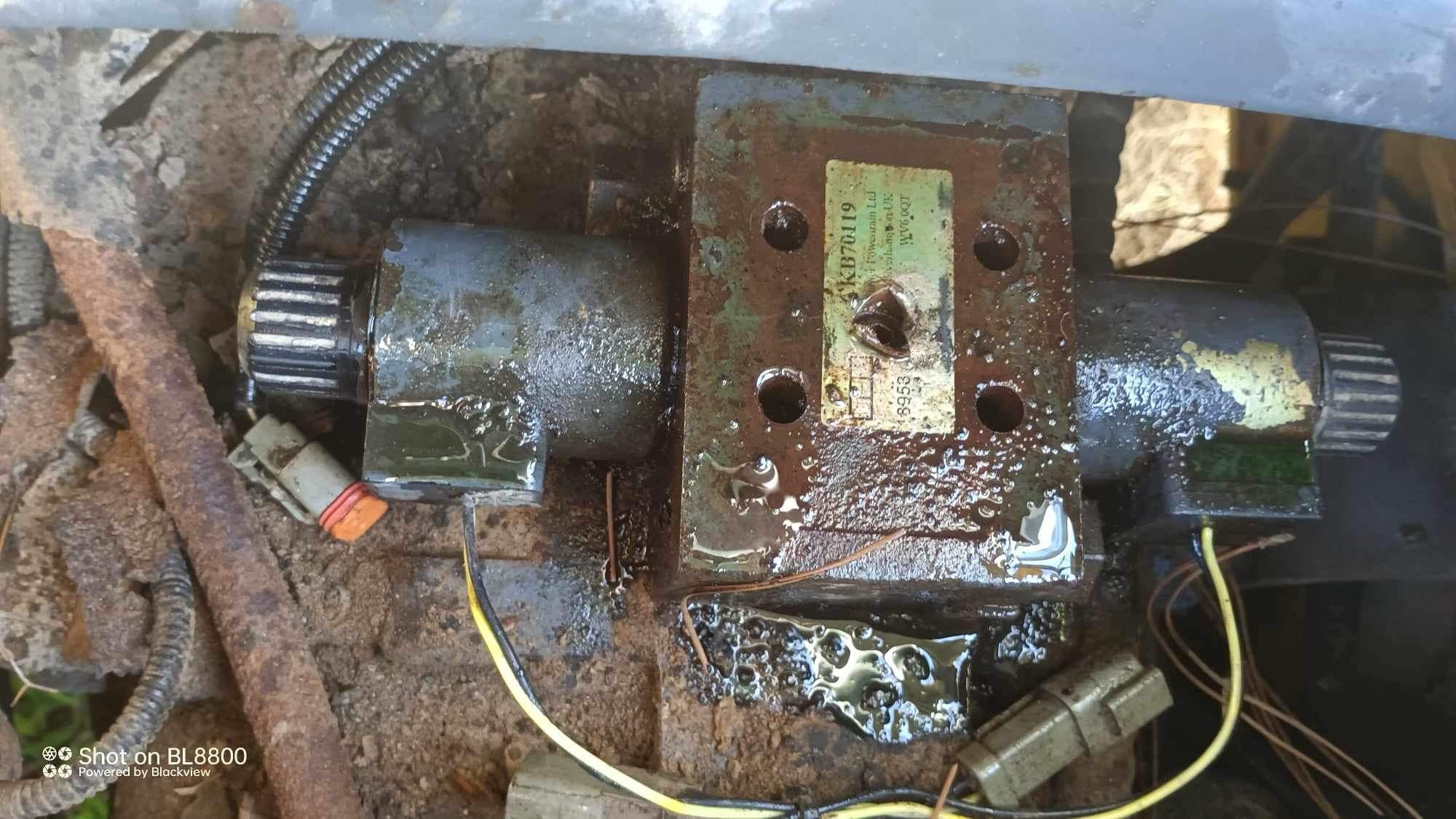

I agree with TT, sounds like an electrical issue. My 555D has a little "computer" that is basically just a shift control module. Shift solenoid not getting activated sounds like the problem you're having if you're getting no reaction anywhere. I would check the shuttle fuse, first thing. Then the cutout switch circuit.
   / Transmission Will Not Engage NH 555E Backhoe #25
Most of those shuttle valves have manual pin you can push with pick to see if you have electric or oil problem manually pushes valve across to engage trans just because you have power does not mean spool is moving also have had a few of them stuck over the years
   / Transmission Will Not Engage NH 555E Backhoe #26
Same issue right now. I believe the shuttle valve to be stuck.I unhooked the wires and checked voltage. Each connector had 12volts in one direction and zero in the other so that appears good. Trying to figure out how to remove and free up. The 4 holes in the top look to be mounting bolts but no hex or no torx, so I’m not sure how to remove to fix…..will find out in the next few days.

   / Transmission Will Not Engage NH 555E Backhoe #27
Those are actually socket head bolts requiring metric Allen wrench
   / Transmission Will Not Engage NH 555E Backhoe #28
Nope…I assumed they were socket heads also..I cleaned them out yesterday…no luck. The center hole, which was covered by the foil sticker has a hex socket on it. But it is canted to a 25 degree angle so the Allen wrenches I had with me couldn’t reach….they have a hex type nut on each side approximately 22mm that I plan on pulling just to see. But they look more like spool caps. If I can google a pic of the part, that should help. We‘ll see.
   / Transmission Will Not Engage NH 555E Backhoe #29
Hmm, well that is what the parts book shows. I agree that it looks like the spool is stuck or the coils are both bad which is unlikely.
   / Transmission Will Not Engage NH 555E Backhoe #30

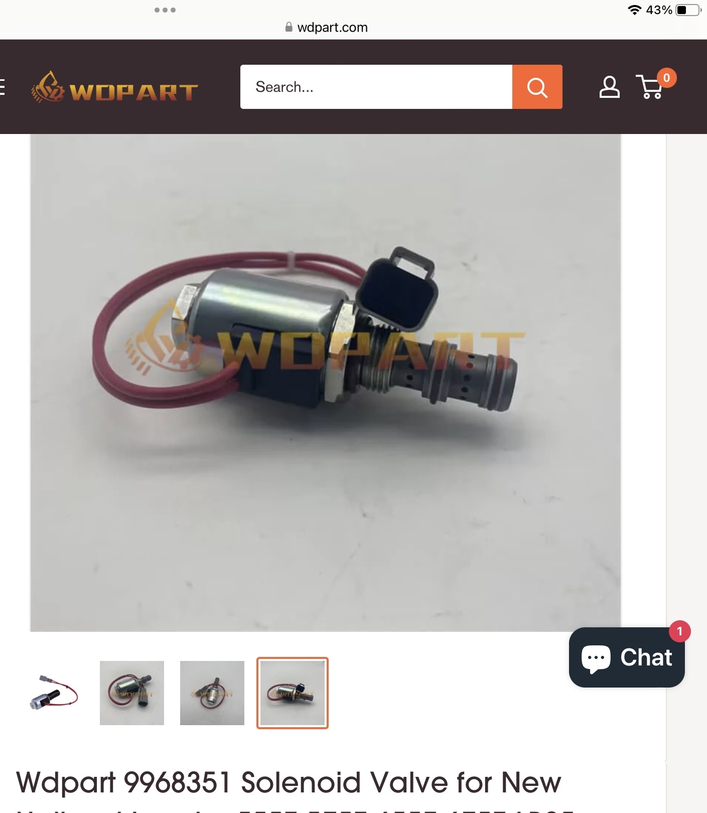

If you can see a part’s diagram or mockup……I was wondering if it was possible if it was attached from inside the case? Also was wondering if I could unscrew the solenoids? I have a service manual, but only have the electrical chapter with me.
