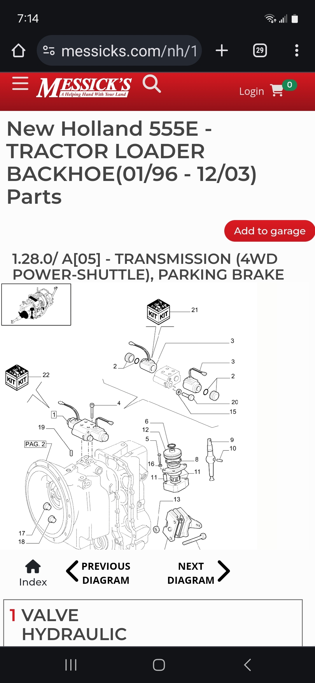

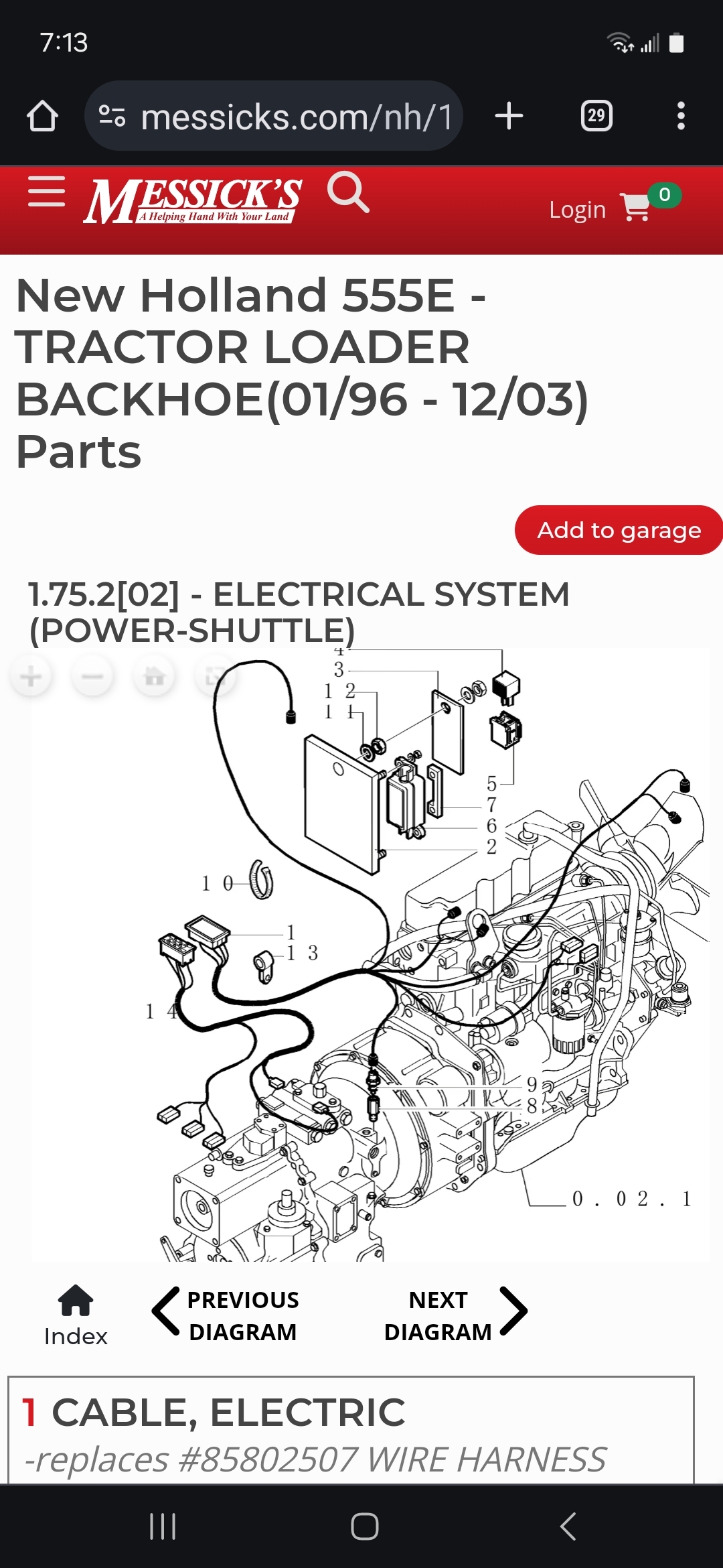

Here are the transmission harness and F/R solenoids
   / Transmission Will Not Engage NH 555E Backhoe #18
I saw those diagrams, but didn't realize they where computers.
   / Transmission Will Not Engage NH 555E Backhoe #19
I misspoke, this transmission is not computer controlled, but is completely electrically controlled. Fuse F4/A would be a place to start
