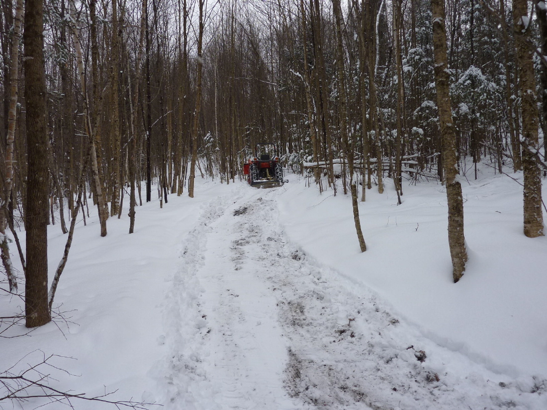

It is a world of trade offs. But maybe I have the wrong impression. I wonder if I could do what I like to do best without a hand throttle to set the RPMs, a free right foot to operate the differential lock and steering brakes, and a free left foot to stomp on the clutch in a hurry if things start going wrong. If I need to use a clutch for loader work thats fine with me it seems like a small price.
