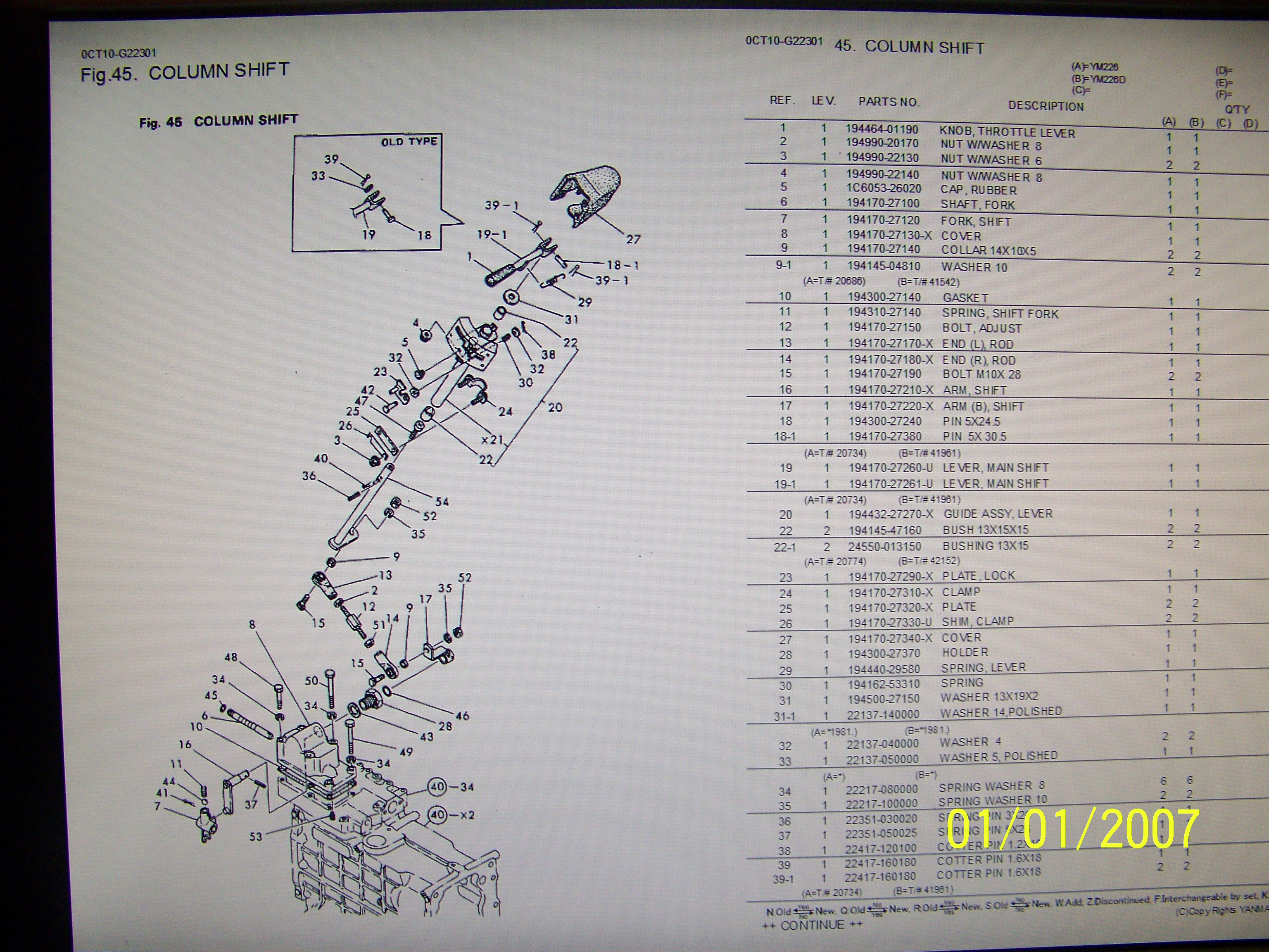

Is this what you are calling hydro clutch arm?

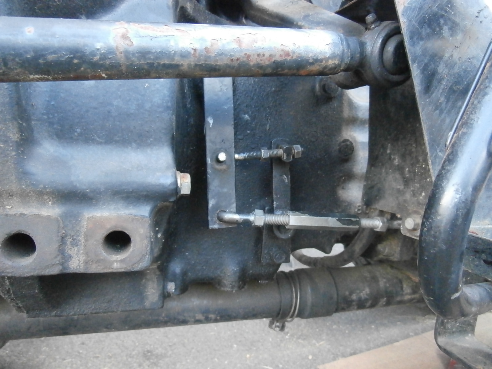

no this is what i was talking about.. large is throw out bearing...
the small turns with no resistance

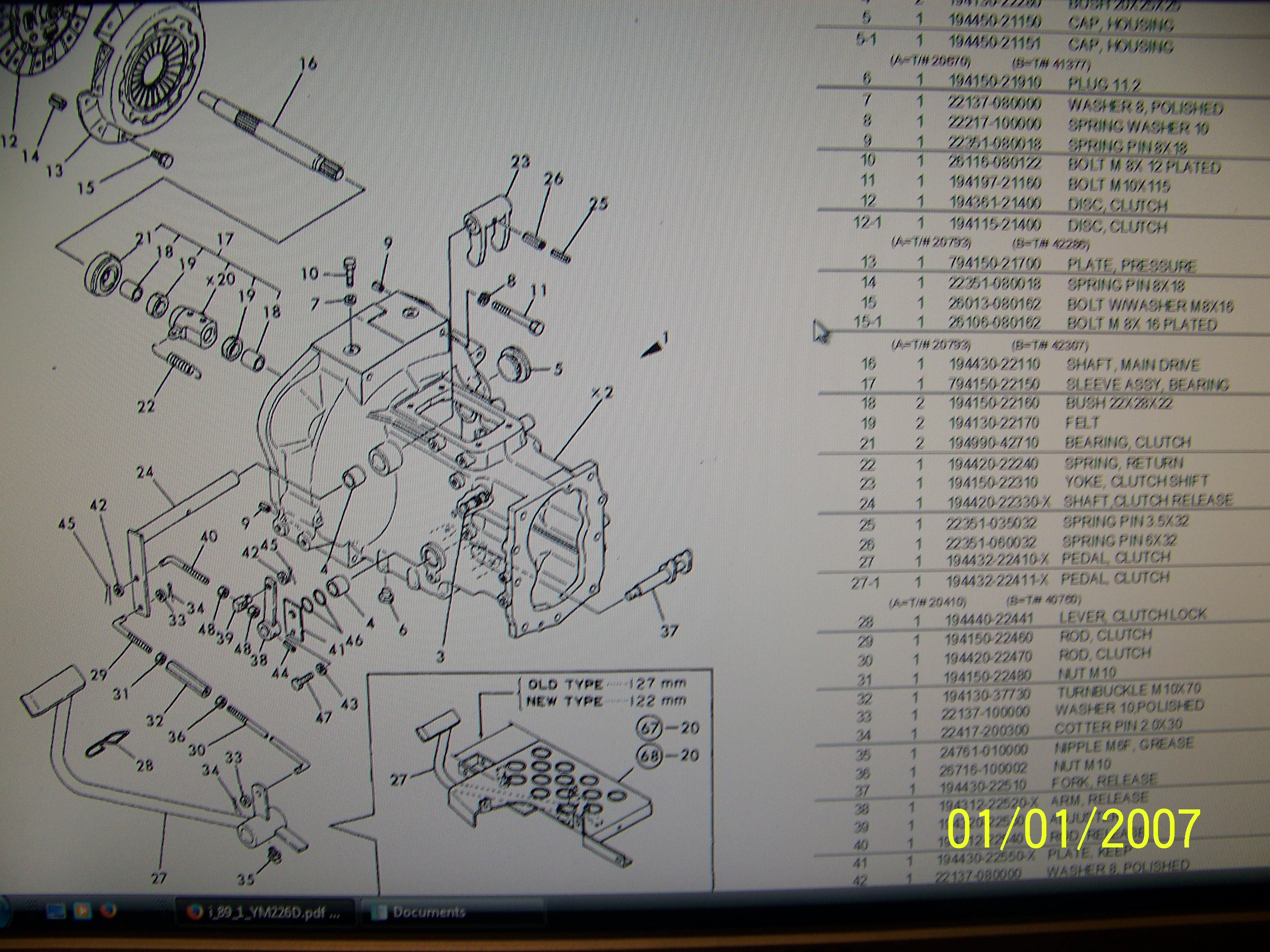

Called the inertia brake. Adjustment procedure out of 226 manual.

#13
thanks
but the problem is "push till resistance is felt" i have no resistance
what exactly does it do?
/ transmission problems #14
It pushes against the inertia brake which is located on the end of the power shift clutch shaft. Reference D on this drawing. That protrudes into the clutch housing.
Reference #37 is the release fork connected to clutch pedal.
